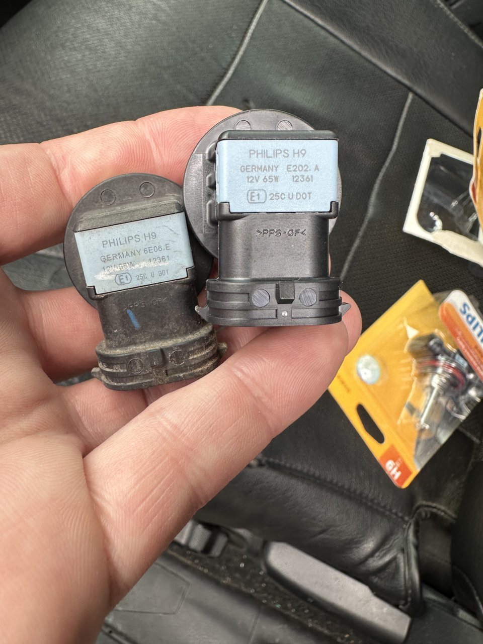

    After 8 months in my taco I wanted to upgrade bulbs but knew led’s weren’t the way to go after chasing my tail in my NC Miata. It also came with halogen projectors. In fact I’m pretty sure it’s the same setup as the Tacoma - H11 lows and H9 highs.
    Since I chased my tail so much in that car I happened to have a set of Germany philips h9 in my tool box that I was able to swap in. Haven’t driven yet but from what I could tell at dusk they’re definitely much brighter than the stock osram h11’s.

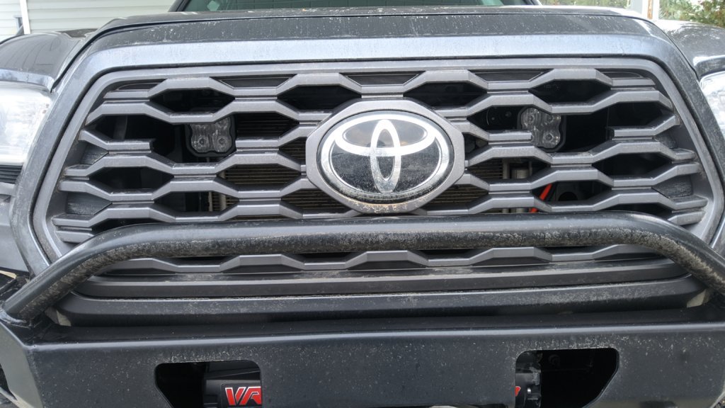

    You can go auxiliary headlights like I have. Diode Dymamic SSc3 Pro 4K driving lens wired into my high beams

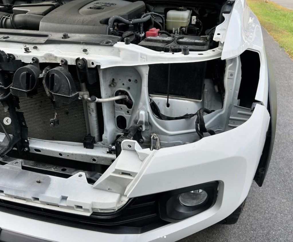

    Finally took the plunge and upgraded my '21 Tacoma's halogen headlamps for the OEM LEDs. A MASSIVE difference. The amount of light these things throw is CRAZY. This was the one option I was missing back when I got my truck during Covid (the truck was 100% everything else I wanted).
    Ordered from Sparks Toyota with a discount code from Chloe Kuo. Her video and the one linked below were hugely helpful and made the installation go very smoothly with the plug-and-play wiring harness from daveeasa's FBC Harness Solutions.
    Both the harness and the lights were shipped quickly and in 100% perfect condition.
    It was a little nerve-wracking pulling the bumper apart but it all worked out fine in the end. That was by far the hardest part, everything else came apart and went back together very easily.
    The first side took me a little over an hour, the second side about half that. And that includes time being interrupted by my neighbors wondering what the heck I was doing. :D
