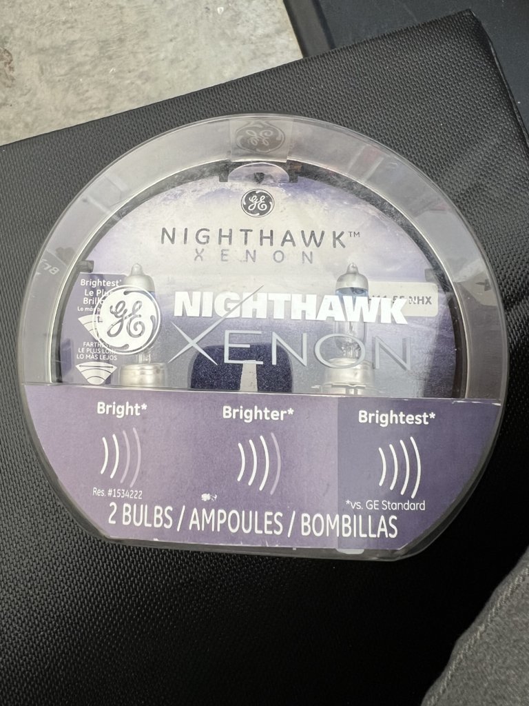

    Hey, @crashnburn80. Do you remember these? If I remember correctly, you suggested they should be placed in the factory fog. I apparently bought two sets but forgot. Just found them cleaning out my garage.

    They were the best performing H11s prior to the Tungsram Platinums and later the Osram 220s. Excellent choice for the Tacoma H11 12-15 and 16-19 TRD fogs.
