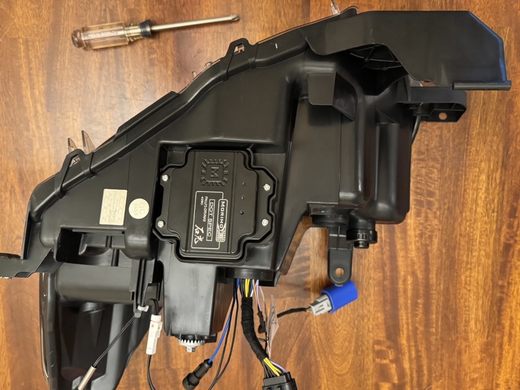

    I put the Hikari LED’s in my ‘21 about 4 years ago for $75ish and frankly was fairly happy with them. However, my one low beam just crapped out and is on at about 5% brightness. Searched for another pair of them and they seem nonexistent now.
    Scanned this thread as a refresher and saw the 2Stroke 3.0 was a decent choice but saw the new 4.0 and ordered them. Of course after brewing a cup of coffee and diving into this thread in even more detail, I find the helpful write up that the 4.0 performance isn’t as good with our housings and the crazy resonating noise.
    Then I saw Yoshi’s mention of the XB EVO and figured it can’t hurt to read up on those. The video on their site about the headlights is very well done and impressed me enough to stop crapping around and swallow the price.
    Looking forward to installing them. Also given the price I think I’ll have my detail guy put a PPF layer over them to help any rogue branch scrapes or smacks.
    Curious to see crash’s official test on these but I’m pretty confident it won’t be disappointing.

    No. The supercharged drivers completely replace the standard DOT Spec drivers. It is one or the other to power the headlights. You can see the DOT Spec driver installed on the bottom of the assembly below. If you want to swap drivers to the off-road driver, you need to do so before install.

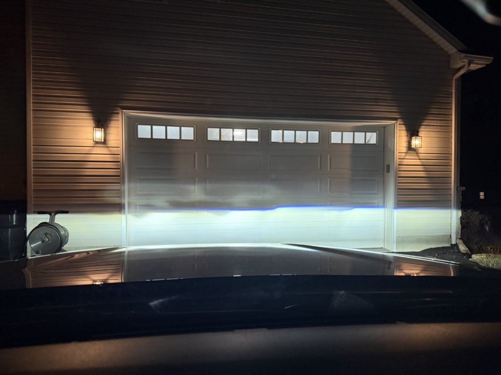

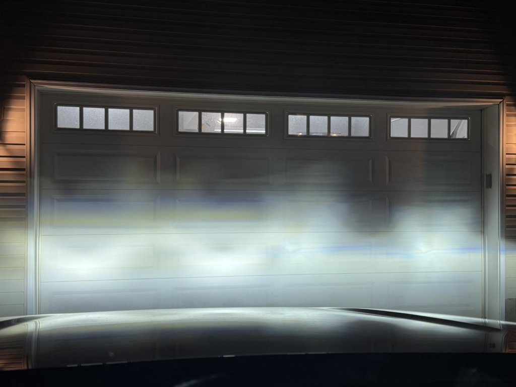

    Not the scientific data take you’ll get from Crash, but a real world view of thr Morimoto XB EVO .
    This is my truck on the left side parked adjacent to a 4th gen with the factory LEDs. I realize these are different than the OEM LEDs in the 3rd gen but still wanted to see what it looked like compared directly next to it for light pattern, color and simply the height of the lights.
    FYI my truck is lifted 2” but with the light cutoff height matching my friend’s nonlifted truck, I think it’s fine leaving them aimed as-is (side fact, the 4th gen headlights are almost 2” higher than 3rd gen stock for stock)
    One pic of low beams, one pic of high beams.
    initial impression is very impressed with them
    crashnburn80[OP] likes this.

    What are the 2 halos above the light on the left (1st pic)?
  9. Mar 27, 2025 at 7:14 AM
    #6749
    ezatnova
    ezatnova Artax
    Nov 15, 2010
    #46186
    404
    West Chester, PA
    21 DC TRD OR - Voodoo
    Wildpeak 265/75/16, Headstrong Progressive AAL, 5100's w Emu 885s
    Not sure but I think they are from my XB EVOs. Couldn’t notice it at all on the road

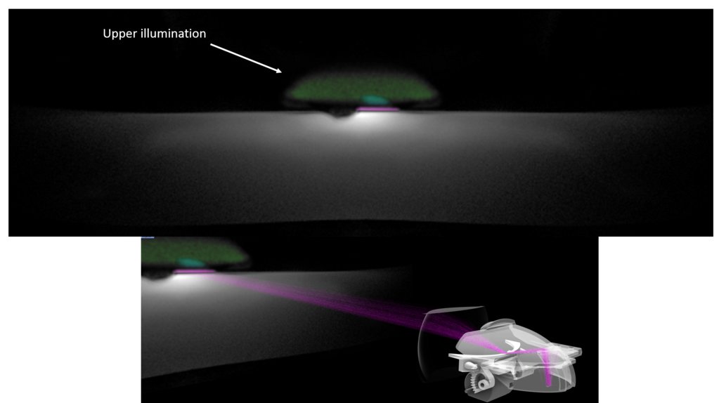

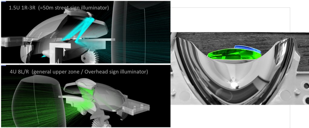

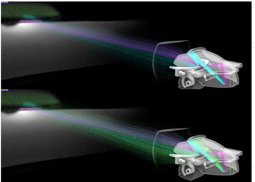

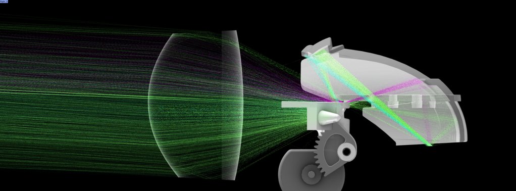

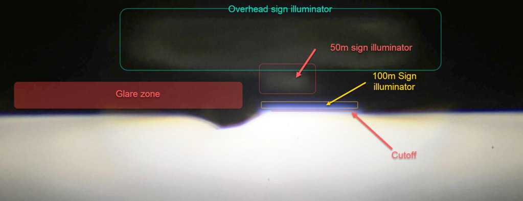

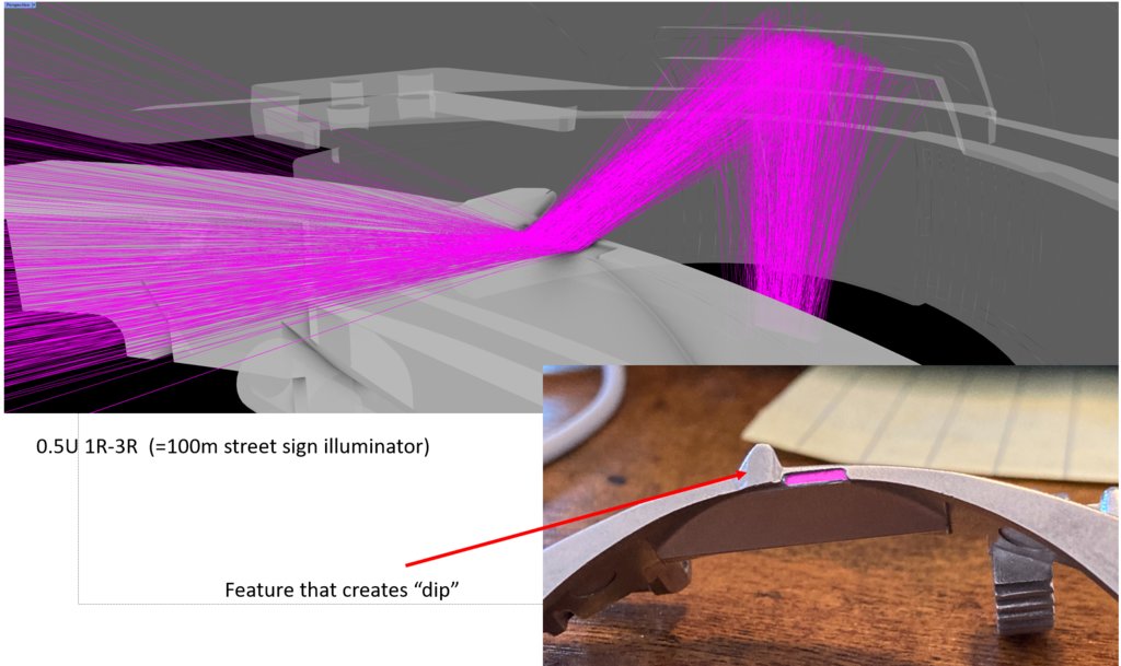

    It's required upper illumination. I set the upper illumination at upper end of the allowance for strong upper illumination visibility comfort. Read below Post #168
    https://www.tacomaworld.com/threads...adlights-are-here.848777/page-9#post-30382841
    Once you review presentation, then you may have this questions.
    Why some OE optics can get away without this pronounced dip? answer is simply due to OE optics are much lower intensity.
    For example, OE LED reflector does NOT have as pronounced dip shading as XB Evo headlamp, but this is because OE LED reflector distance zone(near cutoff) center intensity is only about half of what XB Evo outputs.
    In this case, as long as defined test points remain under 12000Cd limit, it can still pass as compliant beam design.
    However, high potency headlamp that project much stronger beam, dip shading contrast naturally become higher, this is another reason many may notice more than some of other OE design.
