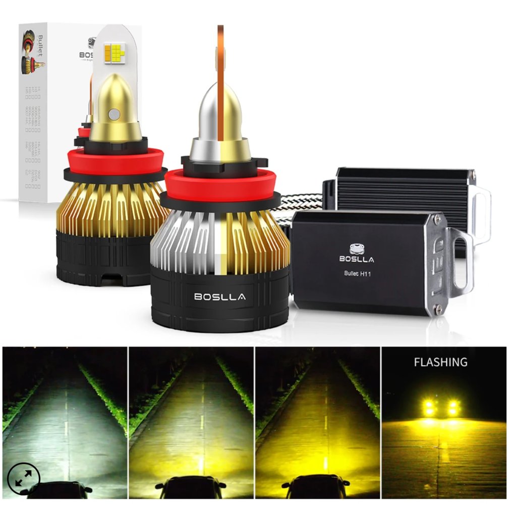

    https://www.tacomaworld.com/threads/kickstarter-thoughts.579853/page-2#post-19372742
    Crash tested an older model from the same brand. I doubt this new model improves on anything, other than adding MORE glare.
    This is another brand that sends their products to influencers and "buy" good reviews.

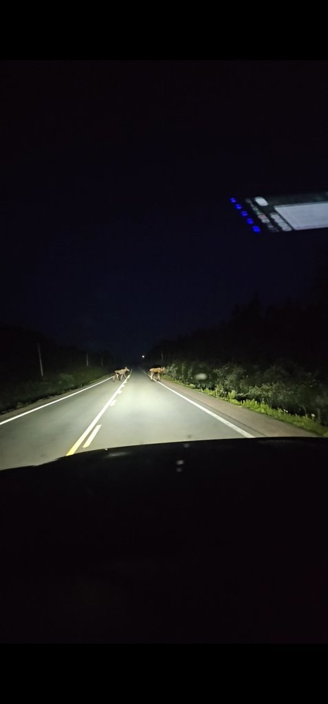

    why i invest in good headlights living in a place with the highest density of moose in the world. i come across multiple moose and caribou on the highway basically every time i drive at night.
