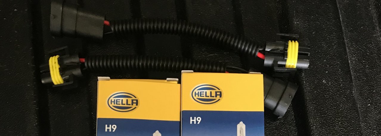

    Amazing thread. I had the 35w morimoto kit for a few months but had annoying bulb shake. Ripped them out and have been suffering to see the road with oem bulbs. At this point, im not so much in search of color (i.e. 4300-5000k) as performance, durability, and simplicity which leads me to running halogens over led, hid.
    I think I will go for the hella h9 bulbs as they last longer and are much cheaper to replace, however, after reading through all the threads, I still don't understand why there needs to be cutting involved if you have a H11-H9 wire connector. The cutting doesn't scare me, but it just doesnt make sense. I had experience with my HID kit with the h11-9006 connector and that was simple plug-and-play.... Thanks @crashnburn80 for your time and research!!!!

    These connectors pictured have a small tab between the two terminals of the male end that need to be shaved out to fit into the H9 bulb. Then put the pig tail in between the factory harness and your new bulb. This keeps factory wiring original and prevents the need to trim replacement bulbs in the future. Trimming the pig tail is very easy. I used my pocket knife and it two about 90 seconds per pig tail.

    right, i guess I just could not understand the point of buying an h11-h9 adapters if you still had to trim the h9 end. I think I will go ahead and just buy the $7 adapters if it means my oem wiring remains untouched

    I am very much against altering factory wiring so that was my reasoning. You’ll see when you have the pig tails in your hand the tab that needs to be trimmed. Super easy.

    To be clear, the OEM wiring always remained untouched. It was just the inner plastic tab on the H9 bulb that had to be trimmed. Getting the adapter harness and trimming it once makes it so you don’t need to trim the each time, making it then plug and play.

    We don't yet have an H11-H9 connector. People are getting an H11-H11 connector and modding it to accept H9 bulbs.

    Ahhhh, so there is no h11-h9. That makes perfect sense

    *yet. I’m working on getting an HD relayed harness made that will be plug and play H11->H9 to further increase the output of the H9 bulbs.
