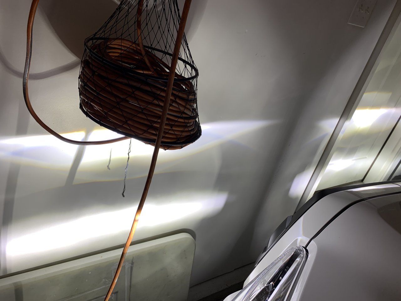

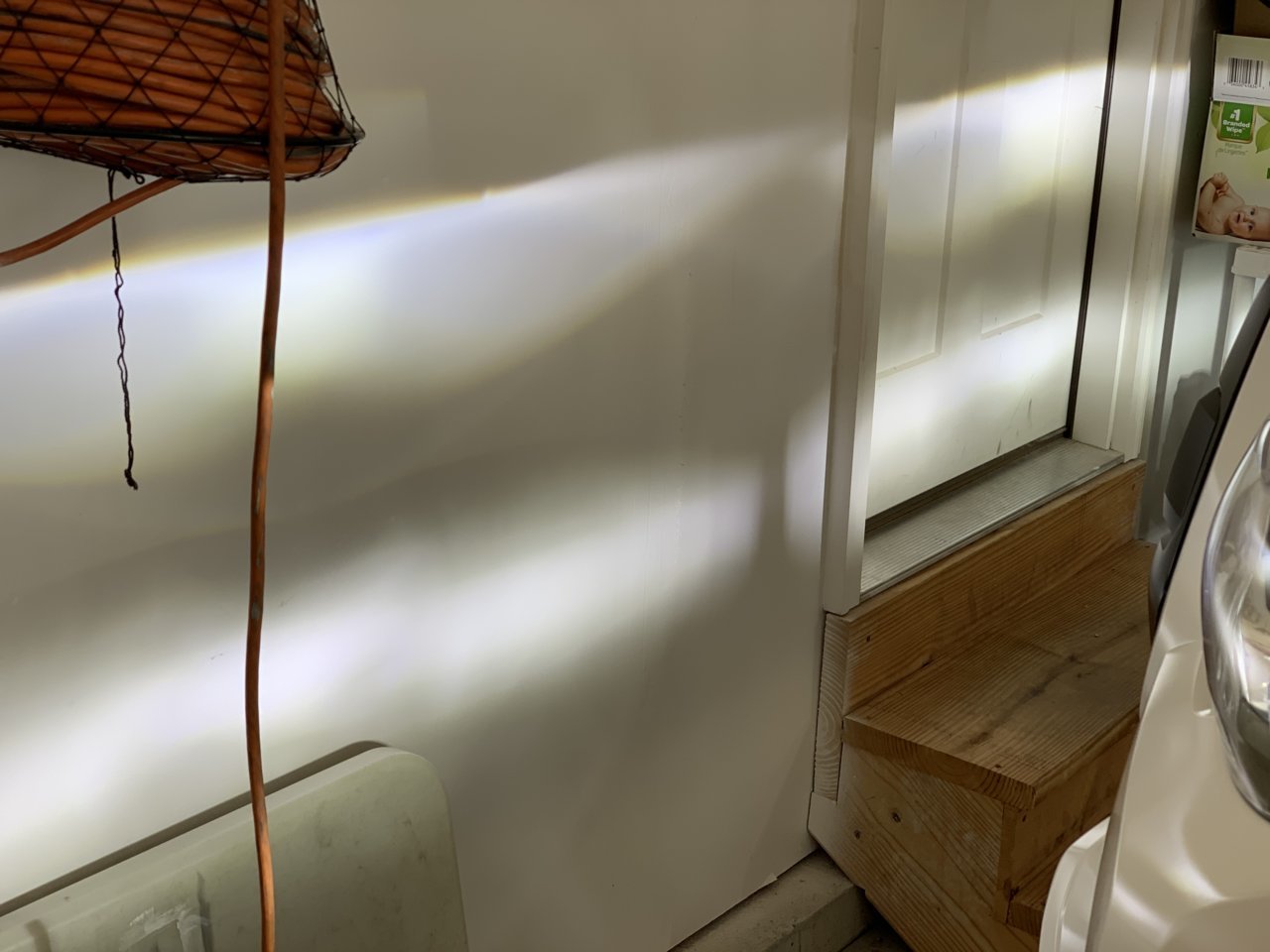

    I haven’t road tested and I know I’m going to get crap about how they aren’t as bright as the ge 130 mega however if it brighter than what I have and they look cool too then I’ll be happy.
    I’ll report back so if any is interested you can get an honest assessment

    I guarantee you those LED’s might, at best, barely put as much light on the road as the factory H11’s in a small portion of the beam pattern. In fact from your photos you can see that the beam pattern on the LED’s is patchy and uneven compared to the stock halogens and its even worse on the fogs. For $36 you could have gotten a full set of Hella H9’s for the lows and the fogs from Rallylights and gotten more light on the road with the bonus of being just as obnoxious in the fog reflectors as those LEDs are. But they wouldn’t be 5600K blue-white in color, and sometimes I guess looks are what matters...

    Even in that ridiculously close wall shot, you can see the hot spot dipping below the cut off, indicating loss of distance projection. Extrapolate that out over distance and performance is going to be poor. What you saw on a neighborhood drive is a significant increase in foreground light, which is normal for people to think this is an upgrade after their first drive around the block. Your hot spots are now aimed down instead of outward, so the light on the pavement immediately in front of your truck is increased. It isn't till you need to project light distance at night that you realize your headlights have lost significant functionality.
    Even in a well lit room, you can see the halo of glare from running LEDs in halogen reflectors in your fogs, with glare extending above the headlights. I suggest reading this thread to understand what you have done and why that is an awful practice:

    It’s the pic take a better look at beam pattern on left. The right is hitting off angles and doors D1C2665B-A7DF-4FD6-A5BE-6A82A4FD76DB.jpg

    There's obviously no convincing you... Just make sure the head lights and fogs are aimed properly. If the truck did not move in those two photos it looks like your fogs are aimed high now.
