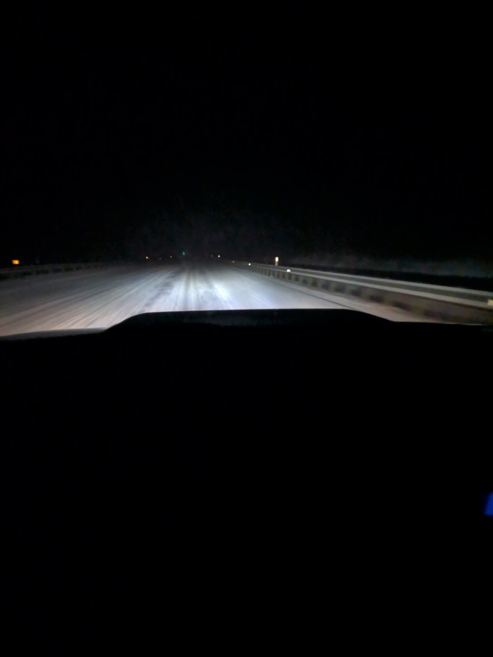

    This was taken in western NY, about 2am. No street lights, snowing and very windy. I honestly don't think the light output is that bad. The light has no blueish tint in person. They may not compare to the H9s, but they appear better than stock. The 4Runner projectors are a little different than the Tacoma's though.

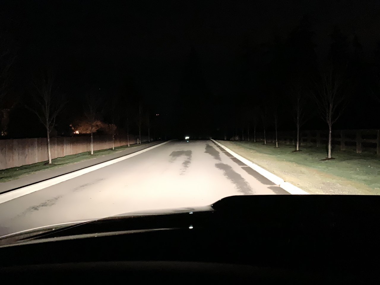

    I see your LED upgrade:
    And I raise you a performance halogen upgrade, late at night with no street lights. Low beams only, no fogs. The talk of performance halogen beam saturation is a thing.
    2nd Gen Osram 85/80w Hyper All Season H4s w/ Headlight Services 12 awg harness providing increased voltage:
    In all honesty though, pictures are a terrible way to compare output unless both light sources are being captured in the same photo with the same camera settings. Cameras lie. Scientific instruments do not. And the 4runner has some pretty bizarre side entry projectors, where you get one LED chip facing forward and the LED blade obstructing much of the rear facing chips output.
