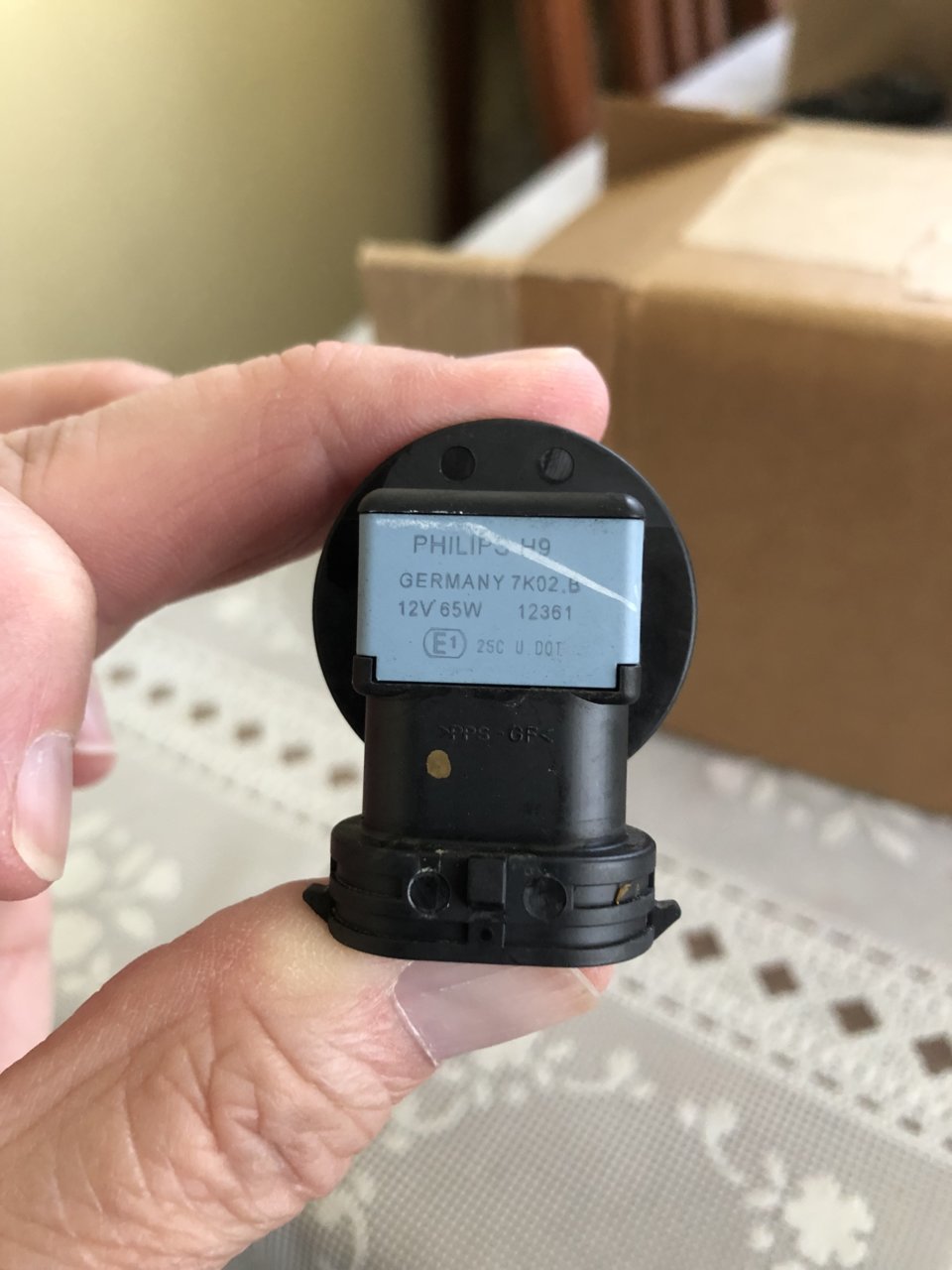

    There were Philips in my 3rd gen.

    Interesting. I didn't have an opportunity last weekend to install the Hellas. I'll have to double check the bulbs I pull out when I do, maybe this afternoon.

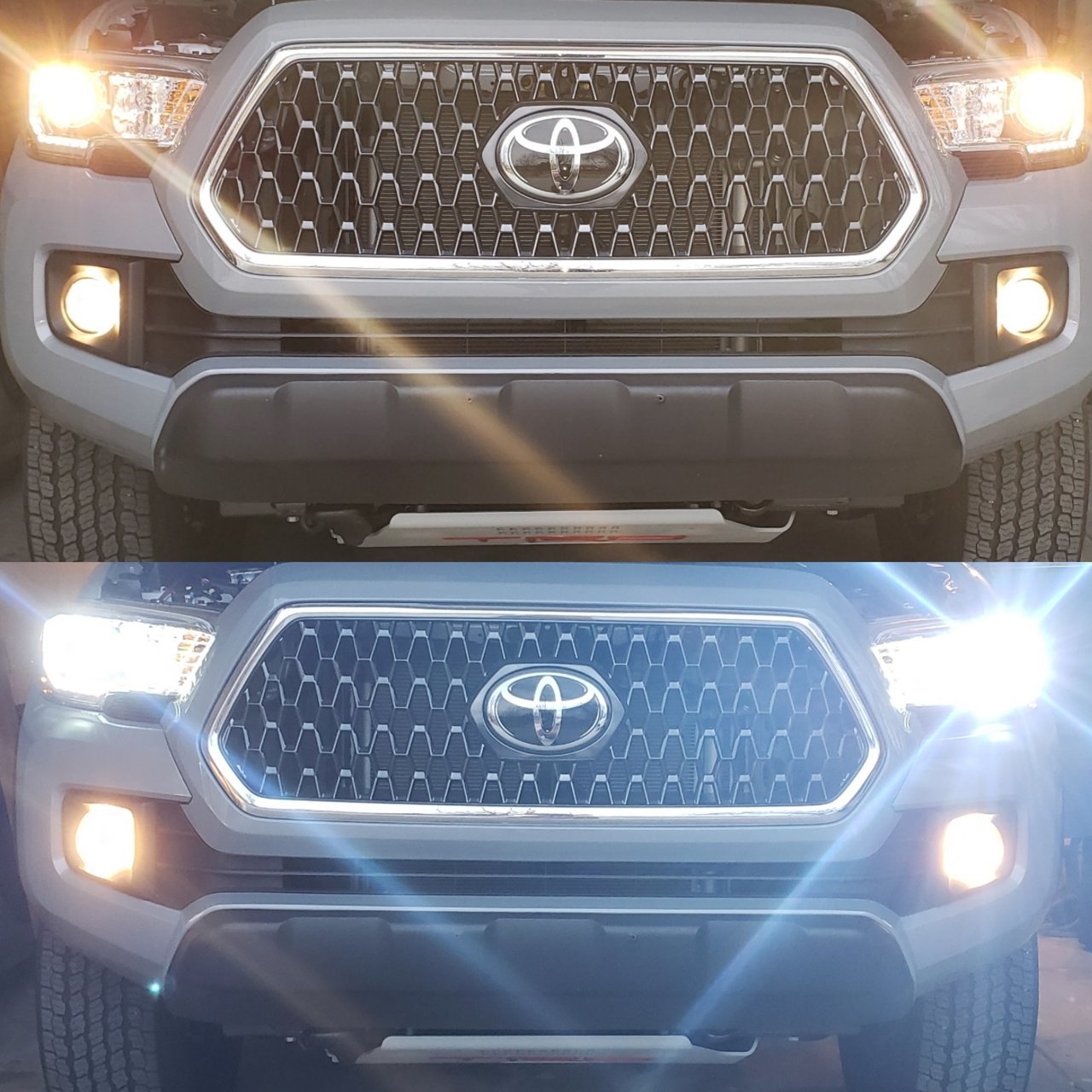

    Installed the Hylux 6000K HIDS from ebay for the low beams. I posted a short video of the beam pattern and cutoff on my Instagram page: kalashnikov_4774
    Rockoma5 likes this.

    oh shit.......get ready ...you didn't buy halogens....here comes the haters :crapstorm:...lol...It Looks good though...I like!

    Confirmed.

    Mine have them too. Just switched to the Hella H9's for the lows and they are worlds better.

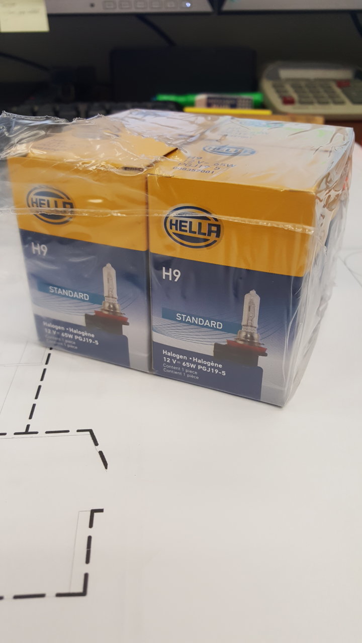

    Just checked the Hella H9's I got from Susquehanna Motorsports, and they were made in Korea. Is that a problem? Are they worth even installing?

    What's wrong with made in Korea? I put mine in last night and they are worth it!
