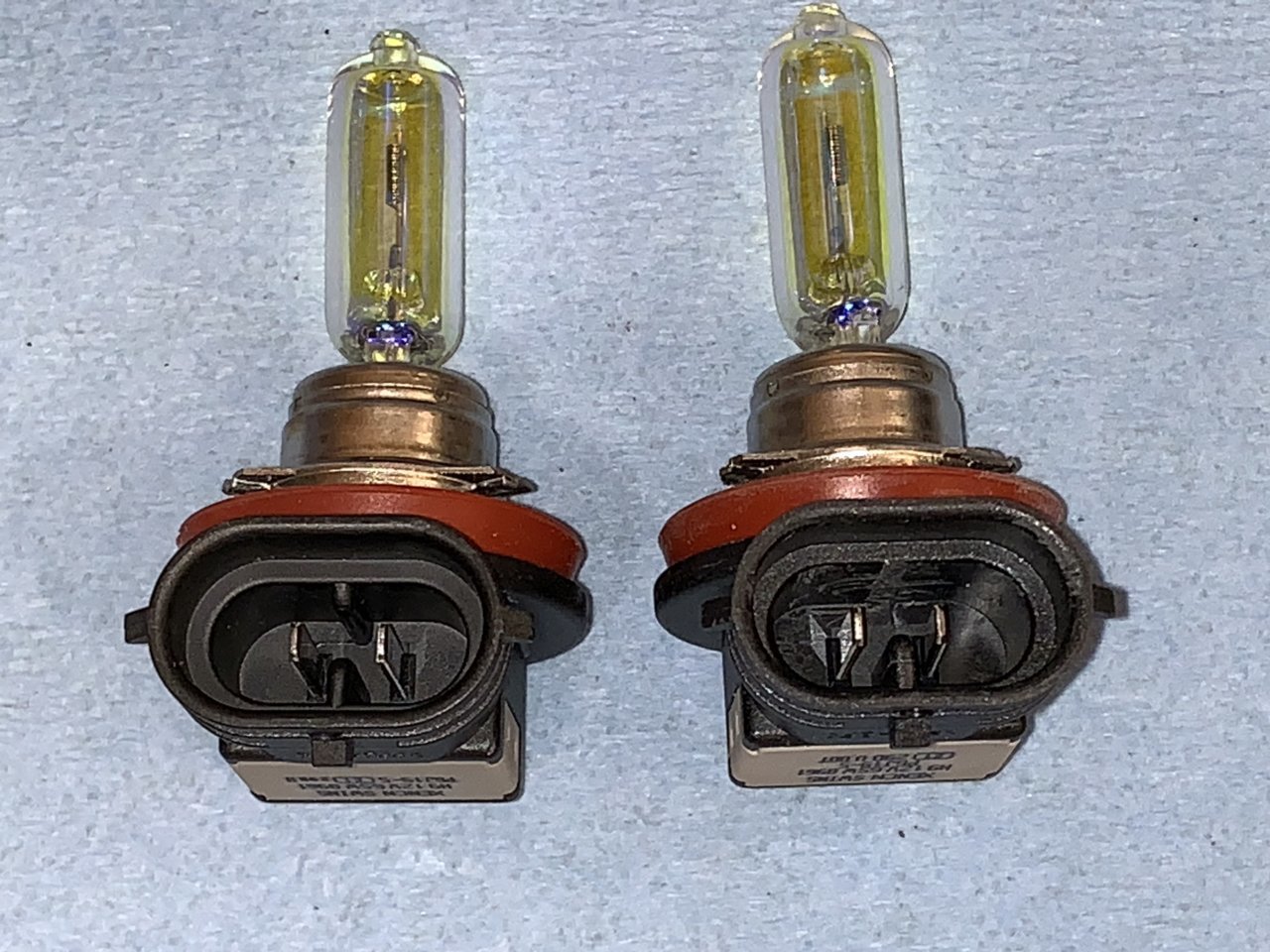

    No, the 3rd Gen German Philips H9 high beam bulb is slightly higher performing than the Hella H9s. Both are massively higher performing than the stock 3rd Gen H11 low beam bulb. Swapping the low beam H11 bulb out and replacing it with a German Philips H9 or Korean Hella H9 (both also offer Chinese versions) is the discussed upgrade. To do this you will need to trim an internal plastic tab off the bulb so that it will fit the H11 plug, as shown here with different H9 bulbs.
    Or use the adapter harness others have created by modifying a small H11 to H11 jumper harness so you modify the harness connector once rather than the bulbs each time which is much more convenient.
