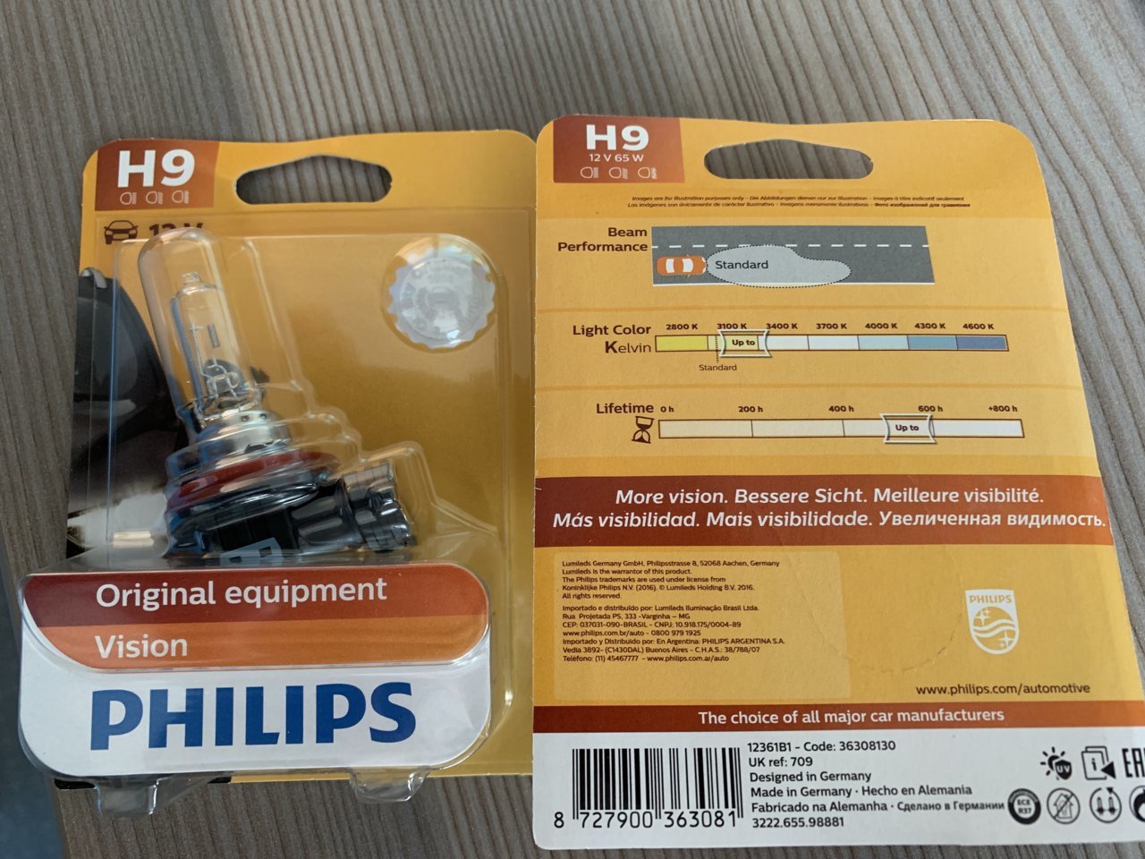

    These just arrived from the UK. Philips Vision H9s.
    While Vision is supposed to be +30, the back of the package says Standard. The markings on the bulb seem to indicate they are Standard bulbs. Need to get the Standard German bulbs to compare.

    So..... funny thing. There does not appear to be any Philips Standard German made bulbs. The Standard bulbs are Chinese, and labeled "Original Equipment Quality", whereas the German Vision bulbs are labeled "Original Equipment". It appears Philips used the 'Vision' branding to set apart the better German H9s from the cheaper Chinese ones. Since Vision meant +30 on the rest of the product line, it looks like people correlated that the Vision H9 must also be a +30, however the package lacks the +30 branding and increased performance claims associated with the other +30 products and on the back shows pattern performance as 'Standard'. I'll still test it against the Chinese Philips to see what the differences in output are.
