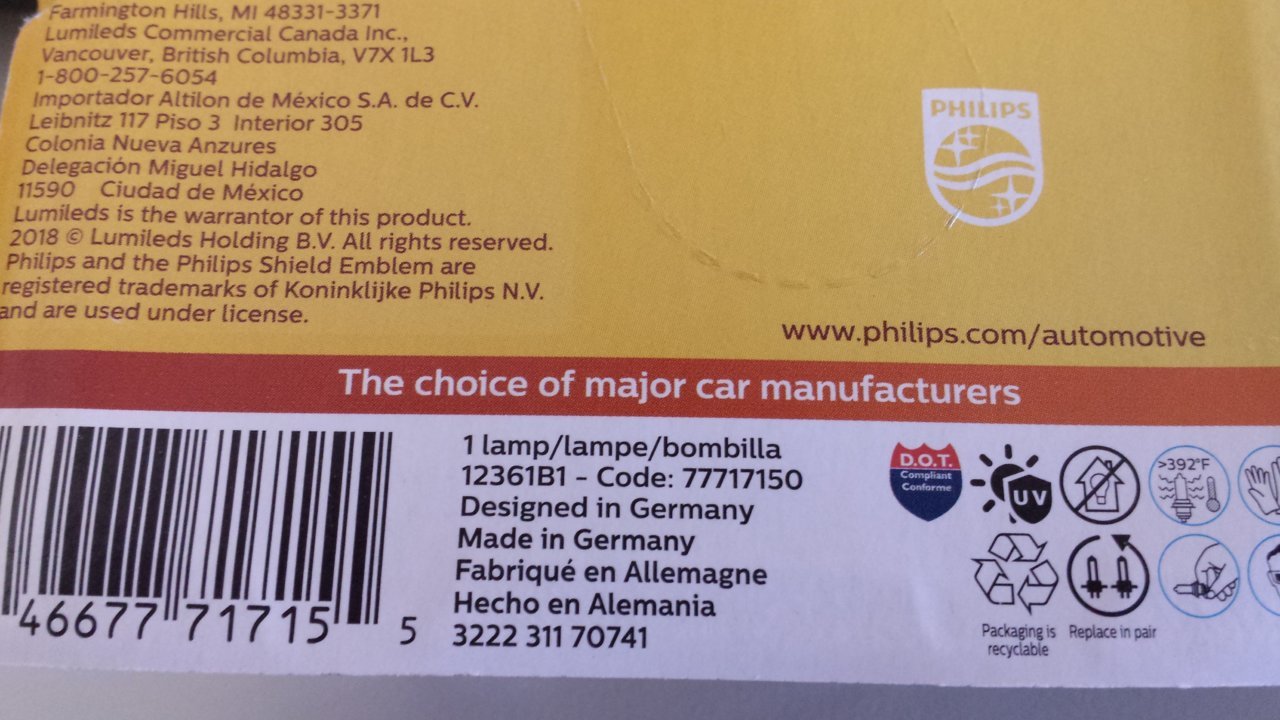

    I ordered GM part number 10351666 for $14.68 plus tax from the local GM dealer in the hope that it would be a Philips H9. It was delivered next day from their warehouse in Montreal. Turned out to be an Osram made in Germany.
    I am planning to re-run test on the weekend, outside this time since the weather is improving every day. Will chisel wall until it is the right number of mm from the truck!

    Almost the same.

    Hmm. My ACDelco bulbs haven't shown up yet, they should be here this week. Pics I found online showed the German Philips bulbs, but ACDelco may just use Osram and Philips interchangeably or switched suppliers since the photos I found were taken.
    I also ordered some GE H9s, and have the China Philips H9s coming from @Frank_Zuccarini in addition to the Xencn 70w H9s all due in this week. That is the last of the bulbs I plan on testing at this time. I'll then update the first page with comparison charts and recommendations.

    Based on pics from an Amazon listing, that is the "sylvania basic" bulb that can be bought off the shelf at most auto parts stores.

    Right. That is the Osram bulb that was used in the original post of the thread, which is also sold under the Sylvania brand.

    I just received mine and they were the crappie Chinese ones. Hopefully there as good as the German ones

    Same story. Came in today. Chinese H9
