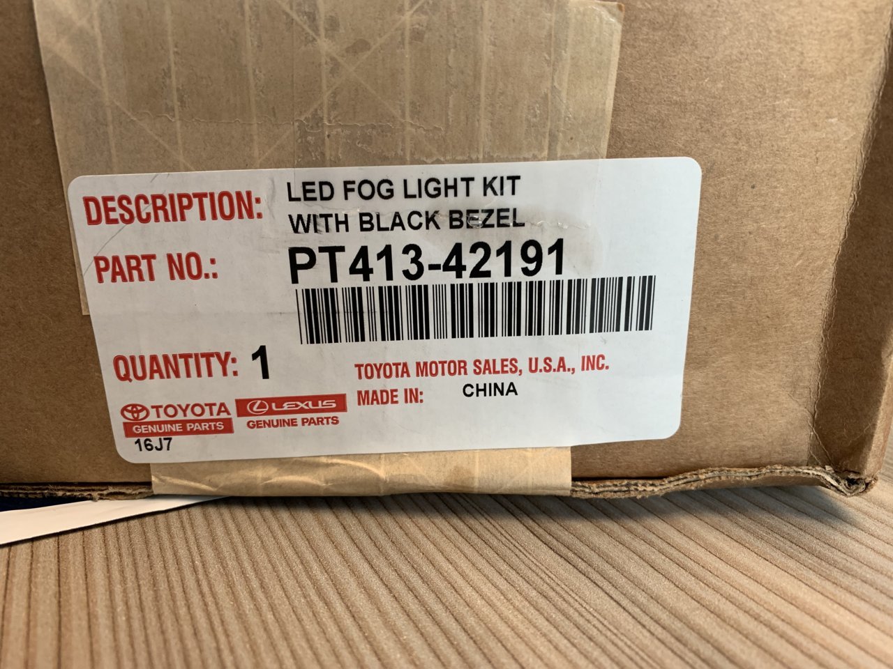

    Close! But effectively yes. :)
    PT413-42191 has the black surround
    PT413-42190 has the chrome surround
    Too many questions on how they stack up. Need to collect some actual data.

    Toyota likely just sourced from Valeo for the fogs whom is their OEM supplier. And for the LED fogs Valeo decided to build them in China, because cheap. The pair of the LED fogs is literally cheaper than a single OEM Tacoma halogen fog, without the bulb or surround.

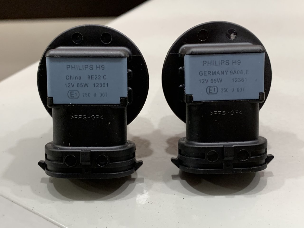

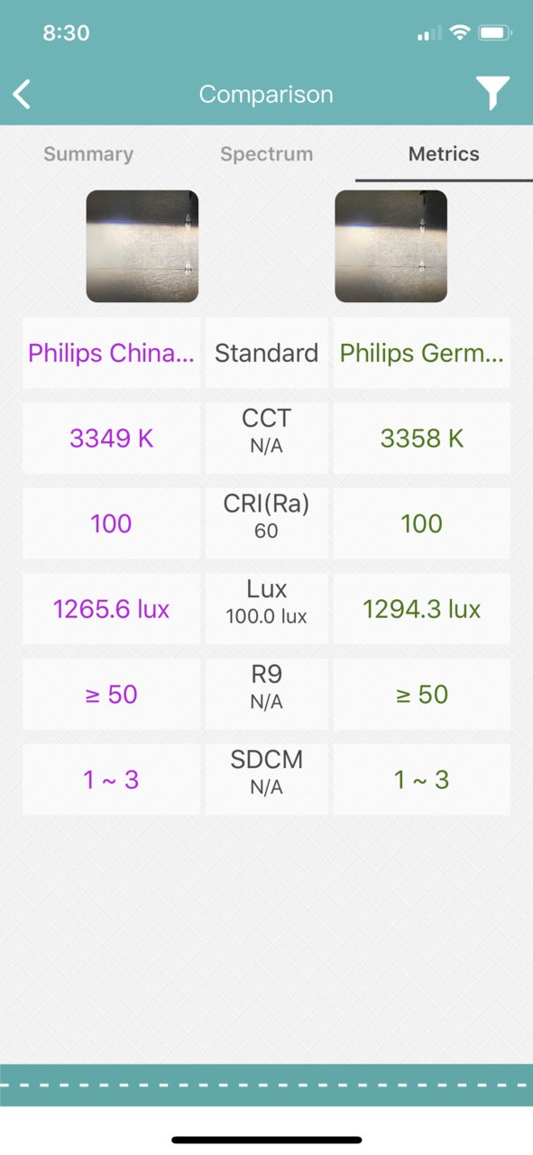

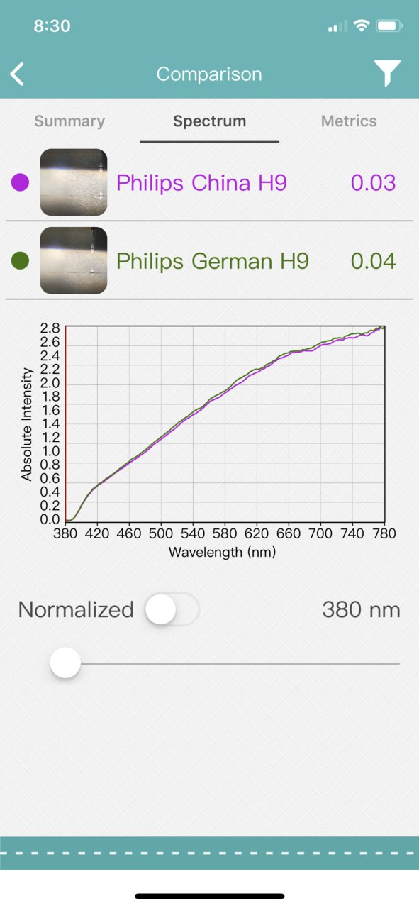

    Surprisingly, the Philips German bulbs and Philips China bulbs seem nearly identical.
    The China Philips filament quality and build quality appear perfectly on par with the German counterpart.
    C438D4BE-8F8C-40D6-8FE7-8DECBB6DD1CE.jpg CFF3DF48-73E1-490C-A7AC-7D894D845FC5.jpg
    Philips German left vs China right
    While the German bulbs are ever so slightly higher in output, the measured difference of 2% is within noise you’d get from testing multiple bulbs of the same label. So it appears Philips has good reason to sell these bulbs as interchangeable. I’d still personally prefer the bulbs said Germany on the back, but Philips does appear to build high quality bulbs from their China plant.
    I’ve tested many Philips bulbs from Germany. I only have a sample size of 2 from China. But I don’t see anything in the Chinese version build quality that would lead me to suspect anything different. The bulbs are virtually indistinguishable. You can always get bad bulbs from any batch, so this isn’t to say the overall quality/error rate of the two plants is the same, but based on the products I have they appear virtually equivalent.

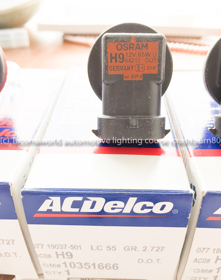

    If you order AC Delco part number 92095788/10351666 from RockAuto, this is what you get right now. Seems to have shipped from Syracuse NY.
    For Canadians, if you buy four, will cost you $11.37 per bulb all in. You can get the same bulb from any GM parts counter for $14.68 plus tax.rockauto osram-1-3.jpg
