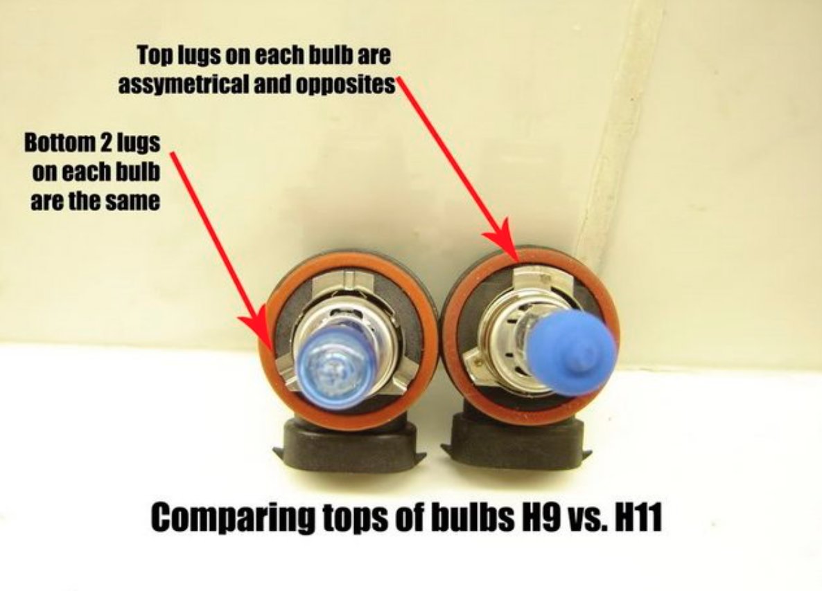

    Did you trim the metal tabs on the H9 bulb so they resemble the H11? It shouldn't matter if the radiation pattern is rotationally symmetrical around the filament axis, and I don't think the insertion depth is too much different if you don't. It still seems to go in nice and tight like prom night if you don't. But people talk about doing it so there is probably a reason.

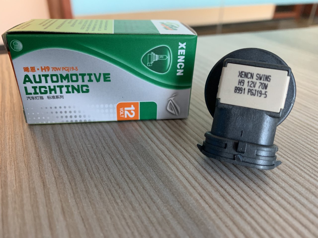

    Talk about trimming the collar? It depends on the bulb and the housing. It is a tight fit but some bulbs actually won’t fit. The only ones I’ve had that case with on the 3rd Gen lights are the Xencn bulbs. Some have been tricky, but all the rest I’ve tried fit with some patience.

    I was wondering if the H9 bulb is really inserted correctly because sometimes I can't seem to rotate the bulb so the connector is facing down (vertical), and I'm pretty sure the insertion depth is important. Some people talk about trimming the tabs/lugs with a dremel. Not sure if the tab just prevents you from entering the mount, or whether it also prevents you from rotating the bulb fully into position because there is a stop molded into the female plastic housing. It looks like the rotational orientation when you start inserting, might matter.

    When I put my H9s in the low beams projector housing, they wouldn't fit at first. I simply twisted the tab with needle nosed pliers. They fit in easily then, and turned to the correct vertical position. No dremel needed.

    I haven't ever modified the tabs. I hook one of the tabs behind by inserting the bulb at an angle, then rotate to insert the other two tabs. I will try your needle nose pliers technique, thanks.

    The 70w H9s showed up. We’ll see if they are any good. Annoyed that I ordered 2 sets of these, and only 1 set showed up.

    Nope didn’t trim the metal tabs. Maybe that’s the culprit?
    Sweet, thanks for the clarification. I am running the phillips H9. I might have to mess around with trimming the collar later today.

    Just now I tried taking about 3 mm off the left side (as shown in the pic) of the top tab, with tin snips. Worked great. Side cutters will likely work too. Don't think a dremel is the best tool for the job.
    Wear latex gloves while you are doing it, it is hard not to touch the glass while you are handling the bulb!

    I tried that with tin snips for an H9 that didn't fit and had a hard time, I think my snips are too large. I used a dremel with a small cut off wheel but you have to be really careful to not nick the bulb seal. I put some cardboard behind the tab and in-front of the seal as a guard against nicking the seal and it worked well. You definitely want to wear gloves.

    That cutter is similar to the one I used to trim my h9's. Quick and clean.

    That is quite a bit smaller than the one I had tried to use. But you shouldn’t need to trim the Philips to fit, they will seat in properly.

    I just put Philips H9’s in my HB and LB with the modified adapter plug extensions for LB. I couldn’t get the bulbs to snap into the projector with the connector straight down on the LB. they are in and secure, just not clocked like the bulbs that came out. Same thing happened when moving my GE +130’s to my fogs. Could not get them to snap in the same orientation of the bulbs that came out. If I twisted any harder on any of them, something was going to break.
