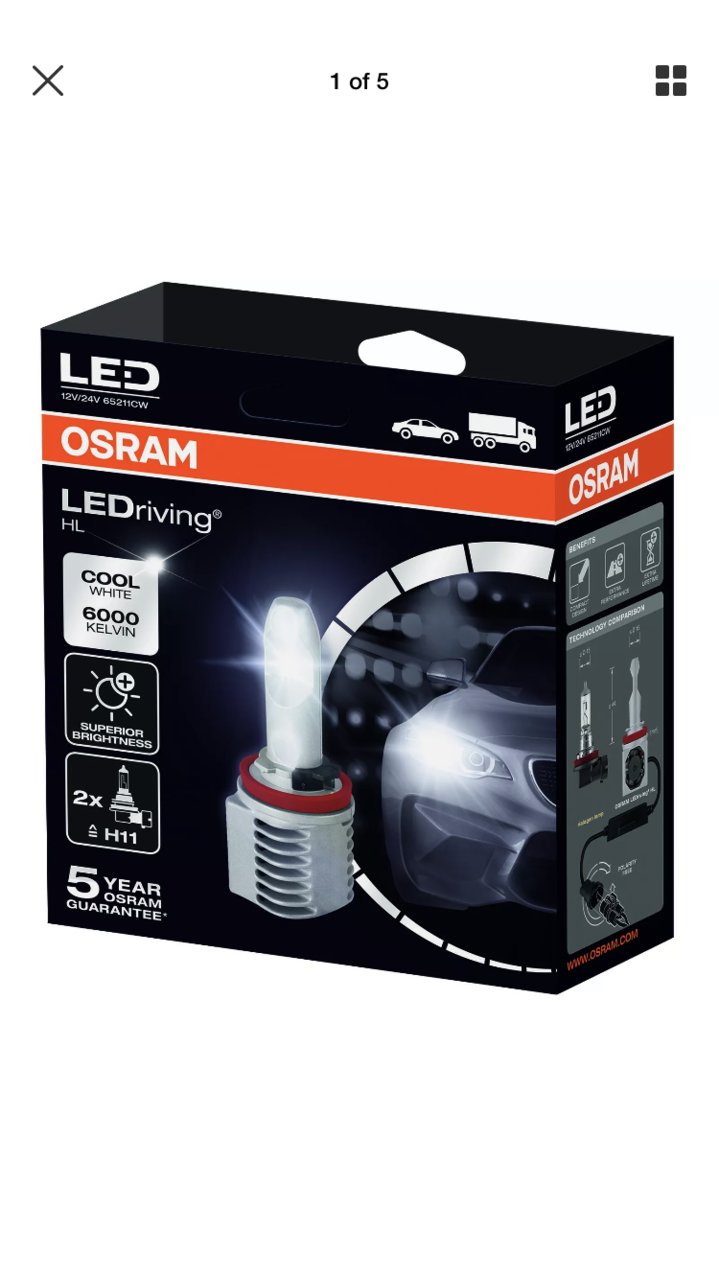

    Anyone had a look at these H11's yet?

    I have not. Being Osram you know they will have more R&D than most.
    SAE is currently drafting output compliance specifications for engineers to work toward to build legal drop in LEDs. LEDs are not there yet, but if they can build them small enough they may be able to get enough projection with reducing glare enough to meet the minimum requirements. Although a basic performance halogen may still perform better. You know reputable brands like Osram will be all over that and build something to meet the SAE/DOT spec. And the Chinese crap will also be all over it to falsify compliance claims making this market space even more confusing.

    I figured with the R&D Osram does ($$$) they'd be at least on par with any other offerings out there, and likely better.
    Are these not dot compliant? I thought they were. Maybe I'm wrong.

    No drop in LEDs are SAE/DOT compliant. You’ll notice the box makes no such claim. All are federally illegal.

    LEDriving HL H11 Gen1
    ≙ H11
    65211CW
    14.00W
    Suitable replacement for H11
    With LED technology and a color temperature of 6,000 K, the OSRAM LEDriving HL represents the most convenient solution in order to upgrade your existing headlights – providing a stylish cool white look as well as improved visibility for everything that lies ahead of you. It can be installed in place of certain H7 high and low beam lamps. The pair of lamps comes with a 5-year OSRAM guarantee and with a long service life. For precise guarantee conditions please refer to www.osram.com/am-guarantee. Please note: These products do not have ECE approval. This means they must not be used on public roads in any exterior application. Use on public roads leads to cancellation of operating license and loss of insurance coverage. Several countries do not allow sale and use of these products. Please contact your local distributor for information on the availability in your country.
    Can't use 'em in Europe, at least...
    https://www.osram.com/am/ecat/LEDri...01_3063273/PP_EUROPE_Europe_eCat/ZMP_4056682/

    USA is no different, just not as strict on enforcement depending on your state.
