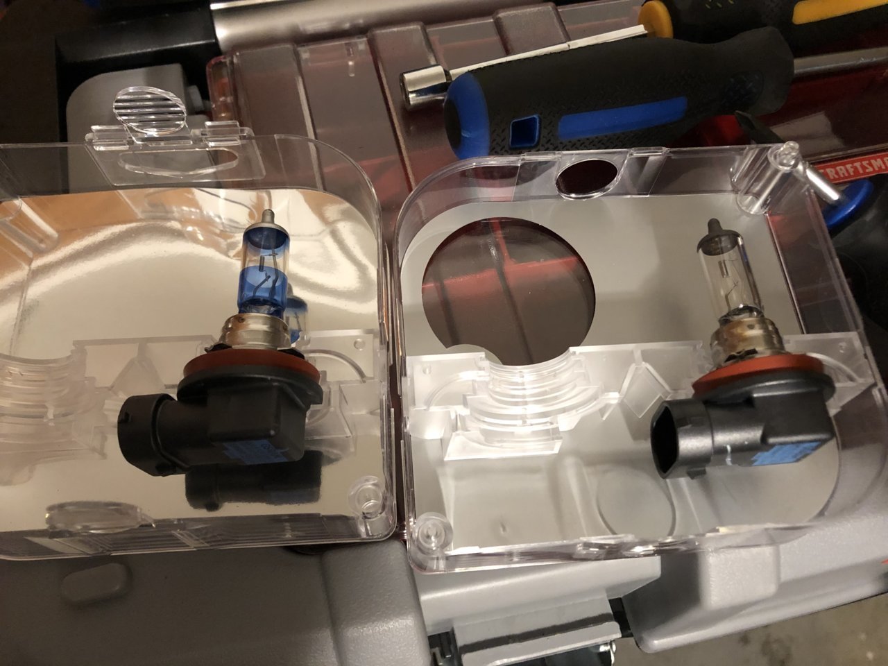

    I ended up going with the Phillips H9 for the lows and the GE H11 nighthawk xenons for the fogs.
    I went ahead and used the modified H11 to H9 harness for ease when it’s time to replace.
    Never would have believed picking out bulbs could be so stressful!!
    Thx to everyone who took the time to answer my questions. Your shared knowledge is much appreciated.

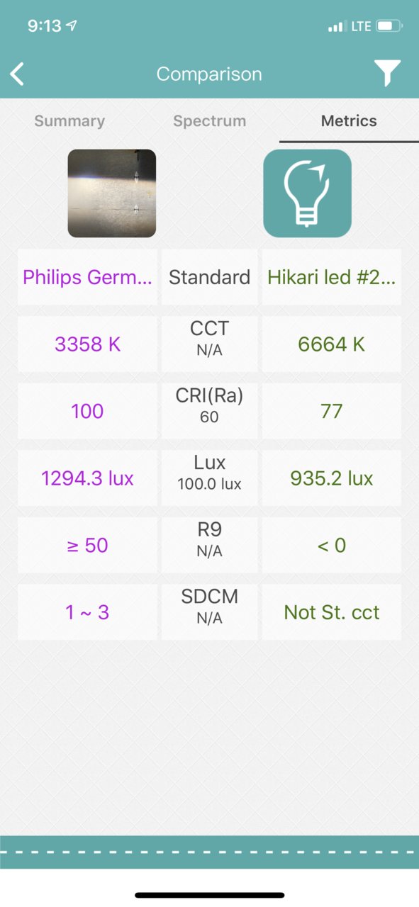

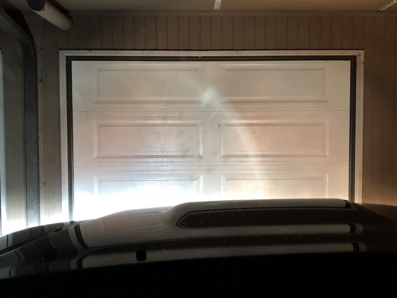

    Hikaris are one of the better LEDs, they still produce glare and should not be used in a reflector and definitely not a foglight. Bulbfacts makes money off selling you their recommended products, click the Amazon link next to a product on their site and they get paid. Not a good site for unbiased information.
    Here is the Hikari left vs a glare capped H9 halogen that is 2x brighter than stock halogens right.
    Only someone that knew nothing about lighting would recommend the Hikari in a reflector housing, or someone trying to sell you a product to make money off their recommendation... like Bulbfacts.

    Got that covered too. Hikari is no match for sub $8 Philips. Tested in the 3rd Gen Headlight below. Of course at distance the Hikari will fall off much quicker than the Philips which will project better.

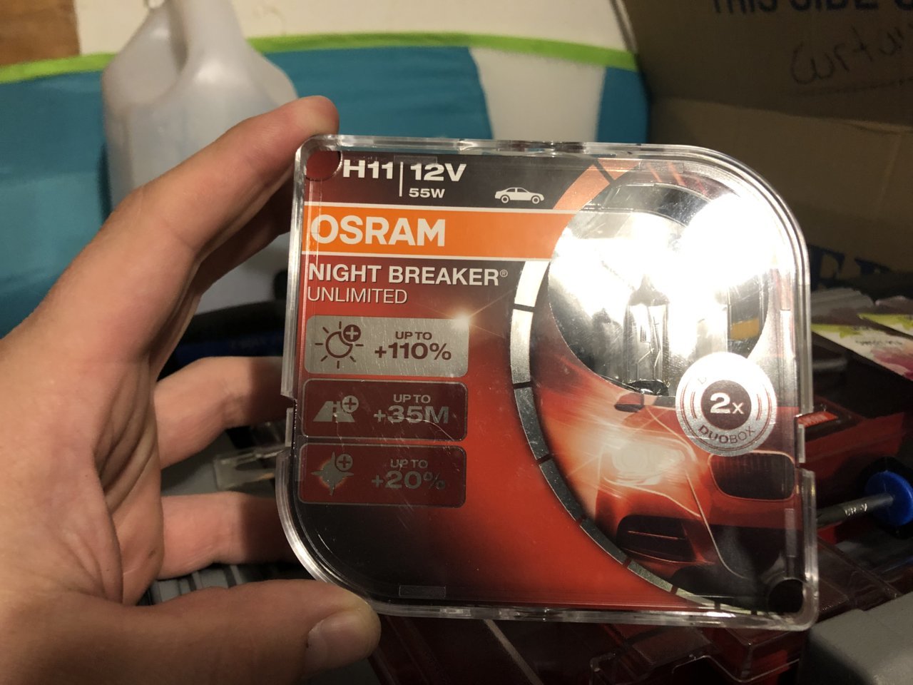

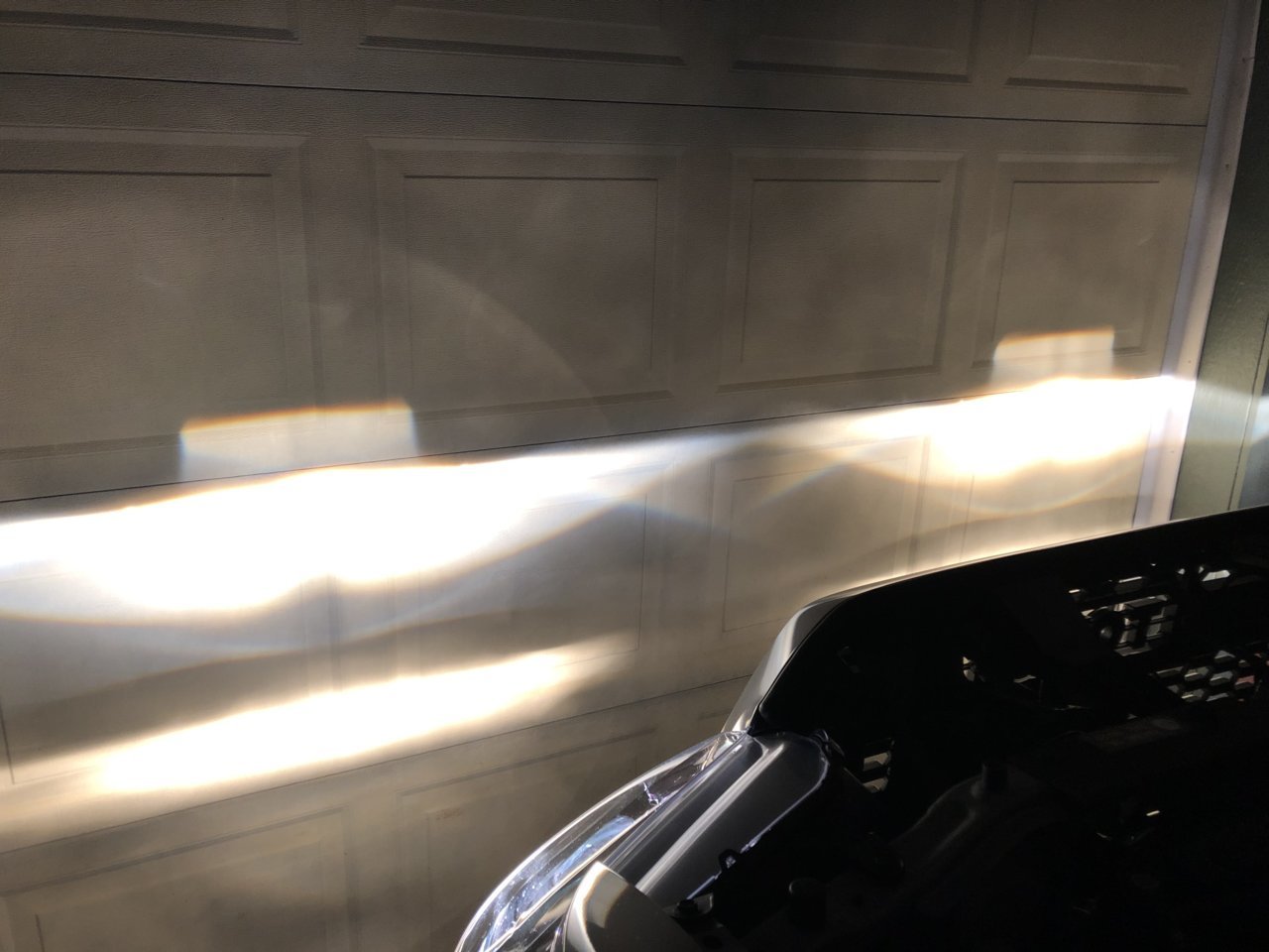

    2019 Tacoma Sport. Canadian so not sure we get different bulbs from the factory. Replaced OEM Osram with Osram Nightbreaker Unlimited 110%. Noticeable improvement. Photos are tough to take but you can see the improvement on the left.
