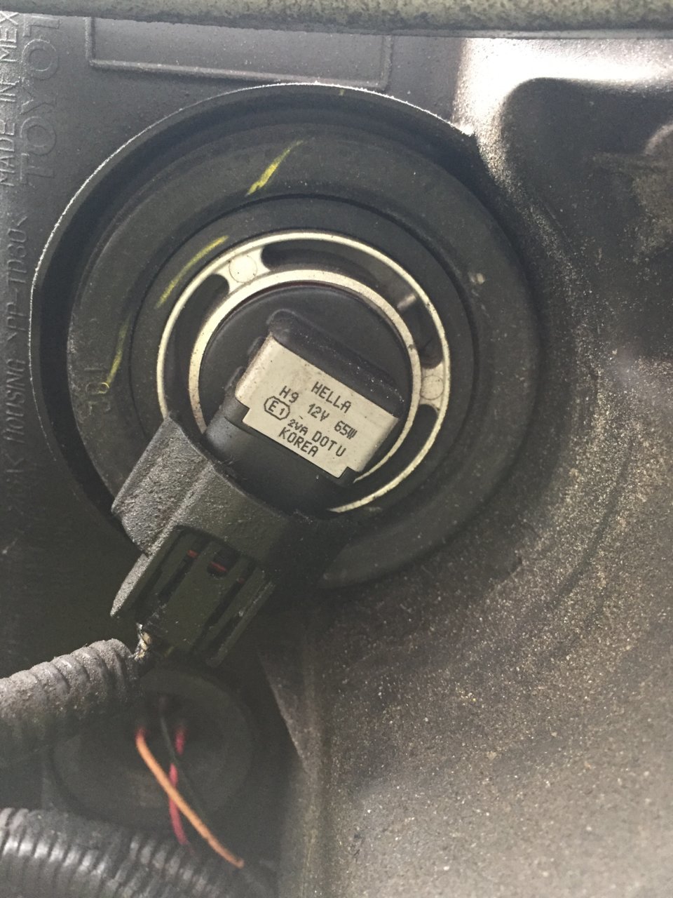

    Alright, it took me a day and a half to read through this entire thread periodically when I had some spare time. I just have a couple of questions.
    A few people have mentioned that doing an adapter to H9 bulbs in the low beams sometimes leaves the bulb not properly clocked and at an angle. However, this shouldn't effect the beam pattern at all, right? Does it cause any interference or difficulty plugging them into the harness? I'm just trying to figure out if trimming the metal piece on the bulbs is necessary and, if so, where exactly do you make the cut?

    I have the H9 wire harness adapters. You just cut a little notch for the bulb. Snaps in perfectly . Bulb is clocked correctly.

    Thank you for response. Unfortunately, my question may not have been worded properly. I understand the required trimming for the harness, I was more concerned with the fit of the H9 bulb in the headlight assembly. It was briefly addressed in posts 1024-1026 of this thread, just wanted clarification if any trimming of the metal tabs on the collar was required with the Phillips H9...

    I have done several conversions and have not trimmed the tabs on the Hellas I have used

    No trimming of the collar is required on the Philips or Hella H9s. It is a tight fit and may take a minute figuring out how to align the bulb, but they will fit. Xencn bulbs (not recommended) required the collar trimming.

    I think there may be a stop molded into the headlight's threaded bulb receiver, that prevents rotation of an H9 bulb into an orientation where the electrical connector is facing straight down. In other words, the tab at the top is preventing full rotation, and may need to be trimmed. At least, that's what it seems like on my 2018. That is about as much force as I wanted to put on the bulb, I thought I was risking damage if I hulked it any more. Maybe I need to rotate in a clockwise direction instead of counterclockwise? The camera is roughly vertical.
    If the filament is coincident (not offset) with the longitudinal central axis of the bulb, rotation of the filament should make no difference. But I question whether my insertion depth is correct, which may rob me of the best optical performance.
