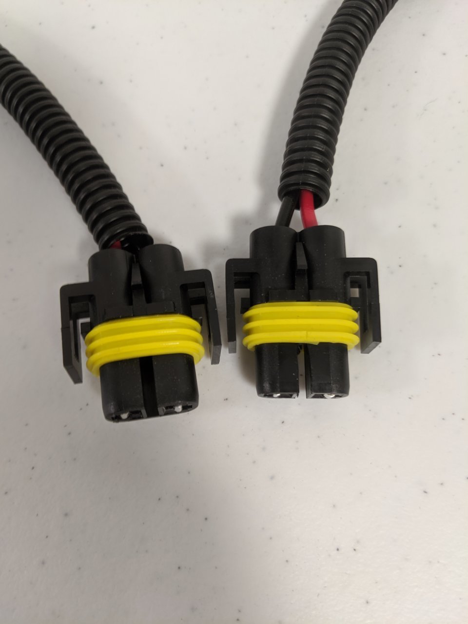

    So just to make sure I'm understanding correctly, the modification for the harness is literally to complete the cutout in the center and that's it?

    Yes. You are correct. Just makes it plug and play

    That's...a lot less difficult than I expected lmfao. Thanks for the confirmation bud!

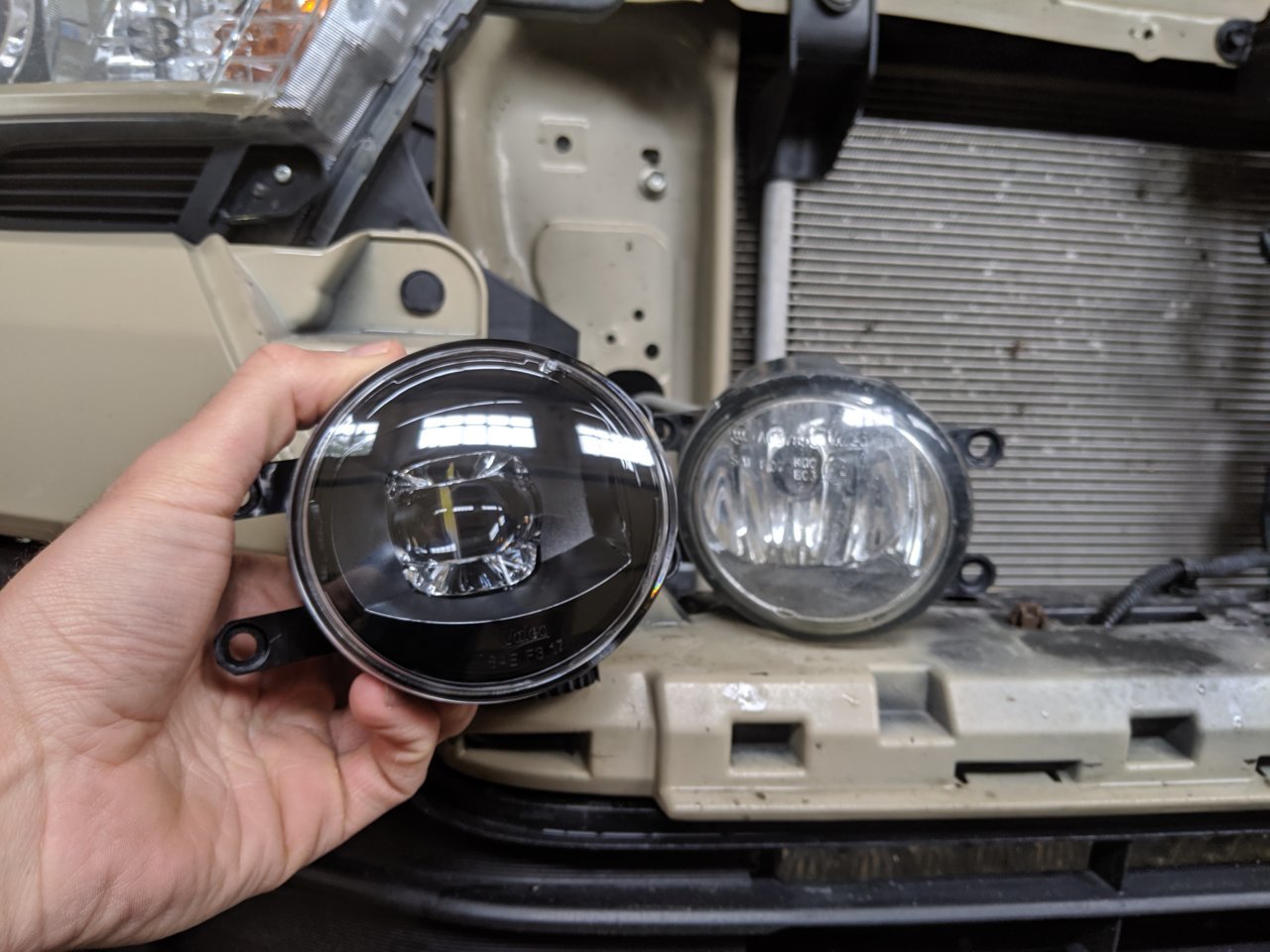

    Thanks @crashnburn80 for all the research and solid information. Swapped my H11 bulbs for H9s today using the iJDMTOY wiring extension from Amazon. So easy. So much better. Just made the little modification to the extension with a utility knife. Also swapped my fogs for Toyota LEDs- a big improvement. No, I don't currently care that the color temperature doesn't match. If I ever do BHLM I'll change my projectors out for LEDs, but for now, the improvement is drastic. All for about 30 minutes of work. Removed the grille, easy-peasy!

    You could always use yellow laminex on the LED fogs to knock the color temp down so the colors were closer in temp and better suited for poor weather conditions.

    I may do that! I often drive in pretty terrible weather. Especially in Wyoming (basically all winter). The taco fogs are 4", no?

    Yes that is correct, 4”.
