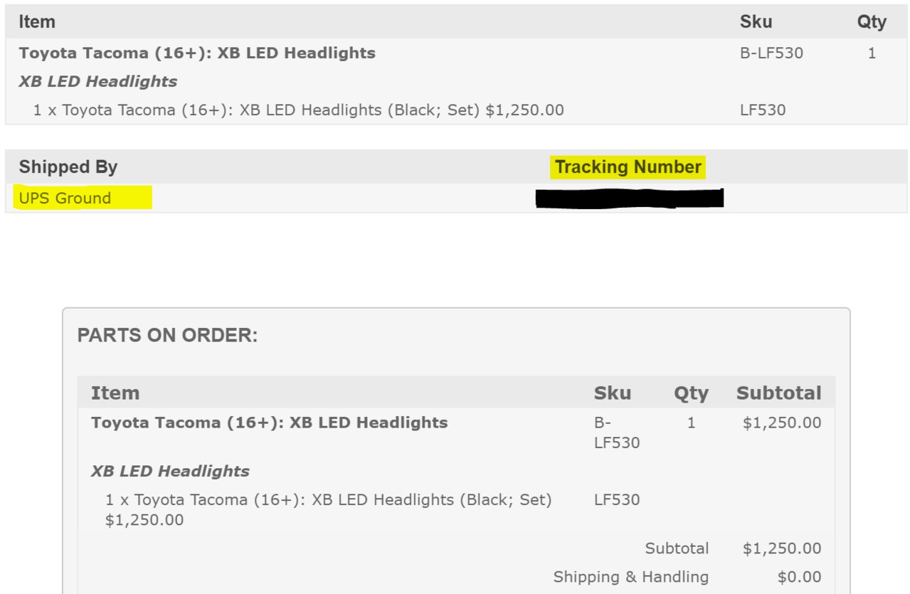

    I’d bet money that proper Toyota RX350 retros perform better. I’ll have the Morimoto output data soon.

    I was just looking at that. It's an extra $130 over the normal price.

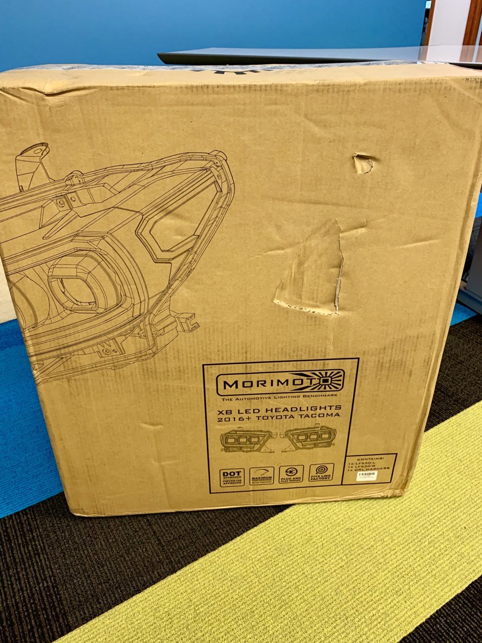

    Just arrived today.

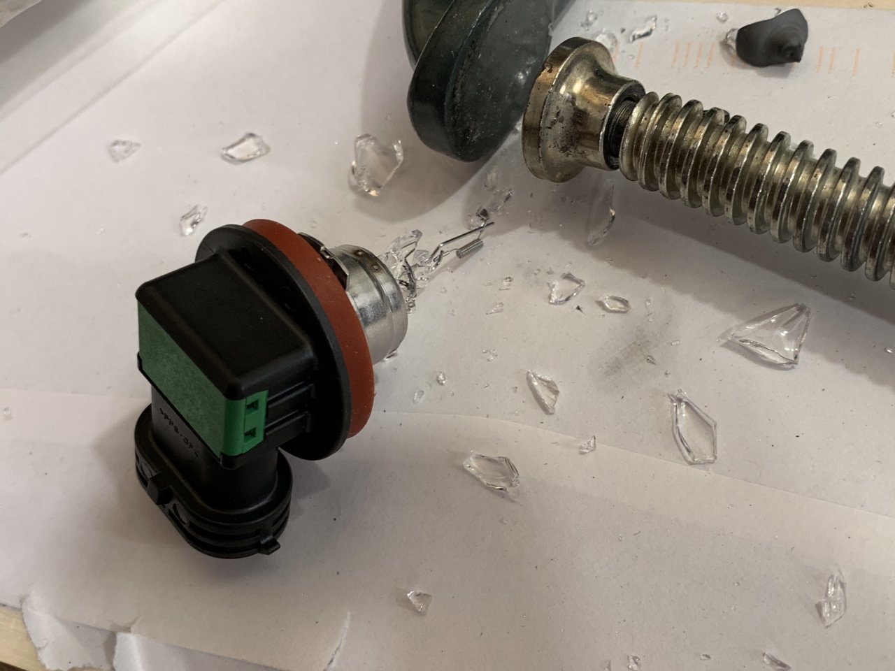

    Sometimes when you really want the data, you need to be creative. How thick is a halogen filament, exactly? Need to remove the glass but preserve the filament.
    Halogen bulbs are pressurized, so I had it covered, even so the pop was quiet loud.

    I see a piece of that glass in my foot. Happens all the damn time, the bad side of being bare foot most of the time.

    Destructive testing? You do a great deal for the community. Thanks so much.......... Frank
