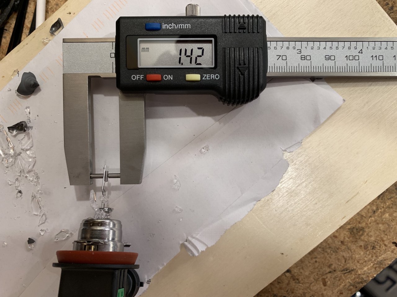

    It should be obvious by now that LED emitters need the correct height and length to replicate a halogen filament. But they also need the correct width, which is where the focus conversation comes into play and what very few discuss. In a halogen based lighting assembly you increase focus by shrinking the light source, aka the filament. To project and perform better than stock, the light source needs to be smaller than stock, which begs the question, just how large is a stock filament? Being encapsulated in glass that is a bit difficult to accurately measure. The solution seemed pretty obvious.
    The above is a low performance long life H11 Philips bulb. Halogen bulbs are pressurized, so they will explode outward if the glass is broken. Wearing the appropriate safety equipment and covering the bulb, I broke the glass with a C-clamp in a controlled fashion as to not damage the filament. Sounded like a small caliber gun shot due to the pressurization.
    The stock halogen cross section for standard focus, 1.42mm.
    How does that compare to the DD LED? Measuring Diode Dynamics LED cross section, 3.03mm.
    If you paid careful attention, you'll notice my measurements differ from what was presented in the earlier video. The Diode Dynamics' LED uses recessed emitters, which can help make the LED cross section smaller providing better focus while maintaining more material for cooling. However, it also means that you cannot measure the distance between the chip faces with traditional digital calipers, as the body is in the way so you cannot get an accurate reading of the cross section. To work around the issue in the video, the measurement of the emitter mounting plate was presented without the emitters, while comparing to the measurements of the outer face of other competing LEDs emitters. There is always a right tool for the job, I purchased a new digital caliper specifically designed to work around this issue to get accurate data.
    The Diode Dynamics LEDs are over 2x the size of a standard long life H11 halogen bulb. In halogens, gains are made with making the filaments fractions of a millimeter smaller. While better than many LEDs, being 2x the size is a significant focus and projection performance loss.
