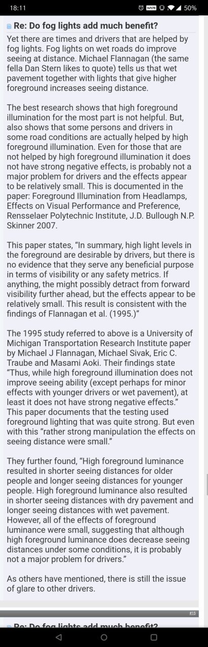

    An oversaturation of foreground light will draw the eyes to the close fog light region, and limit the distance your eyes can see. It's recommended to not run foglights unless in a fog or bad weather situation. It's also why a lot of guys modify projectors with foreground limiters. It's a limitation of the human body that we cannot overcome. There's an entire website dedicated to optics and further proves this point. https://www.danielsternlighting.com/tech/lights/fog_lamps/fog_lamps.html
    "Of course, it must also be understood that all lamp performance standards specify a minimum acceptable performance. Extremely high-performing fog lamps are quite rare, but they do exist. And under abnormal driving conditions (very thick fog, very heavy snow) they can be of some help. That's the key point: fog lamps are meant to be used in heavy fog, rain, or snow to help the driver see the edges of the road close to the car so s/he can safely make progress through foul weather at very low speeds. That is all these lamps are designed, intended, and able to do, and most of the ones available as factory or optional equipment or in the aftermarket aren't even capable of doing that. And as explicated in dense scientific detail in this study(pdf), it just doesn't make anything better—though there is the potential for a real safety improvement by using a red rear fog lamp.
    Fog lamps of any type should not be used in dry weather.Leaving the fog lamps on at all times does not actually improve the lighting safety performance or the driver's ability to see, though many people do so in the mistaken belief that they can see better this way at normal road speeds in dry weather. In fact, a systematic study done by one of North America's preëminent traffic safety research institutes shows that in the United States more people inappropriately use their front fog lamps in dry weather than use them properly in poor weather.
    Why? Because we human beings generally can't accurately tell how well or how poorly we see. We have subjective impressions, reactions, and feelings about how "good" or "bad" our headlamps are, and they feel very real to us, but they're very far out of line with the objective, measurable, real lighting performance and seeing ability. It's not that we're fooling ourselves, it's that our visual systems just aren't equipped to correctly assess how well or how poorly we can see. The primary driver for a subjective impression of "good" headlighting is foreground light—and remember, that's what fog lamps produce—but foreground light is very far down the list of factors that go into the actual, real safety performance of the car's lighting system; that is, how well it actually lets the driver see what must be seen to avoid a crash. In clear conditions, though it makes us feel (falsely) more secure, more foreground light is not a good thing, it's a bad thing. Of course, some foreground light is necessary so you can use your peripheral vision to see where you are relative to the road edges, the lane markings and that pothole 20 feet in front of your left wheels.
    But foreground light is far less safety-critical than light cast well down the road into the distance, because at any significant speed (much above 25 mph), what's in the foreground is too close for you to do much about. That is, at normal road speeds, whatever is close enough to be within the foreground light is too close for you to avoid hitting. If you increase the foreground light (such as by turning on the fog lamps), your pupils react to the brighter pool of foreground light by constricting, which in turn substantially reduces your distance vision—especially since there's no increase in down-the-road distance light to go along with the increased foreground light. This is also the reason why it is not appropriate to have fog lamps lit with the high beam headlamps: if you're going fast enough to need high beams, you definitely don't want to spoil your distance vision by overly lighting the foreground.
    So all in all, when we use front fog lamps inappropriately, we feel like our seeing is better than it really is and we unconsciously adjust our driving to match how safe we feel. That, in turn, makes us less safe!"

    Supposedly too much foreground light, while not helpful, also hasn't been proven to be harmful either.

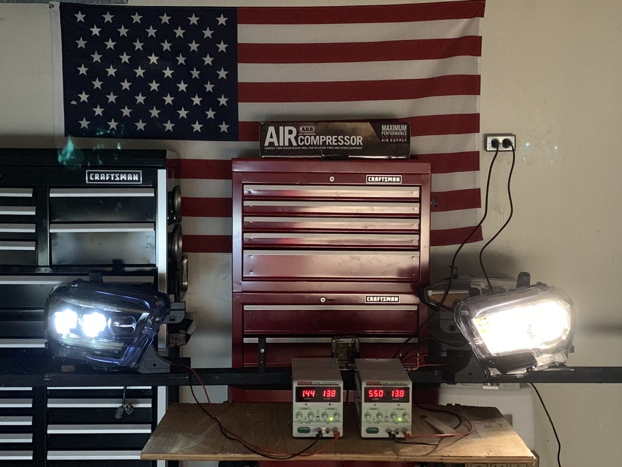

    Morimoto XB LED Headlights - 3rd Gen Tacoma
    Finally a proper full replacement SAE LED headlight for the Tacoma. To correctly run LED lights, the light assembly needs to be designed for an LED light source. Projected light is a system where the light source and light assembly must be designed to work together. Placing replacement LEDs in the halogen projector like the 3rd Gen Tacoma causes the distance projection to be lost. These long anticipated headlights are exciting because finally there is an off the shelf product that is designed from the ground up as an SAE LED headlight, meaning the light source and light assembly are properly designed from the beginning to work together for proper performance.
    At a current MSRP of $1250, these are not inexpensive. While they certainly look awesome and the build quality appears great, this post will focus on what your hard earned money is buying you in terms of projected lighting performance.
    Morimoto Low Beams
    Power draw (cold)
    Morimoto left: ~20.2w
    Stock wattage GE +120 right: ~58.9w
    For the low beam testing, the LEDs were tested warm after 20+ minutes of runtime, as LEDs warm up their output goes down. It is ideal to test their warm stable output to get real world numbers. After 20+ minutes of runtime the LED low beam reduced power consumption to 14.2A, or about 19.6w, which is about a 3% loss, which is pretty good for a passively cooled LED. Meaning each low beam projector is about 0.71A or roughly a 10w LED.
    Output comparisons
    Lux comparisons measured at 18'
    Stock H11 Osrams: 623 lux vs Morimoto: 1413 lux
    Impressive 2.27x lux improvement over stock. The Morimoto beam doesn't have quite as saturated of a beam down low, but the more critical area is up near the cut off for distance projection. Compared to the stock halogen projectors, the Morimoto projector cut offs provide a much cleaner cut off and include a right side step like HID projectors to minimize glare to oncoming drivers.
    Color temp is about 6000k. Light quality (CRI, hows accurately the light shows color) is about average for an LED headlight at 71 CRI.
    Unlike the OEM halogen headlights with a single low beam projector and a high beam reflector, the Morimotos feature 2 low beam projectors and a single high beam projector. One projector contains the stepped cut off, while the other low beam projector has a flat cut off. Covering the stepped projector shows a flat cut off on the other low beam projector.
    An obvious question would be how do the Morimotos compare to running a basic bulb upgrade such as >$20 Philips H9 low beam bulb swap.
    Lux measured at 18'
    Philips H9 low beam: 1294 lux vs Morimoto: 1413 lux
    The Morimotos put down higher lux numbers than the H9s, by about 9.2%. Replacement LED headlight bulbs performance issues are often masked by short range testing, with these being a vastly superior product designed from the ground up for LEDs, how does the distance projection compare?
    Lux measurements at 42'
    Philips H9 low beam: 256 lux vs Morimoto: 265 lux
    Morimoto comes out with slightly higher lux readings by 3.5% compared to running the Philips H9. (Stock lux comparisons in chart below). However, the lux reading doesn't tell the whole story. The Morimoto uses dual low beam projectors, giving 2 points of focus. At shorter range the focus points coincide more giving greater intensity. At longer range these focus points have a small degree of vertical offset, meaning the 'hot spot' effectively becomes where the focus points overlap at the cut off of the lower focus point, to create the brightest part in the beam. If you look at the above photo carefully you can see the 2nd lower focus point cut off, approximately the middle of the 2nd panel up on the right. While the peak lux on the halogens was at the top of the beam at the cut off, the peak lux on the Morimotos was at this lower 2nd cut off, not at the top of the beam. This is important because for maximum distance visibility and projection, the brightest point needs to be at the top of the beam pattern, at the main cut off. Recall that the Morimoto lower beam area was not as saturated in the short distance wall shot, I'd speculate this was done to provide a slightly fuller beam pattern but in doing so compromised locating the hot spot at the top of the beam pattern. With only 2 projectors it doesn't leave many options, compared to using many projectors on some OEM LED headlights where you could double up focus points in the critical projection area while using others to spread the pattern.
    Comparing distance projection:
    (Note: plotted 42' lux for Morimotos is at lower cut off as described above)
    'DD LED' is Diode Dynamics LED, to compare drop in LED performance to full replacement LED assemblies.
    While the peak beam intensity is a little low in the beam pattern for optimal performance, these are by far the best LED low beam I've seen so far for a Tacoma and a huge upgrade over stock.
    Raw data
    So the low beams are a big improvement over stock, what about the high beams?
    The stock 3rd Gen high beams run a Philips H9 in a reflector housing, the Morimotos are using an LED projector. Larger reflectors are more efficient in distributing and projecting light than a projector, which is why many vehicles that use projector headlights still use reflectors for the high beam.
    Stock high beam w/ Philips H9 low beam (left light only)
    High beam hot spot: 2425 lux
    The low beam cut off is aligned with the top of the 2nd door panel. The stock H9 floods the area with enough light distribution and intensity the cut off is no longer distinguishable. The high beam reflector very effectively illuminates a huge area but it also focuses a 2nd hot spot above the low beam hot spot for extended distance projection. You can see in the above photo if you look closely the blue ridge of the low beam cut off, and then the high beam hot spot above it.
    Morimoto XB High Beam (right light only)
    High beam hot spot: 2043 lux
    For low beam, the tests were run after 20+ minutes of warm up time for stable output. For high beam the tests were run within a few minutes of turning them on, as most don't typically leave high beams on for long extended periods.
    Morimoto combined high and low beam output draw
    With the low beams drawing 1.4A, the combined high and low output draw is 2.1A, meaning 2.1-1.4=0.7A or ~10w. The high beam projector is the same power as a single low beam projector. In the 3rd Gen halogen headlight, the high beam has ~2x the lumen output of the low beam. In the Morimoto XBs, the high beam has 1/2 the output of the low beam.
    Despite having comparable low beam intensities when running the Philips H9 in the low beam, the stock high beam washes out the cut off with a flood of light whereas the Morimotos do not produce nearly that same flood. Instead there is a smaller targeted region above the cut off. The elevated hot spot for extended distance projection is still present meaning they will still perform that critical function though the numbers are noticeably lower than stock, but the flood function of the high beam is significantly altered and will not provide the same wide area illumination. Projectors do not produce flood light as well as reflectors, nor are they as efficient. The stock Tacoma Philips H9 high beam is a 75w H9, which is the maximum legal output for a 65w H9 bulb. Legal output specifies a range of +/-15%, and Philips (the stock bulb) has it maxed out at +15%. A 10w LED in a high beam projector is not going to matching the performance of the stock 75w (65w) H9 in a more efficient high beam reflector.
    The Morimoto XBs are certainly a big improvement over the stock low beams, but they do sacrifice a lower performing high beam compared to stock. Aux lights could certainly fill the high beam performance gap. These won't match the output of HIDs, but these are plug and play without having to hassle with a proper retrofit or dealing with bouncing issues of HIDs in the halogen projector and come with a 5 year warranty. SAE compliant products are significantly more challenging and time consuming to build than lighting products that do not meet any compliance standard, it is great to see a company take interest in building SAE compliant lighting products and tackle the challenge of providing a real LED replacement headlight for the Tacoma.
    My post is purely focused on the lighting performance of these new headlights. To see install pictures, DRL function and other info see @MESO review here.
