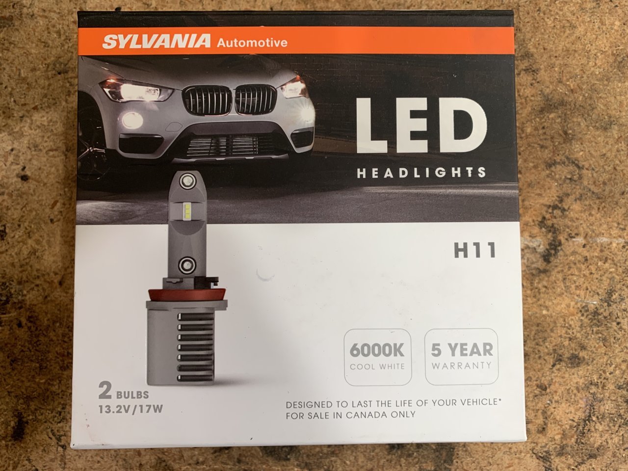

    I’ll test these out soon, though I’m not optimistic on the performance results.

    Looking forward to it. Love my LED's. I believe mine are 25 watt per bulb and not 17 though but nonetheless

    No big expectation with it. Used it in my wife's Sienna 2yrs ago for a month, and went back to the Osram night breakers that was in there previously . Lack of throw was the biggest problem. Also noticed a bit of V shape dark spot on the beam pattern on the ground. Happy with the GE+130 in the van now. going to try the Philips H9 when the bulbs go.

    I am using the Sylvania fog light versions of these in my wife's QX70 and they are pretty good. The color complements the D2S CBI's well.

    Cross section width is more important than wattage and lumen output for projected output.
    Standard LED problems. The Philips H9s or the GE +120s are both higher performing than the GE +130s.
