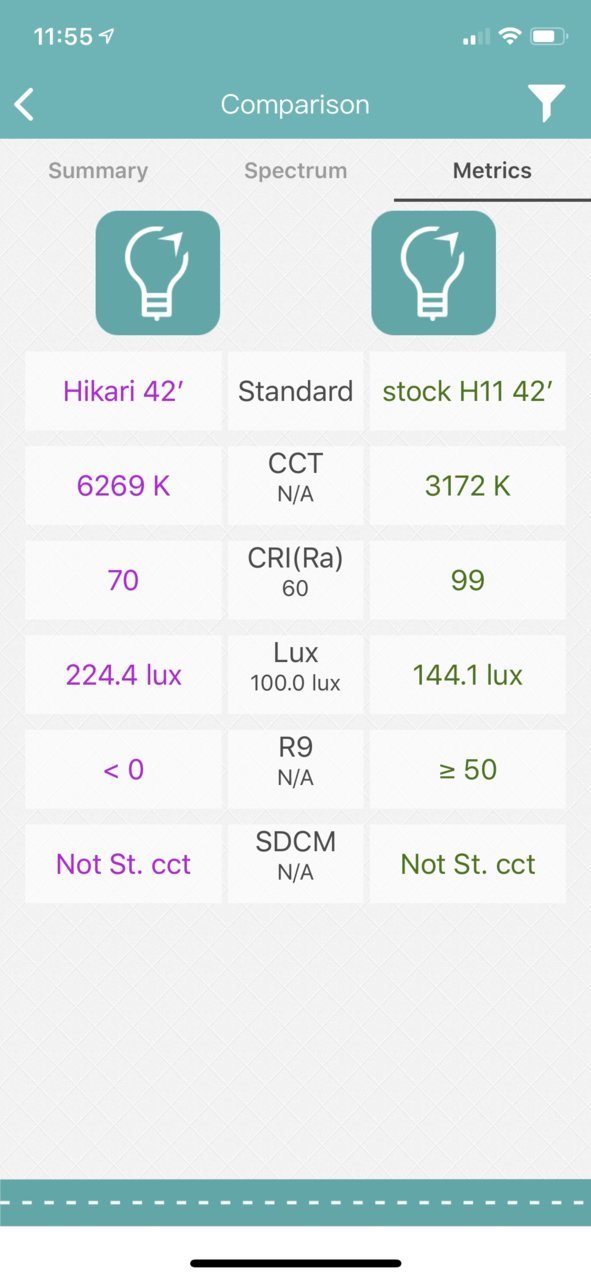

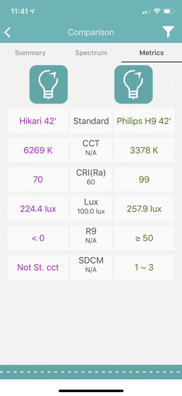

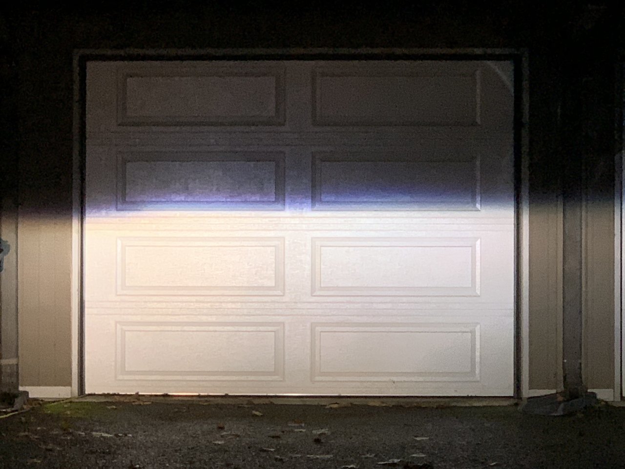

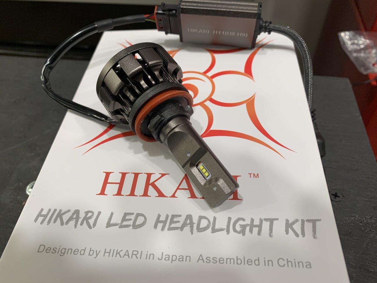

    Go Hawks!
    Hikari Ultra "Eyes of Megatron" H11/H9 LEDs
    Amazon link here.
    The name and advertising admittedly sounds questionable on these LEDs. The advertising is full of way overpromised performance, as is typical many off brand LEDs, with claims like "12,000 lumens!" and "270% brighter!". The product info page reads like a bad Chinese translation. However these are the thinnest drop in LEDs I have tested. And that is important because the thinner the distance between LED emitter faces, the better the focus (which is a weak point for LEDs). And better focus leads to better performance.
    Still not quiet as thin as the OEM halogen, but closer.
    An interesting trait on these LEDs is how they use more girth/mass under the LED emitters, and keep the design thinner over the emitters. Below the light source is not utilized much in a low beam pattern, and in the projector all that light is blocked out by the internal light shield. So by optimizing the top of the LED unit to be thinner, they have optimized the light distribution for better low beam output.
    These are actively cooled (aka fan powered). Some designs that are a bit more cleaver like Diode Dynamics work with convection to have fans blow upward over heat sinks to carry heat away more efficiently, though at the expense of added bulk. These use the traditional rear facing fan. The fans are noisy. Likely not an issue with the truck running, but I am pretty sure you'll notice them with the truck off.
    So how do they perform?
    Better than I expected. 42' distance test shot against the Philips H9.
    Philips H9 vs Hikari LED at 42'
    Looking at the output measurements, the Hikari numbers look impressive for an LED.
    The halogens maintain a bit of a better recognizable hotspot than the Hikari's, and the halogen peak beam intensity is up near the cut off, vs the Hikari where it is a little lower. The peak beam intensity should be up near the cut off to carry the projection as far as possible. But over all very impressive performance for an LED.
    Compared to stock these are a significant upgrade, a bit over 50% greater lux at 42'.
    Stock 42' vs Hikari 42'

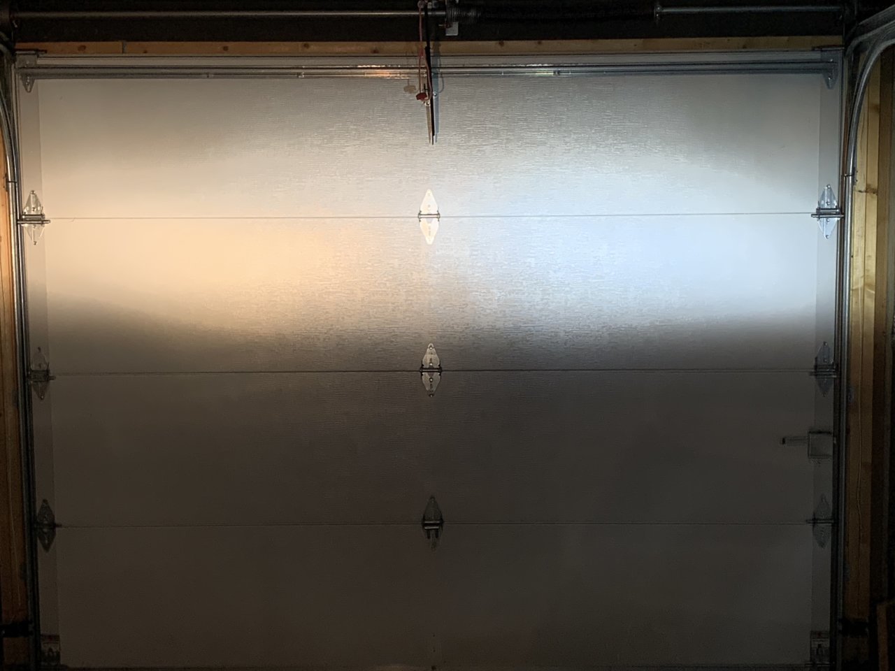

    This of course begs the question, how do they do in the high beam? Here are short range (18') pattern shots using the Hikari's in the high beam with the low beams turned off.
    Stock Philips H9 vs Hikari LED high beam.
    The LED pattern is a bit more filled out than the halogen that has a hotter area lower in the beam. But that isn't unintentional. The lower hotter spot in the halogen high beam is to project the beam maximum forward distance for down road distance vision while also giving a wider area illumination. The LED pattern has lost this defined hotspot trait and is more of a uniform light spread. I did some 42' distance testing for high beam, and the Hikari's put down better peak numbers by roughly 20%. However it wasn't easy to tell exactly where that was relative in the beam and I suspect it is higher, for example a 20% increase in light aimed up 5 degrees isn't going to be beneficial to help you see further down the road. Brighter yes, but you also want that brighter applied to where you need it to go for it to be true effective. Unfortunately it began to rain so I packed up my gear to bring it inside.
