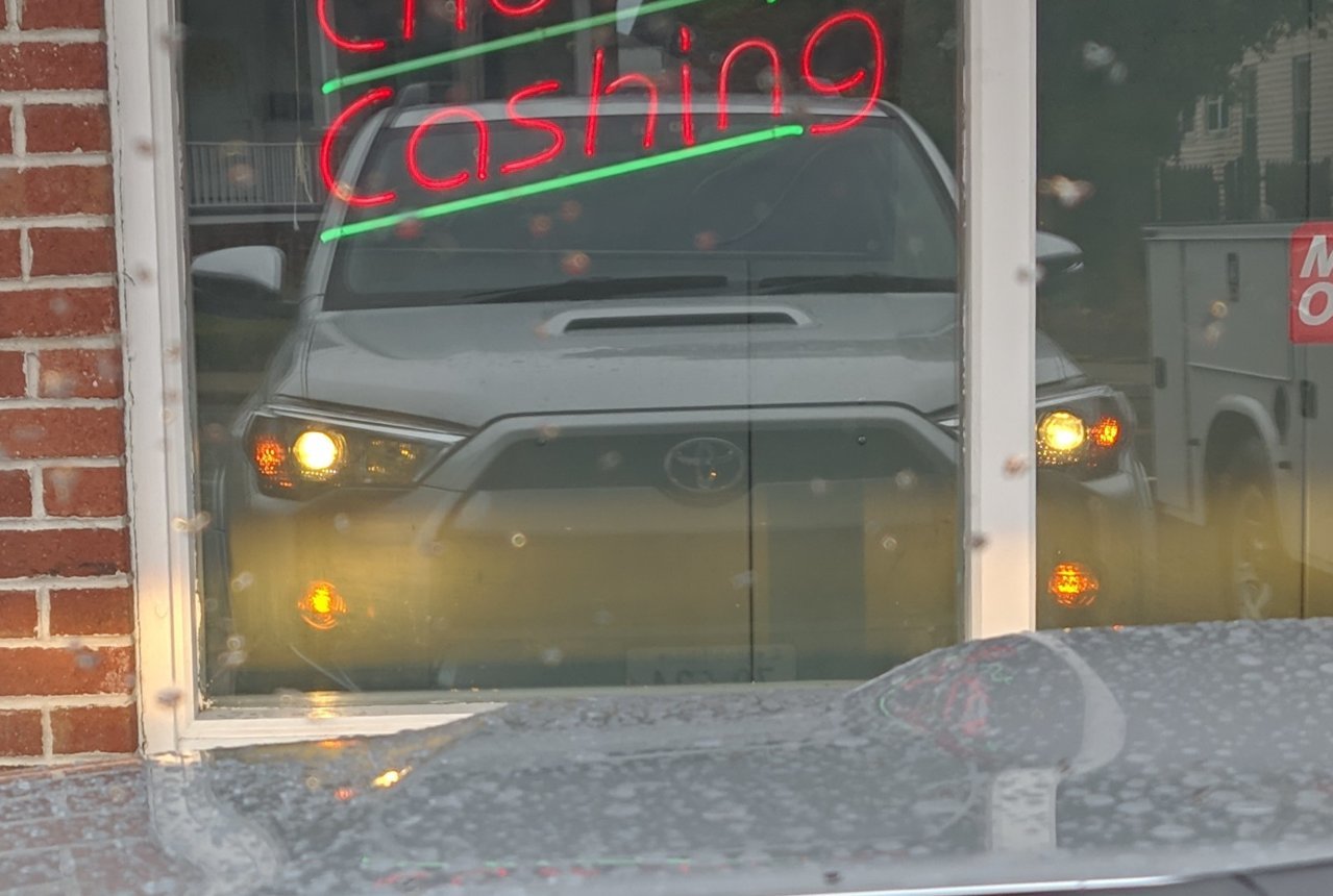

    replica9000
    replica9000 Death to AI!
    Apr 6, 2008
    #5782
    16,447
    Lake Chargoggagoggmanchauggagoggchaubunagungamaugg
    2019 T4R ORP
    Reflection of my Nokya Hyper yellow H9s and Amber Morimoto fogs.
    crashnburn80[OP] likes this.
