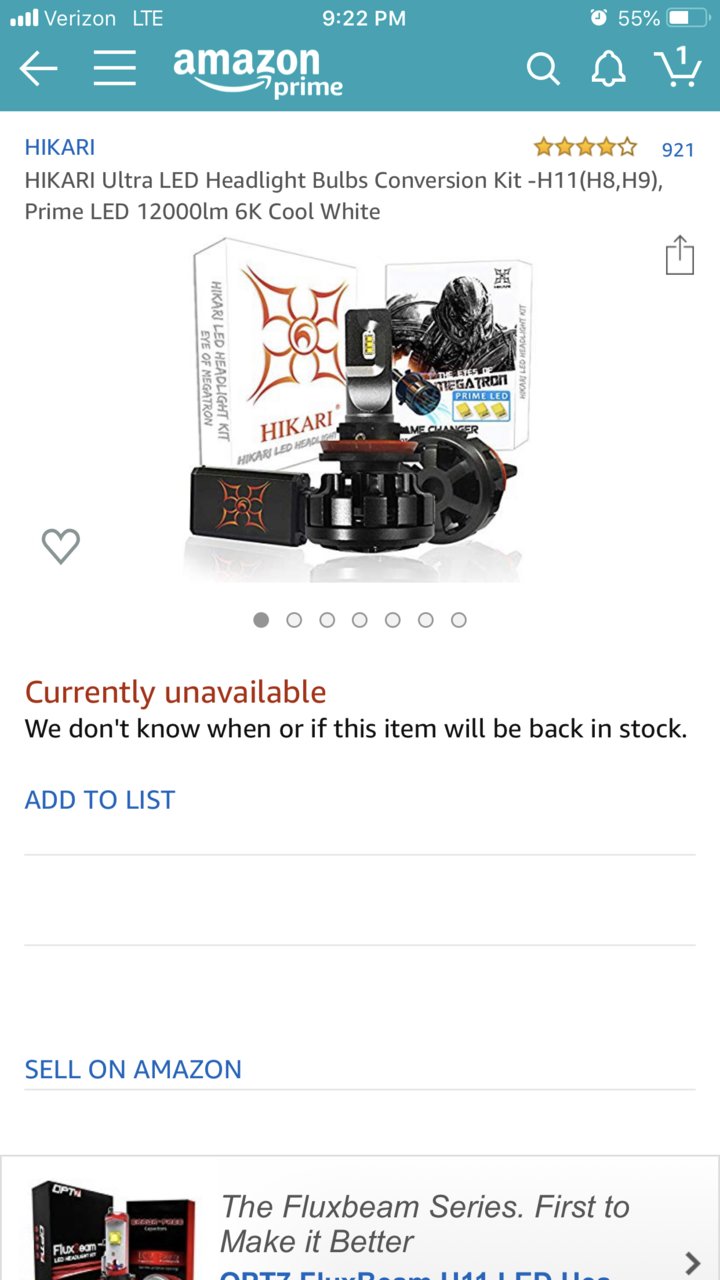

  9. Oct 14, 2019 at 5:08 AM
    #1629
    crashnburn80
    crashnburn80 [OP] Vehicle Design Engineer
    Jun 6, 2015
    #156893
    14,772
    Kirkland, WA
    2003 DCSB TRD OR
    Pretty standard. Happens almost 100% of the time I give a positive review on a lighting product.
    TW influenced buying on Amazon has even led to the reclassification of bulbs in the case of my gy6.35 HIR reverse thread, causing a landscaping bulb to be reclassified as an automotive bulb, which it is not.
