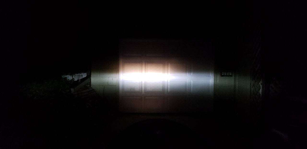

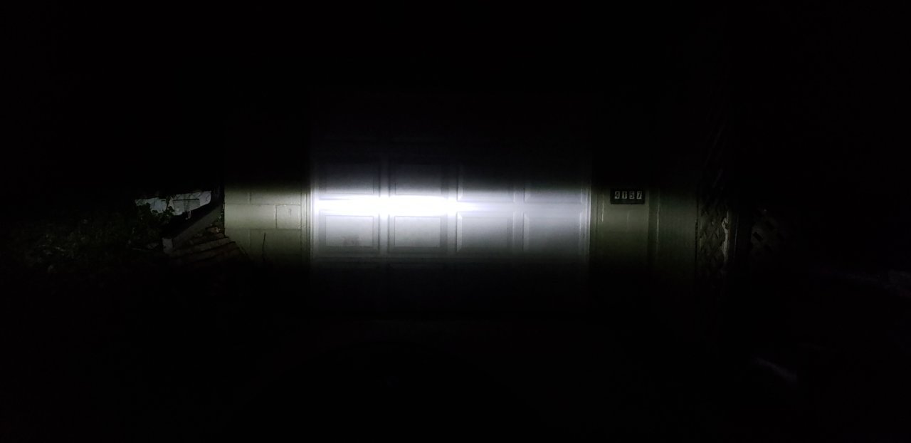

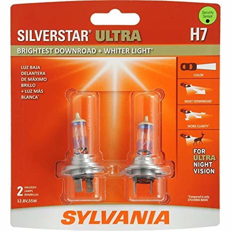

    An update on my Nineo g2 LEDs in my bike: I ended up only doing the low beam. Between the cramped working area, and the fact that the heatsinks impinge on the space the bulb clips take up, it was just too much hassle to do both. I had to dremel out several notches on the heatsinks to clear the bulb clips. I put a Silverstar Ultra in the high beam. So, what are my thoughts on the LED in a reflector? *gasp*.... They are phenomenal. My assumption was correct. Some reflectors are better than others at how well they hide glare. Also, the beam may not be as focused as it could be, but it's still really fucking good. My buddy has a CBR1000 with HIDs, and my light completely washes his out. He had no complaints about my lights when he was riding in front of me, either, which I kinda figured since I could see that I wasn't lighting his mirrors at all. Even in the city lights, I can clearly see my cutoff where it terminates into the ground well ahead of me. It may not be the most focused the beam can be, but it's focused enough to get the job done. Similar to the Hikaris in my taco, though, there is very little up light to light signs. The IS a ton of peripheral light to light up the sidewalks and ditches, which is great when on a bike. Despite the fact that the glare isn't as bad as I expected, my bike is still very visible from the front. The LED really helps to distinguish my headlight from other traffic, as opposed to the blue LEDs it had, which had I had to have on high beam just to be seen at all.
    The Silverstar Ultra on the other hand is a bit disappointing. I thought it was supposed to be one of the brighter halogens, but I can barely tell it's even on when there are streetlights. If not for the fact that it lights signs better than the LED low beam, I dont thing I'd be able to tell it's on. That's partially because it's aimed higher, and has a color that's more easily washed out by halogen street lights. However, I think its also because it just doesn't put out as much light as the LED. I'm still very happy with the current setup, as having both bulb types, i feel, will give me much better overall lighting and visibility. I just expected the halogen to be a bit brighter down the road.

    As covered in detail in the original post, Silverstars are terrible and perform lower than stock. Blue coating kills output. Output claims on those products are typically based on color temperature not actual lumen output, complete marketing BS.

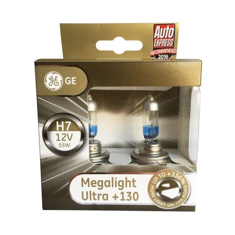

    I dont go by packaging or manufacturer claims. I was basing my choice on the bulbfacts chart (I know I know. Ugh, bulbfacts...). I know that having a filter on the bulb cuts output (I do know how light filters work, believe it or not). However, the filter on the H7 silverstar ultra is very light, and leaves the center open where most of the light is coming from. If you tested these bulbs, I'd be very interested in seeing the results. I did a search to see if you did in hopes of getting results from someone other than bulbfacts, but I didn't see any. For reference, here's the filter on that bulb compared to the GE. It coveres more bulb, but is significantly lighter.

    I haven’t tried the later generations of Silverstars, though yes they have made improvements in reducing their coatings.
    If you are using H7, then I would look at the Osram Superbrights. 80w is handled by most automotive applications, unsure on the circuit on a bike. Check the high beam fuse rating before using:
    https://www.powerbulbs.com/us/product/osram-super-bright-premium-h7

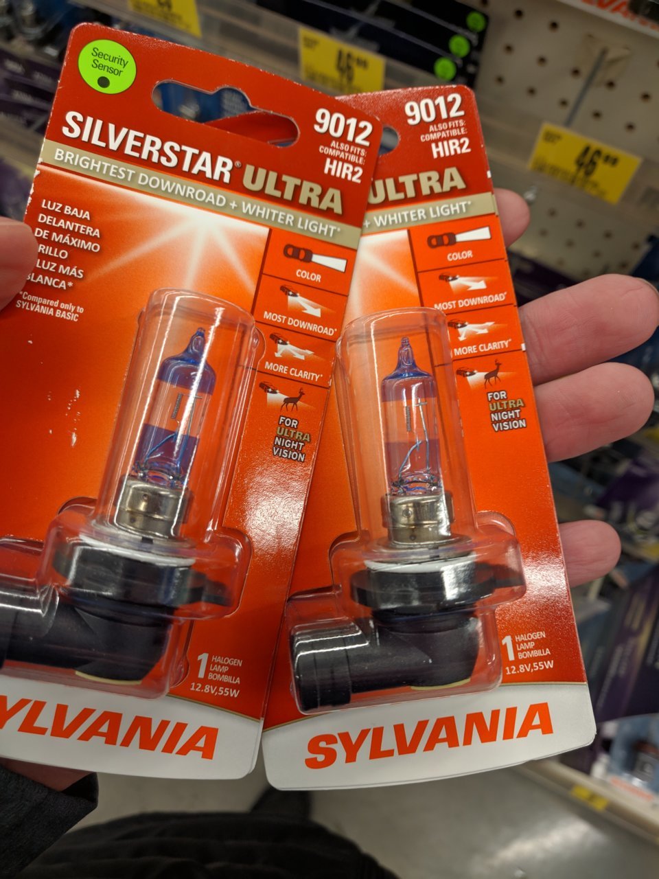

    Only on every other bulb it seems lol.

    Yikes. I dont remember any of the bulbs I saw looking that dark.
