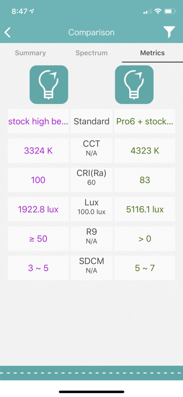

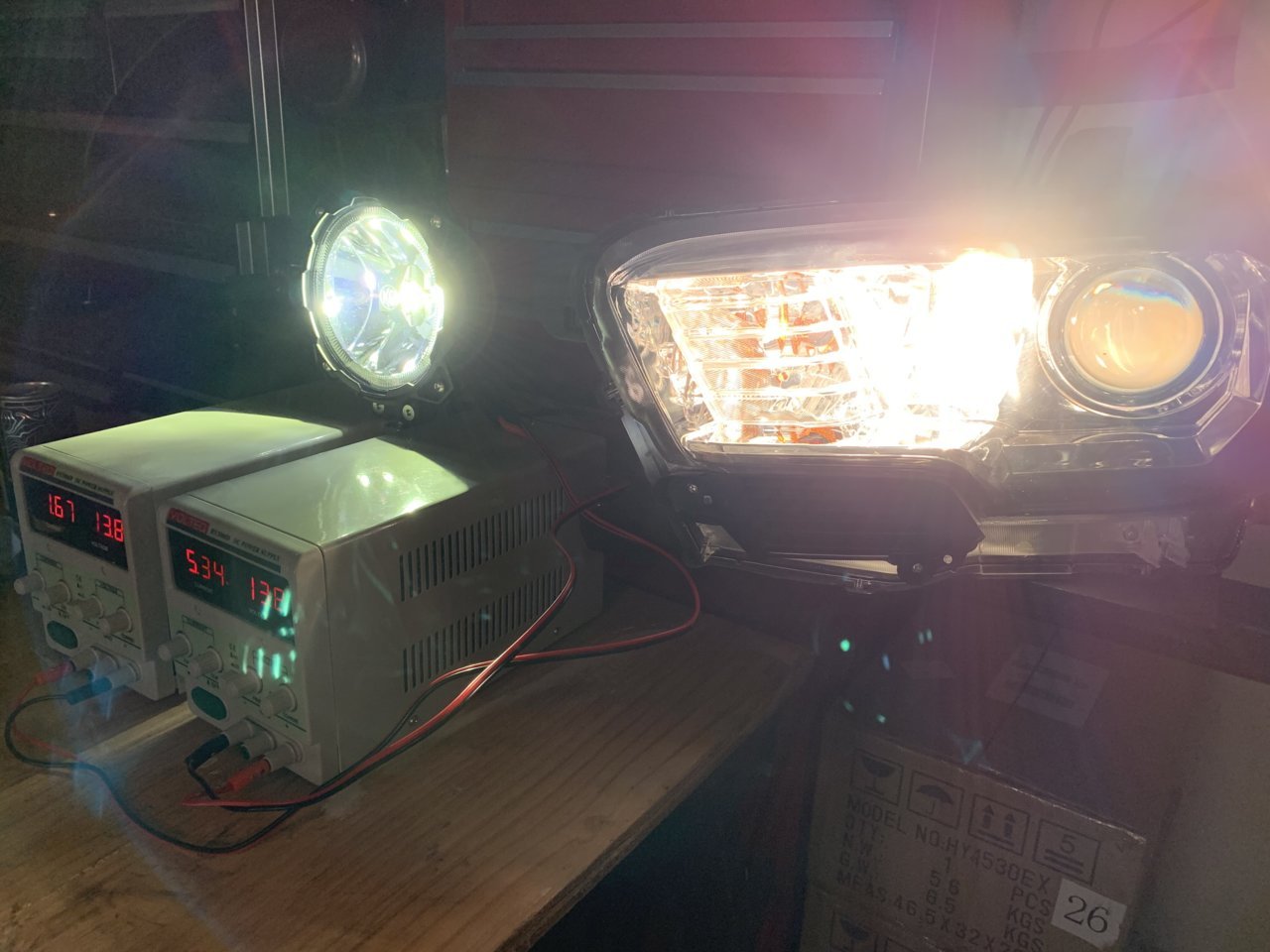

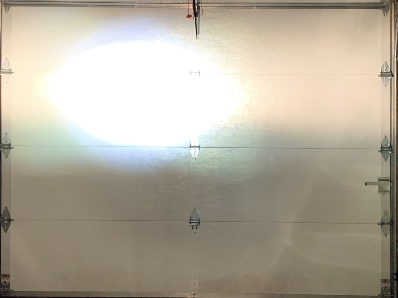

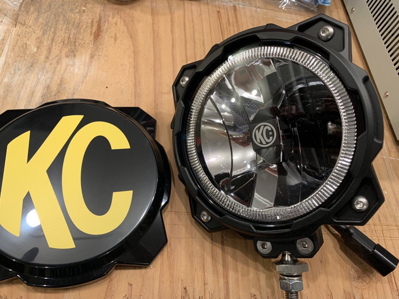

    This was just a quick and dirty test to see what these bring to the table.
    KC Pro6 SAE LED Driving lights
    Combined stock + Pro6 driving high beam (single light)
    High beam is inherently a bit more difficult to photograph. Toning down the saturation reduces the beam shape, higher saturation causes wash out.
    The Pro6 beam is wider than pictured, but the center of the beam (shown) is higher intensity for better distance projection. These lights have a best in class distance projection for an SAE driving light, better than competing 30” light bars. The pattern is more focused than the stock high beam.
    Comparison when adding to the stock high beam:
    Peak output intensity is increased by 166%. The KC color temp I measured at ~5150k, just slightly higher than the spec’d 5000k. The color temp reading above is lower as it is the combined high beam.
    The KC pattern control thanks to the reflector design is very evident when looking at the light, as it is no way offensive to look at if not directly in the beam pattern. Unlike a light bar that is just glaring and harsh to look at. The reflector design maximizes the effectiveness of the light source by having much greater focus and less wasted light causing it to be far more efficient in projecting distance compared to the forward facing LED light bar style products. This is another case where just looking at raw lumens or power is misleading in terms of lighting performance.
    Just don’t look at the light from within the beam pattern.
    Just waiting for my custom grill for vehicle based testing.

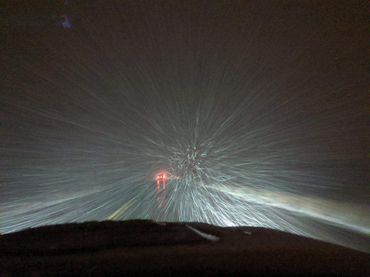

    Driving home last night in the upside-down world...I mean a poorly lit road in Colorado I quickly realized that my 5500k H11B Hybrid FastBright 35W/Morimoto HID headlight bulbs were not doing a very good job compared to the stock ones. They are great in all other driving conditions at night. I only have 7,800 miles on my 2018 and replaced my bulbs within the first 1,000 miles, so I guess I have not driven in the snow much with this truck compared to my 2015. I did not have this issue with the LED bulbs in my 2015 though. I had RSI 6500k LEDs in my 2015 and H11B Hybrid FastBright/Morimoto HID Kit in my 2018. Maybe time for a switch?
    It was snowing pretty good but not a blizzard by any means. My wife took this picture from the passenger seat.

    Phillips H9’s, at 3200k, cut through the snow without glare. Color temp and aim help. I didn’t care for the 4300k HIDs I ran for a month last winter either, too much glare in blowing snow.
    It could be you had no issues with the LED’s in your 2015 because they weren’t putting light evenly in the reflector, so the lack of glare was from parts of the reflector not being used.

    High color temperature light is definitely counterproductive in snowing environments, LEDs have the same issue as it is an effect of the color temp. Most LEDs in a reflector housing lack strong focus so the light is actually not as bright, which also means the light reflected back off the snow is not as bright. Or the snow you drove in before was dryer, so it was not as reflective. Difficult to say exactly why your experience was different, but the effect is due to light color and output intensity, so all things equal both technologies of similar colors will experience the same issue. Halogens are lower color temperature, so while the issue is still present, it is at a lower level and not nearly as distracting. That and they will do the best job in preventing icing on the lens for cold weather environments.

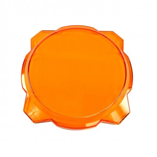

    Should be sweet. I’m going to test the Pro6 amber covers as well and see how they do for poor weather driving conditions.
    White LED + amber cover = yellow light.
