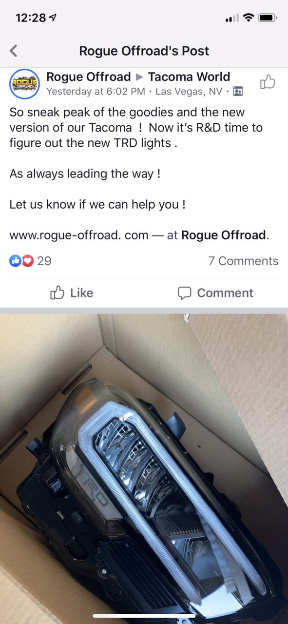

    I guess another good transition to a question for you @crashnburn80 how hard would it be to create a harness for the new LED OEM headlights? Word is that they aren't plug and play and no adapter has come to light yet similar to what the Tundra crowd did for plug and play LEDs.

    I have not looked at the back of the lights personally, so I cannot say for certain. But the key word there is yet, see this post earlier in the thread. Looks like Rouge may be working on it. TRS has done some work, but they also sell the number one competing product.

    Saw those are the margins may not be there for such a small albeit critical part of the assembly. I saw Meso has a pair up and running on his rig for SEMA but he went hard in the paint reworking and customizing those which probably wouldn't pertain to the casual consumer.

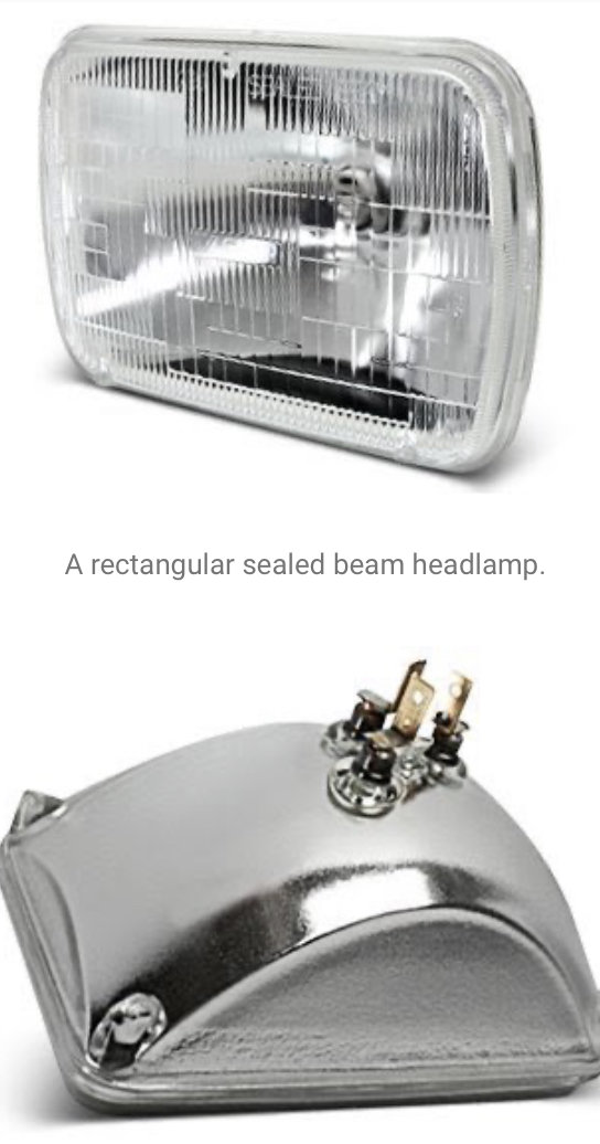

    I am going old school when my 2020 arrives
