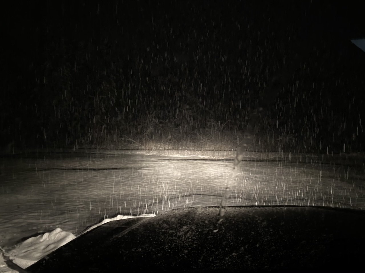

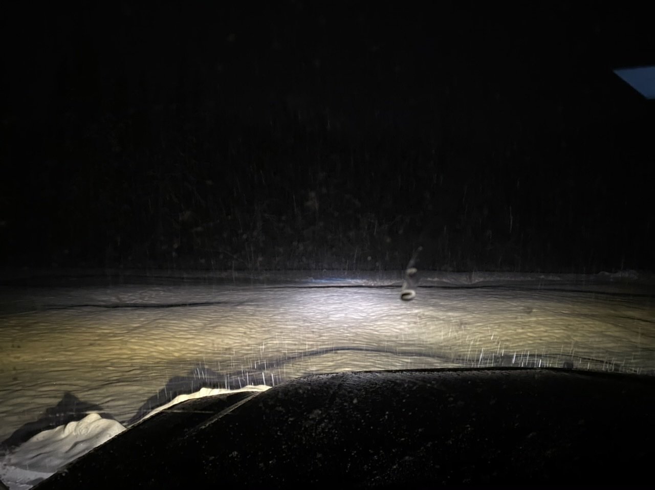

    Pro6 SAE aux high beam test
    Single Pro6 - 3104 lux
    Single Pro6 w/amber cover - 1840 lux
    With amber cover
    The yellow color is a very impressive true yellow which should perform very well in poor weather conditions, but at a 31% loss is a little harder on the output than I was hoping for. The Rigid selective yellow by comparison is a bit more green in color, but also has less filtration losses. It may be great if swapping lenses was easy, but since these are going behind the grill it won’t be.
    Edit for side-by-side pic. Tried to reduce the intensity in this photo to better capture color comparison.

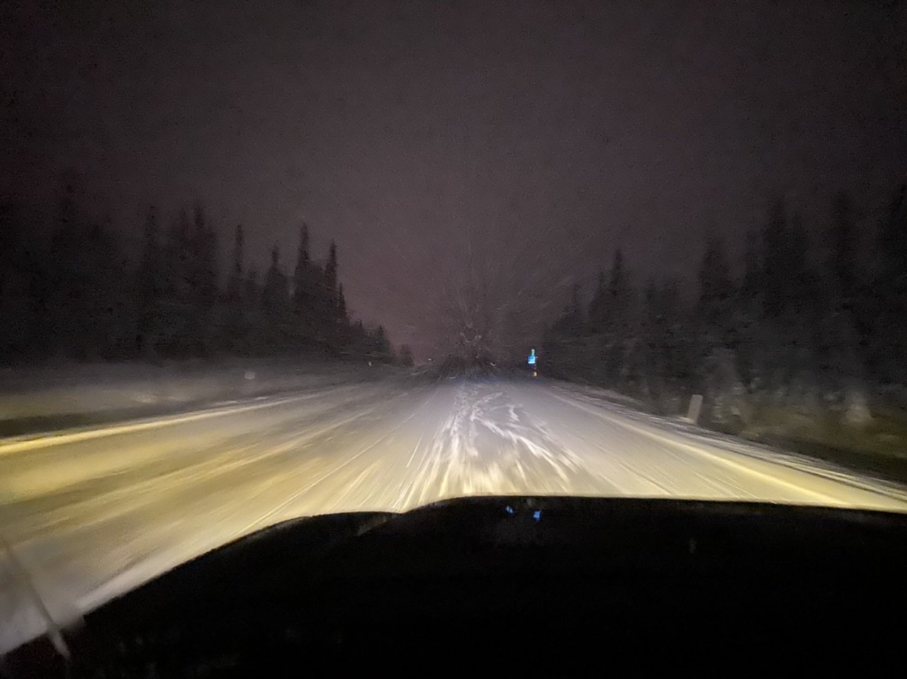

    I think the angle of the light is going to effect the amount of glare back with the driving lights more than the color.
    Leaving the house tonight to head to a wine tasting:
    Xencn H9 yellow fogs in TRD OR housings only
    Phillips h9 lows and fogs
    hella 700ff with 100w Hella h3
    Turning on the high beams is jumping to light speed!

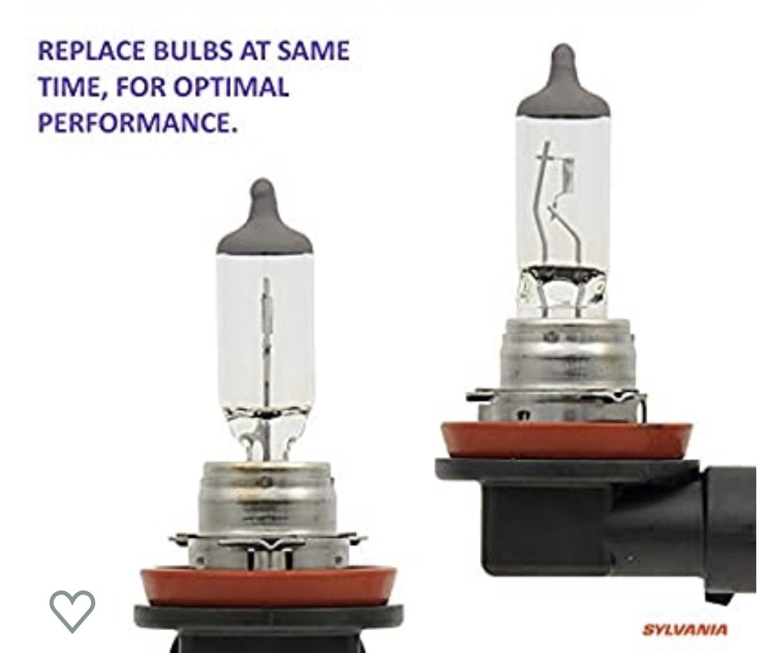

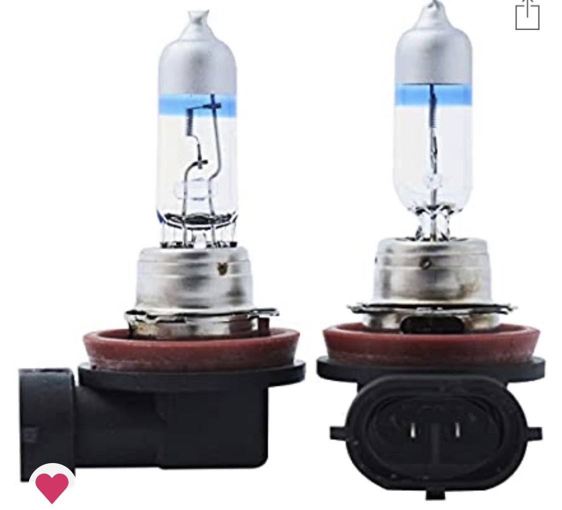

    I’ve been running the GE130’s for about 6 months. Much brighter than stock, obvs. But I wasn’t crazy about losing some of the light to the sides. It seemed really focused right down the middle.
    I was looking at the Sylvania Xtra vision H11’s this week and realized how much further down the glare cap goes on the GE’s.
    for comparison, here is the Sylvania...
    I installed the Sylvania and was pleasantly surprised by the regaining of the light to the sides. Overall, I like the Sylvania better for this reason.
    is the shorter glare cap the reason for the better light to the sides?
    also- WHY does the glare cap come so far down on the GE’s?

    Good observation on the GEs, I also think the GEs glare cap seems a bit aggressive. The primary reason for less light on the sides though is focus. The GEs do not create more light than stock, and may in fact produce slightly less as they consume less current than stock. The high efficiency bulbs are brighter by using a smaller light source to focus more of the light to the hot spot of the beam. Think of one of the old adjustable focus style Maglight flashlights. If you have a fixed amount of light being produced and you are placing more into the hotspot for higher intensity to extend the distance projection, you end up essentially taking it from the outer edges of the beam. The bulk of the output is reflected off the back of the projector bowl, so the extended glare cap does not interrupt as much of the the output as one might first think, though the extended cap doesn’t help. This is the benefit of the Philips H9 swap that isn’t reflected in hotspot lux, since the bulbs produce more light, not just higher intensity focus, you get greater output throughout the pattern vs shifting focus to the hotspot to get the higher intensity.
