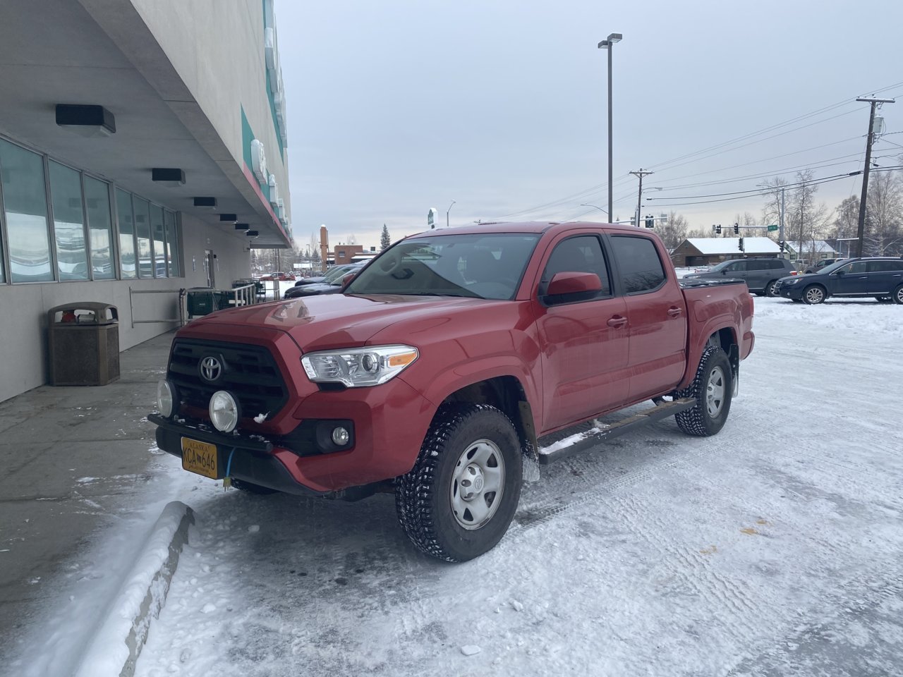

    And to add, I’m not against LED’s; I’m just in it for performance. I think it’s silly to be for or against any given technology. Halogens work better in our OE housings and are far more cost effective to upgrade. Even if I end up replacing H9’s yearly, that’s $14 per year for my low beams. That’s cheaper than even the cheapest blade style LED on Amazon, with much greater performance.

    It makes me cold just to look at those pictures. Brrr... :(
