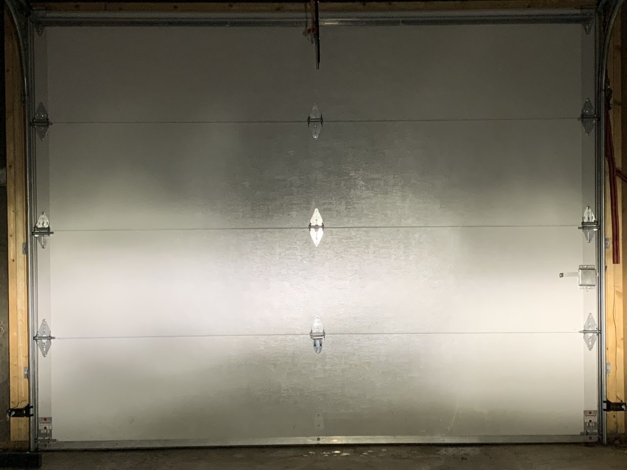

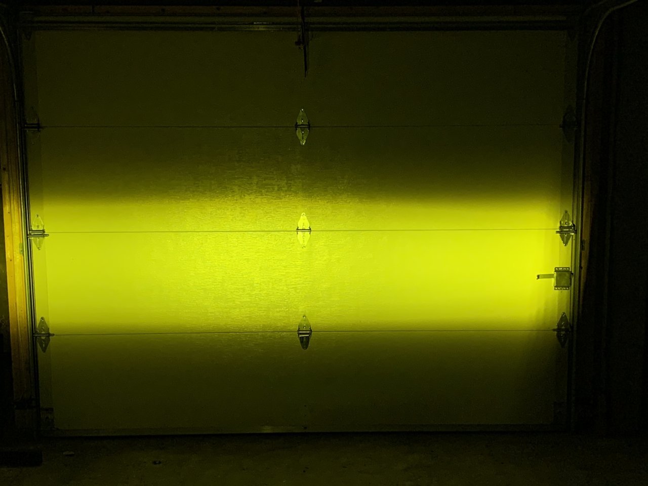

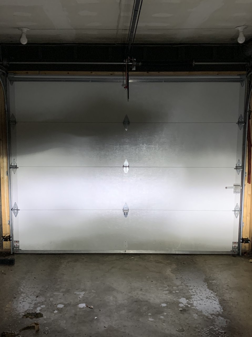

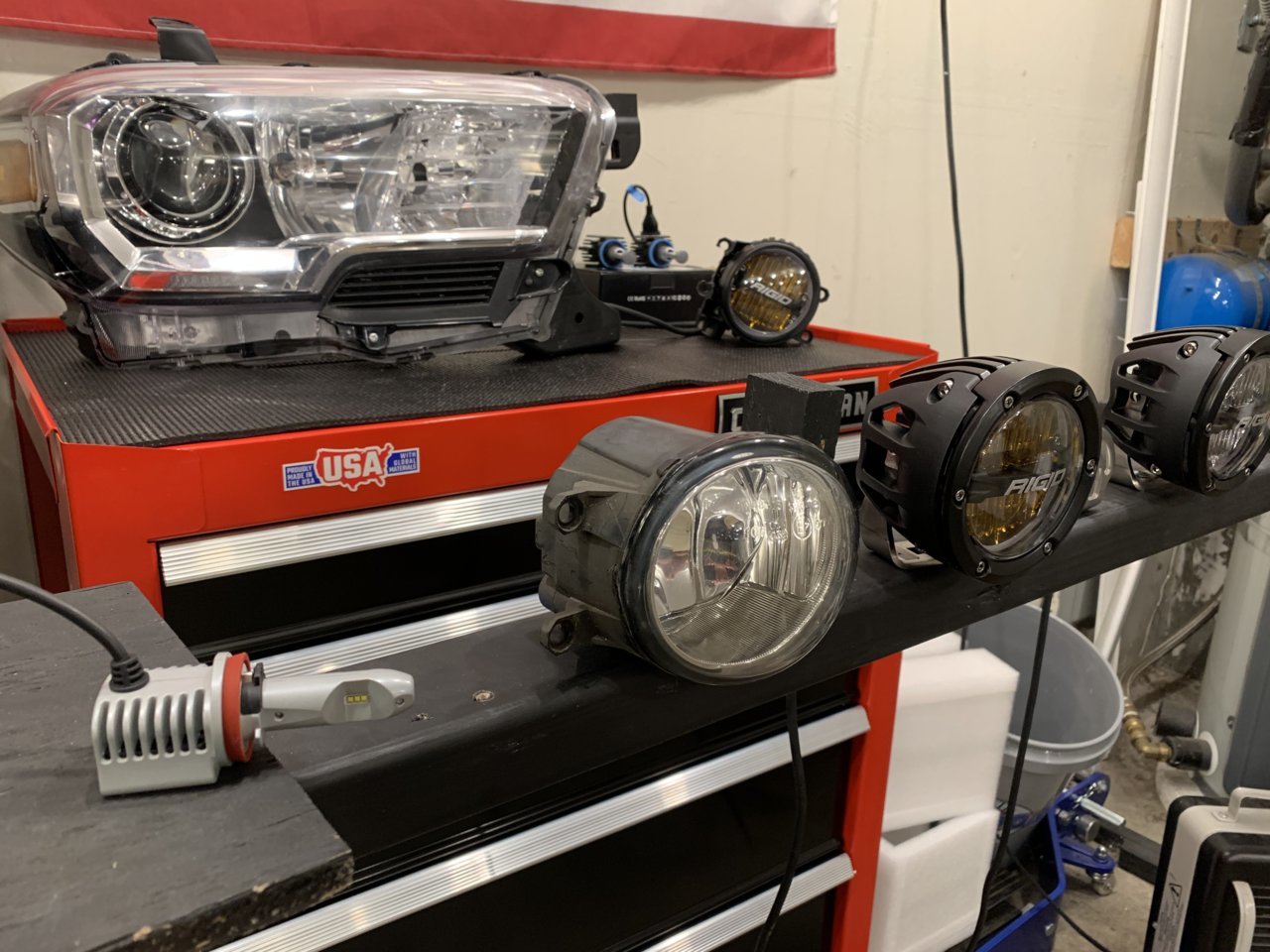

    I realize you are new. I have a lot of LEDs, I've probably run more lights and definitely have more measured light data than anyone on this forum. I agree opinions are of little value and facts are where it is at. Which is why I deal in facts.
    Osram H11 in TRD fogs:
    Osram H11 in TRD fog. As typical, poor beam pattern in a reflector with poor cut offs
    Placing my hand well above the cut off line, there should be no light here...
    Rigids SAE J583 selective yellow fogs. Higher output with sharp cut offs.
    The Osram drop in LEDs are not legal and cause excessive glare. The Rigid SAE J583 fogs are higher intensity and have no glare and are street legal. This isn't socialism legal vs illegal, this is a product that is designed from the ground up to have the correct beam pattern vs one that is not.
