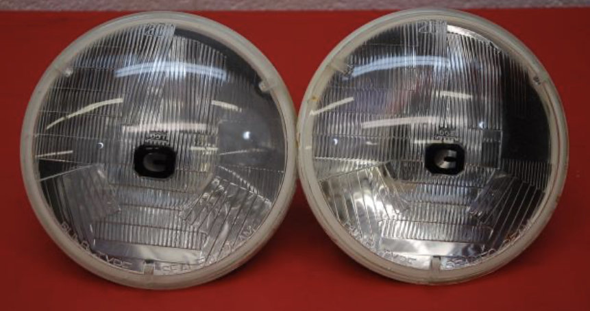

    Memories. I had Cibie Bobie’s on a new 1980 Z28

    I know @Too Stroked used to run classic Cibies back in the day as well.

    Never had the Bobi's but did have the Euro "Z" beams and also had the still relevant 5-1/4 inch H1 bulbed pencil beam high beams. Holy crap. Now there was a light where alignment made a huge difference. And still have the Bosch H4 German OEM Porsche 911 lights in my 911 until I get the time to retrofit the Hella Bi-LED v2 into those buckets. There's a several thousand dollar project and I will never ever put Morimoto in that car. It's a really tight fit with the Hellas but they are the best light available for that application.

    Yup, I was running Cibie Z Beams way back in 1978. I should have kept them when I sold the car. They're worth good money these days!

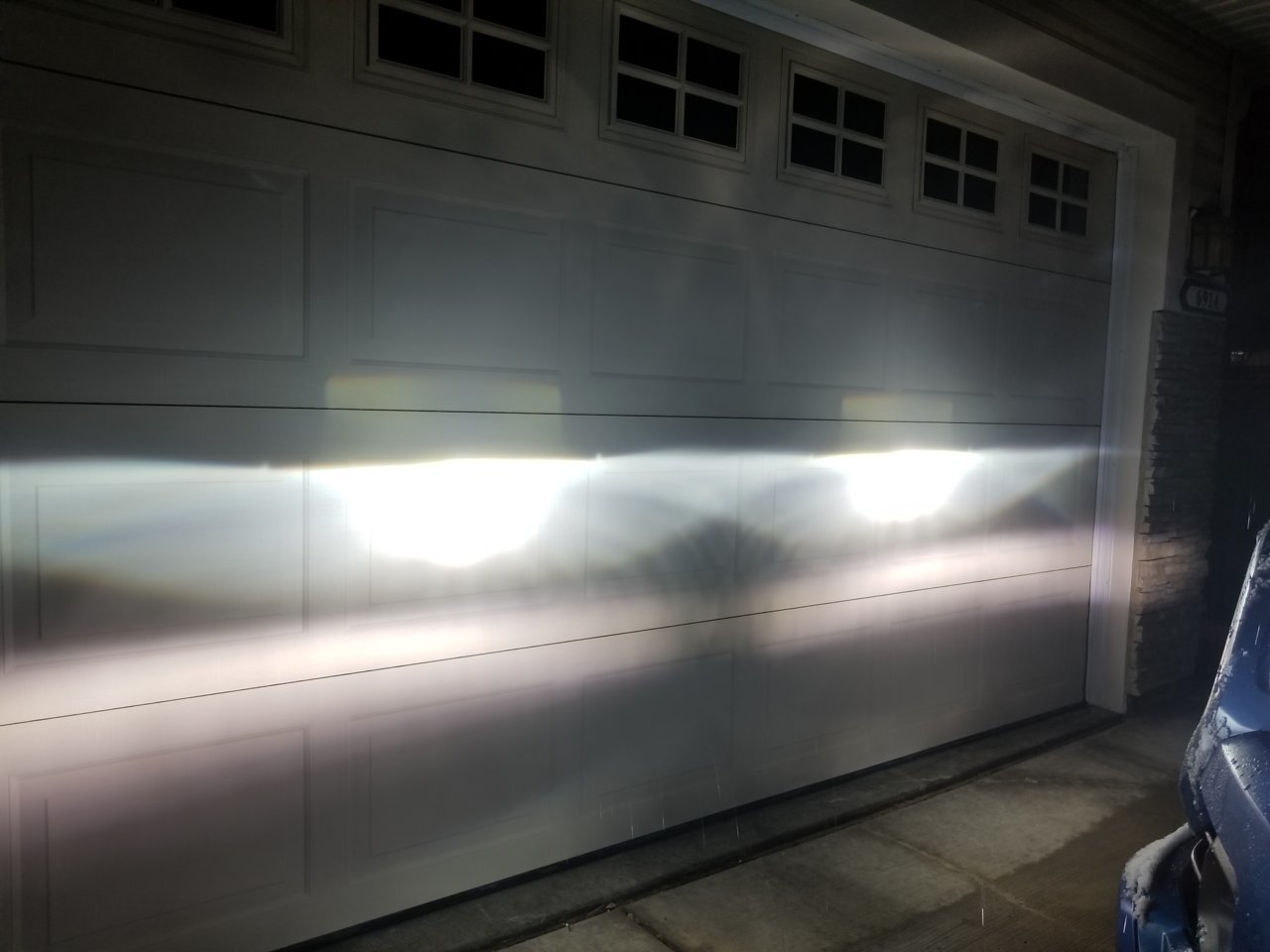

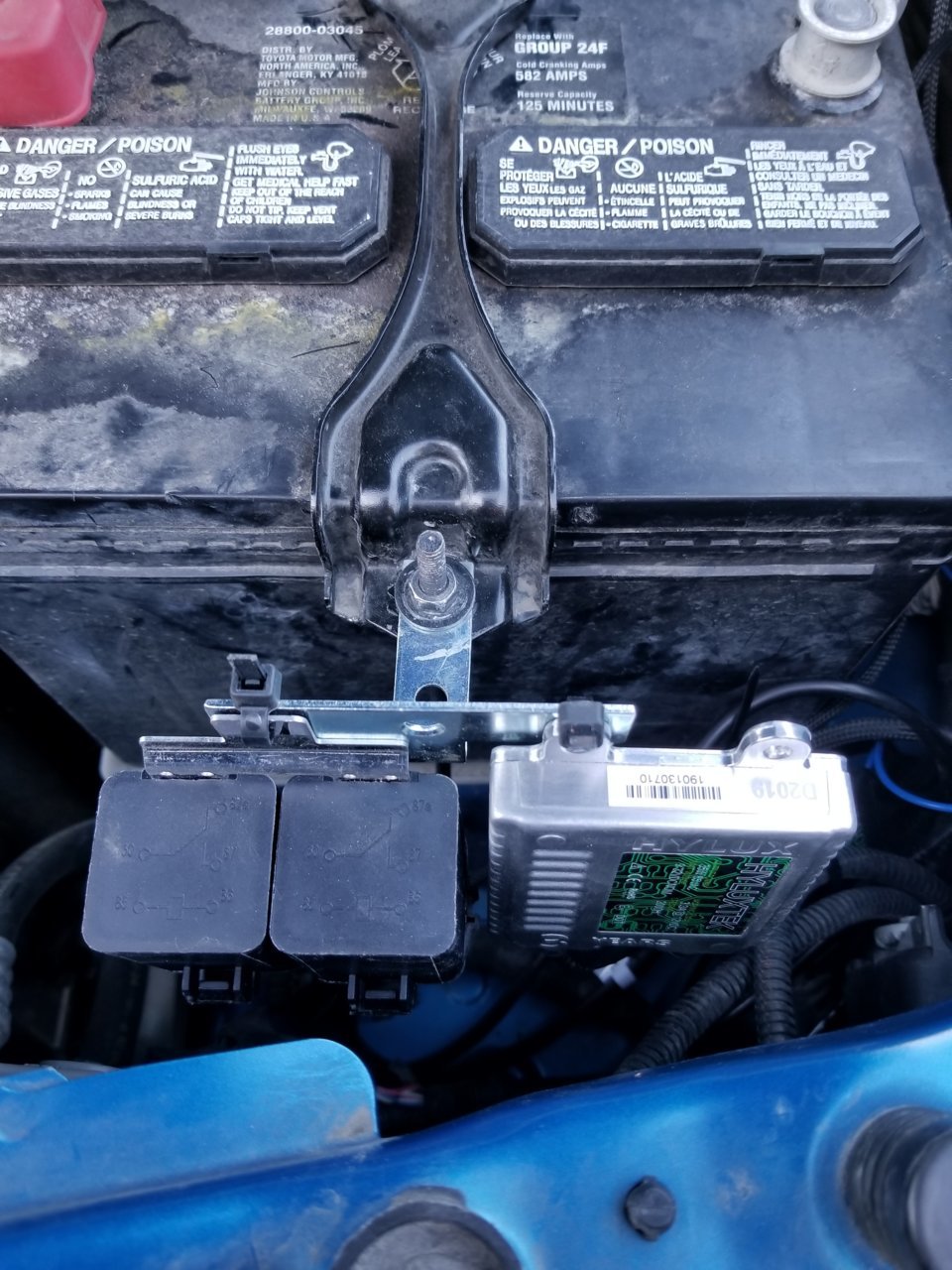

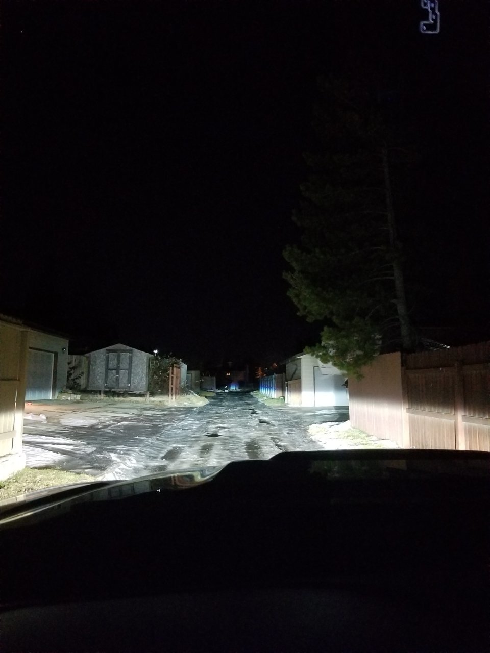

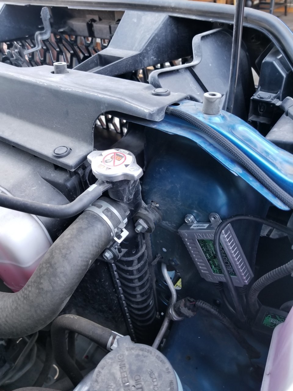

    Installed! Decided to go with the Hyluxtek 35W kit with Morimoto 5500k bulbs - and what a difference! I was previously running XD LEDs, and while I was initially impressed, the lack of throw became pretty evident when I was driving on country roads and there wasn't any ambient light (street lights etc).
    I was initially hesitant about the additional wiring, but honestly, the biggest concern isn't the installation, because everything is labelled pretty well and is essentially plug and play - making everything look nice and clean is the most time consuming part!
    I still worry about longterm reliability, I'm using the optional relay harness, but I still worry about a ballast or bulb going out at the wrong time (I'm kept my old halogens as a backup).
    If you decide to go with the 35w Hyluxtek kit from TRS, be warned they use an integrated Canbus error canceller, which also has be mounted or zip tied somewhere. Using a Canbus error canceller on a non-canbus vehicle hasn't caused any negative effects (yet).
    Honestly, LEDS look nice, but as @crashnburn80 has proved with data, the lack of focus and projection distance is a very real thing. My distance projection has improved by at least 2 - 3 times.
    **Drone shots comparing Leds and Hids to follow when it stops snowing**
