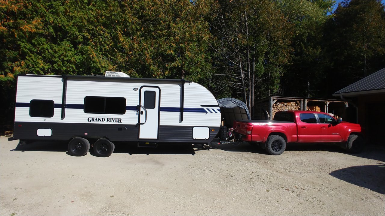

    I had some of these concerns recently too but figured it was worth a shot. I have a '16 TRD Sport 3.5l with tow package. Installed a Redarc tow pro and the Andersen weight distribution hitch (still needs some adjustment, sitting low in the picture). Yesterday we brought home a 25 foot dual axle camper that is 3900 pounds dry weight. Towed perfectly. I also have a Bluetooth OBD reader for temps and such and nothing was out of the ordinary while towing. I kept it in S up to 4th gear since there is no way 5th would actually hold for any amount of time. I used exactly double the fuel on the trip vs normal driving. As long as you don't try to be the fastest on the highway, a Tacoma is decent for towing. My drive included a fairly steep climb 2km long and it pulled in 3rd with no problem.

    @Northern41 that's a longer trailer than I expected you could tow, but light for its size. Cool that you feel it handles it fine and no Temps got out of normal range.
    Definitely you can't be the king of road towing. I always even with the pop up stay at the 65 mph speed limit around here or just stay at 65 or under if the speed limits are 70 or there's incline to climb.

    It might be a struggle with some wind but the way I look at it, we are not in a rush to get anywhere when towing. Fuel mileage is garbage either way so if it gets worse, oh well. We are in a good place where there are some great campgrounds only a few hours away so we are not driving full days.
    I'll try to remember to update after our first trip if there are any other issues.

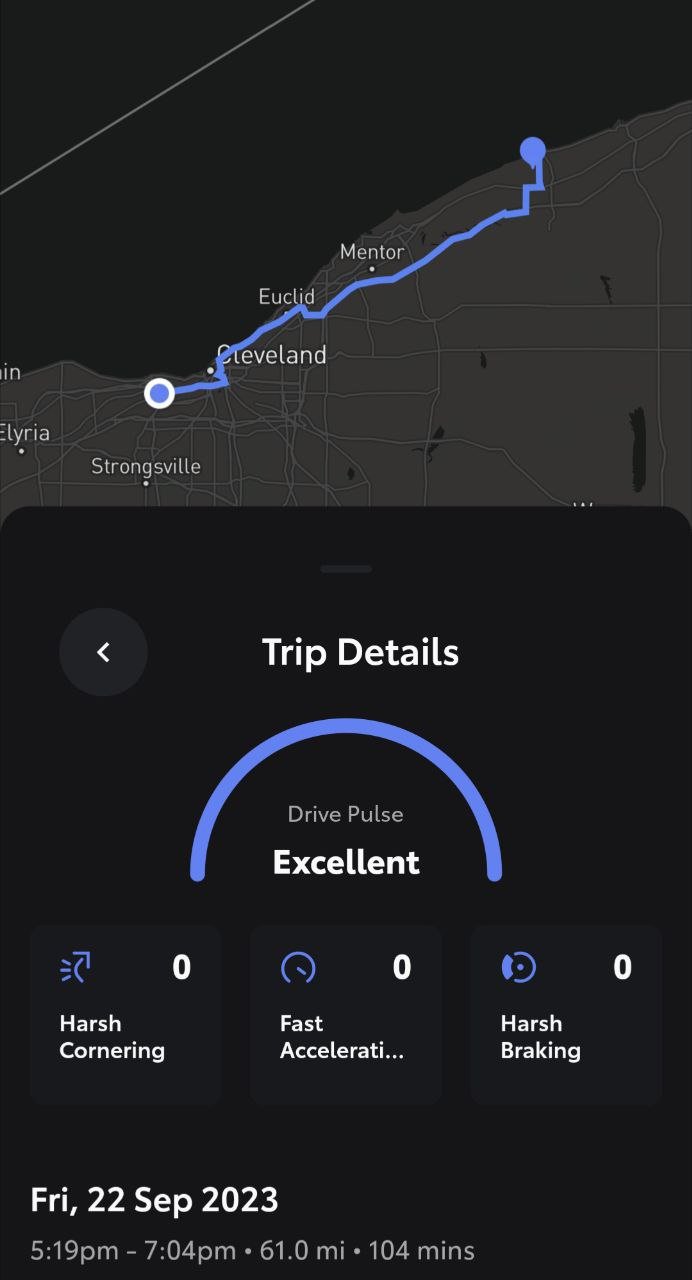

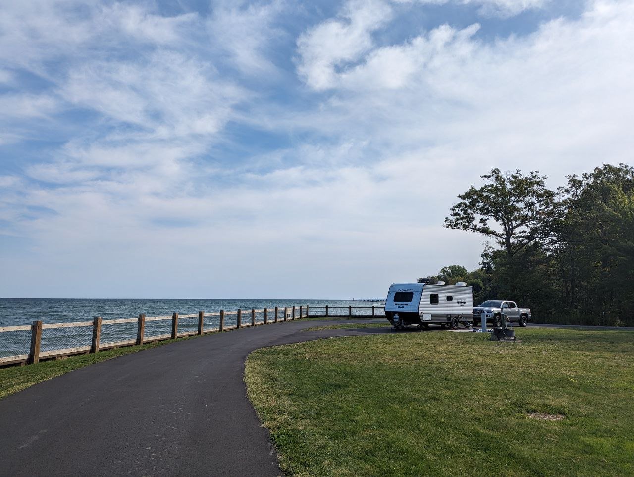

    so had a good headwind the whole time on Friday. I barely felt the trailer there other than the normal porpoising that you have when you tow anything.
    It went really well. Ill be leaving for home in about 4 hours. There is going to be a 15-20 mph tail wind (maybe not when we get inland.) I did 60-65 mph and even the Toyota spyware app says I drove well. :) Felt much better than the Grand Caravan which was closer to it's limit. 10 mph but I think it is uphill pretty much the whole way the way we came. (Into the foothills of the Appalachian mountains and Pennsylvania.
