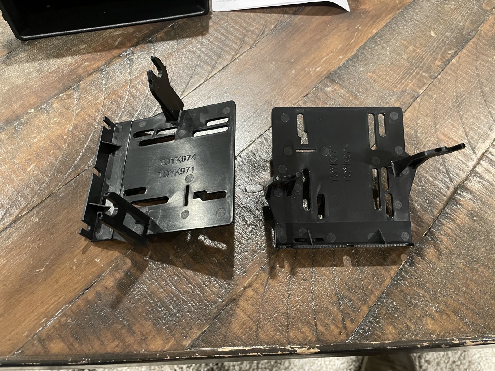

    The brackets are pretty standard on the AI kit, being plastic. Instead of full holes, the mount points are Y's. I included the back of the pocket on this to show how the pocket for single-DIN would mount, it snaps in
