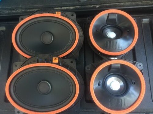

    I was happy with my JBL system for quite a while too. Then, after a couple of years, I could tell it wasn't as crisp and clear as I would like it to be. The subwoofer performance became underwhelming compared to other audio I have. (BMW has a JL Audio 10W3v3, house has Sonos in living room, my small theater room has Elac 7.1.2 Atmos)
    I'm not trying to be condescending here as I was "happy" with my JBL system for quite a while. But have you actually SEEN the JBL speakers? Once you see them, you'll realize there is a shitload of room for performance improvement. I didn't see the speakers until I needed to pull the door panels off to add sound deadening to the system, that's when I finally discovered the atrocity that is the JBL speaker. The front speakers are basic 6x9" paper mids and the rear are an absurd 3" speaker in a 6.5" plastic housing. It doesn't take much to upgrade the speakers and make the system sound phenomenal.

    Yeah I know what you mean, I've seen post about how cheap they are. I've never had a system in any of my previous cars so this is was an upgrade, but I'm sure it can sound better. I'll look into upgrading the speakers for sure.
