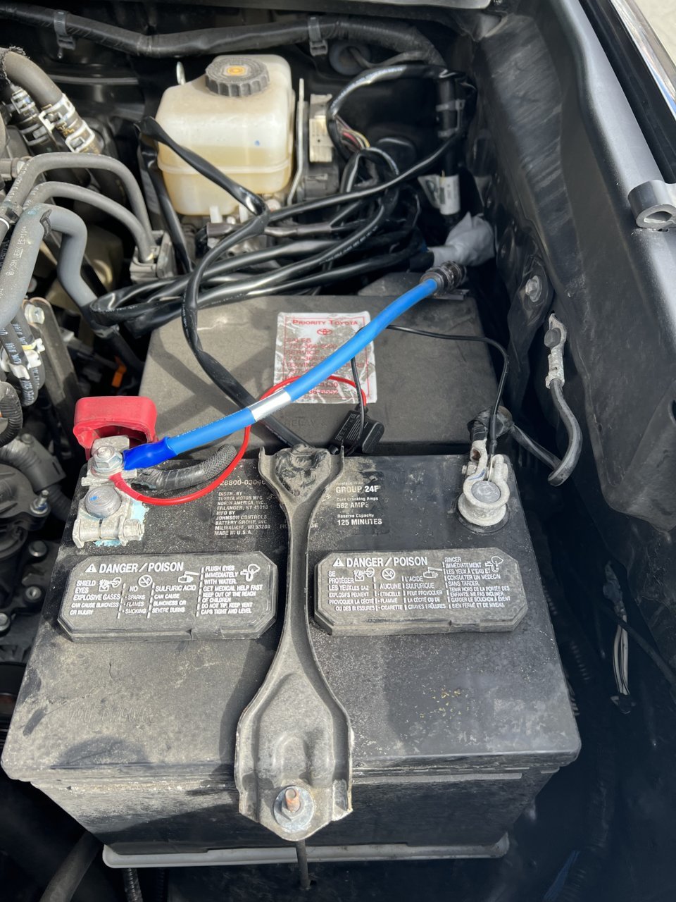

    Ok I will try that next. Here is a current picture of the ground I’m worried this may be the issue.
    I can confirm power wire is connected to the right spot.

    If you can confirm the power wire is hooked up correctly to the battery with a good inline fuse installed, then check your amp fuses. If they are good, bad amp.

    Can you send a picture of the engine bay where it is connected. An extra set of eyes never hurt...

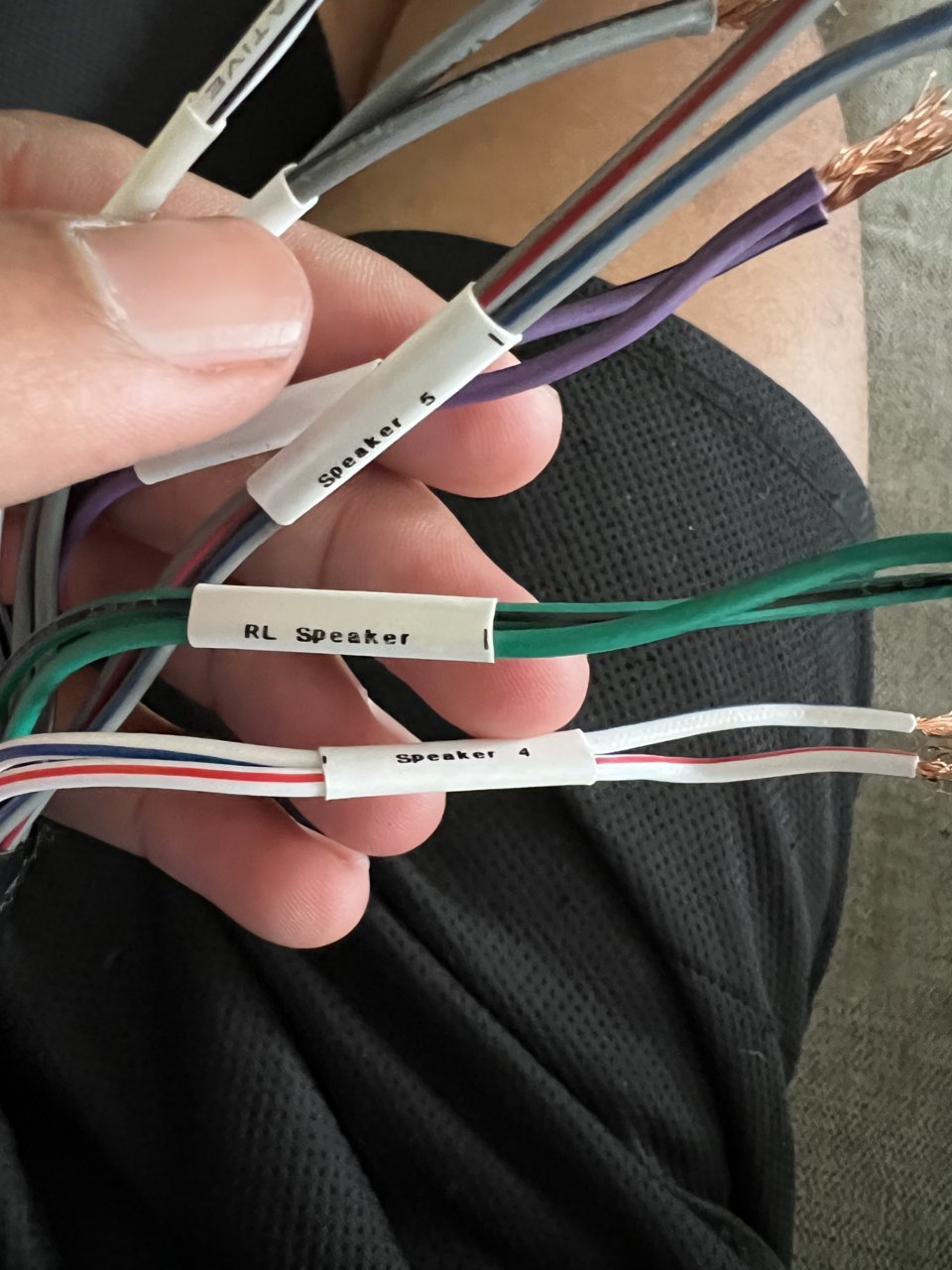

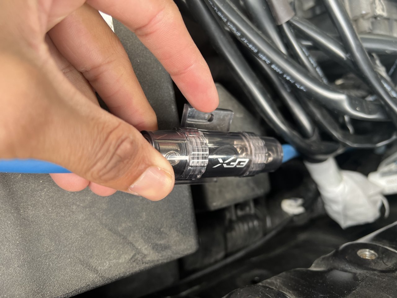

  12. Jan 19, 2023 at 2:26 PM
    #32
    Camrscott84
    Camrscott84 [OP] Member
    Dec 24, 2022
    #413913
    12
    Cameron
    2019 Tacoma off road

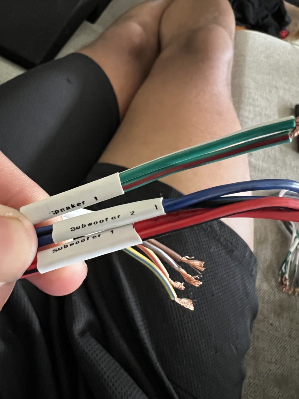

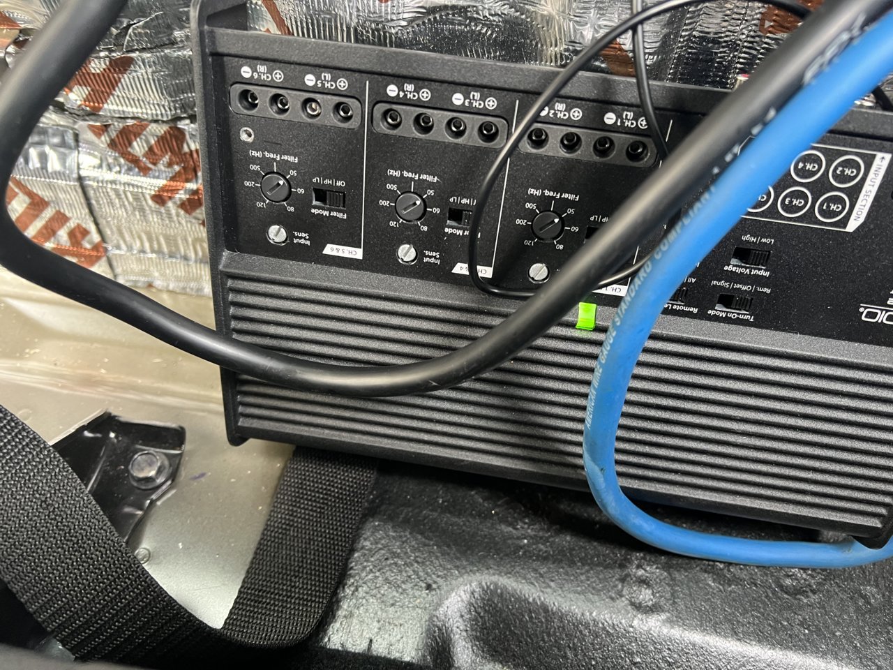

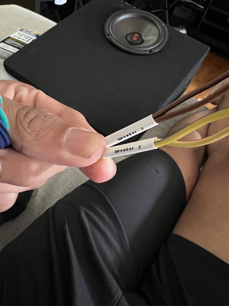

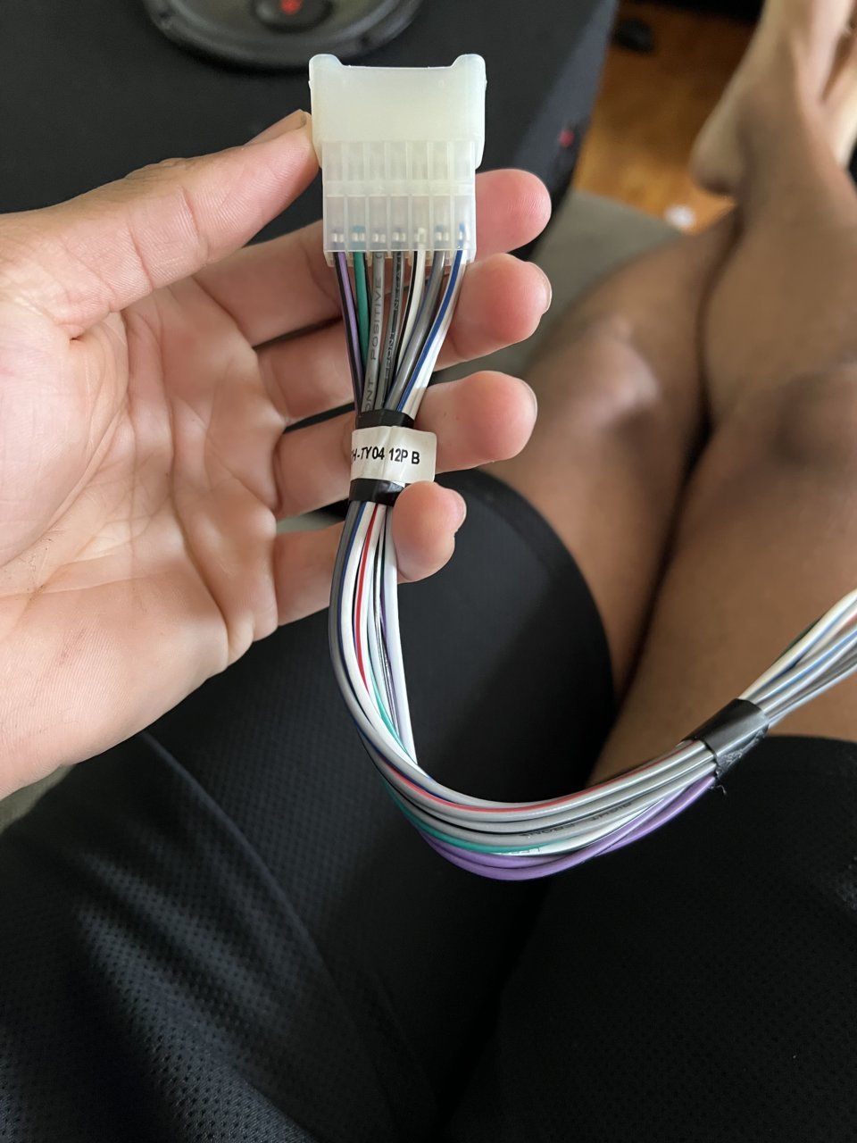

    Alright here’s an update. Kook of the day story. My friend who helped me wire didn’t put the fuse in the 12V cable. Dude was added today and we’ve got power to amp! It works! Now I’m onto wiring and ready to get this bad boy up and running. Need some help matching the speaker wires. Don’t want to blow the amp right?!
    The purple and green harness attaches to top factory plug
    red and yellow harness attached to the middle factory plug.
    any tips? Thanks again gents y’all have been solid.
  13. Jan 19, 2023 at 7:34 PM
    #33
    TacoManOne
    TacoManOne YotaWerx Authorized Tuner
    Mar 10, 2018
    #246923
    1,957
    Paul
    Liberty Lake, WA
    2018 Blazing Blue TRDOR DCLB Premium JBL
    YotaWerx Tuned, Meso stuff, JBL upgrades, Bilstein 6112/5160, RAS

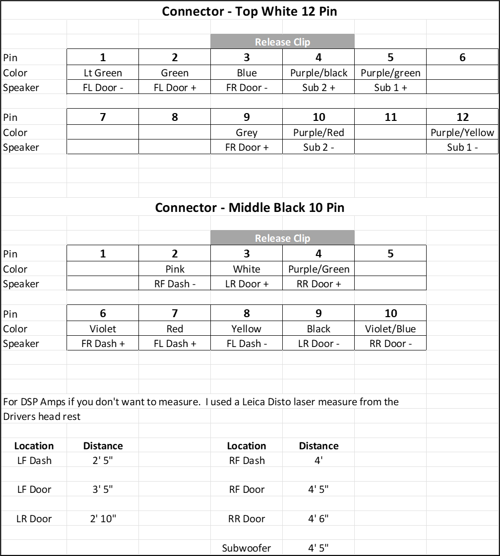

    How about this?
    Measurements for the DSP in the chart below are for a DC Taco.

    Hi! I'm about to do the factory jbl amplifier replacing with aftermarket 5 channel amplifier, I'm keeping the factory head unit (radio). did this harness worked for you with out replacing the factory head unit? and did you completely removed the factory jbl amplifier? Does everything works with out any issues? or did you had to purchase or add any other than just the harness for the system to work with aftermarket amplifier. thanks for the writeup.

    Yes and I left the factory amp in place. Crutchfield harness would be a great option.
