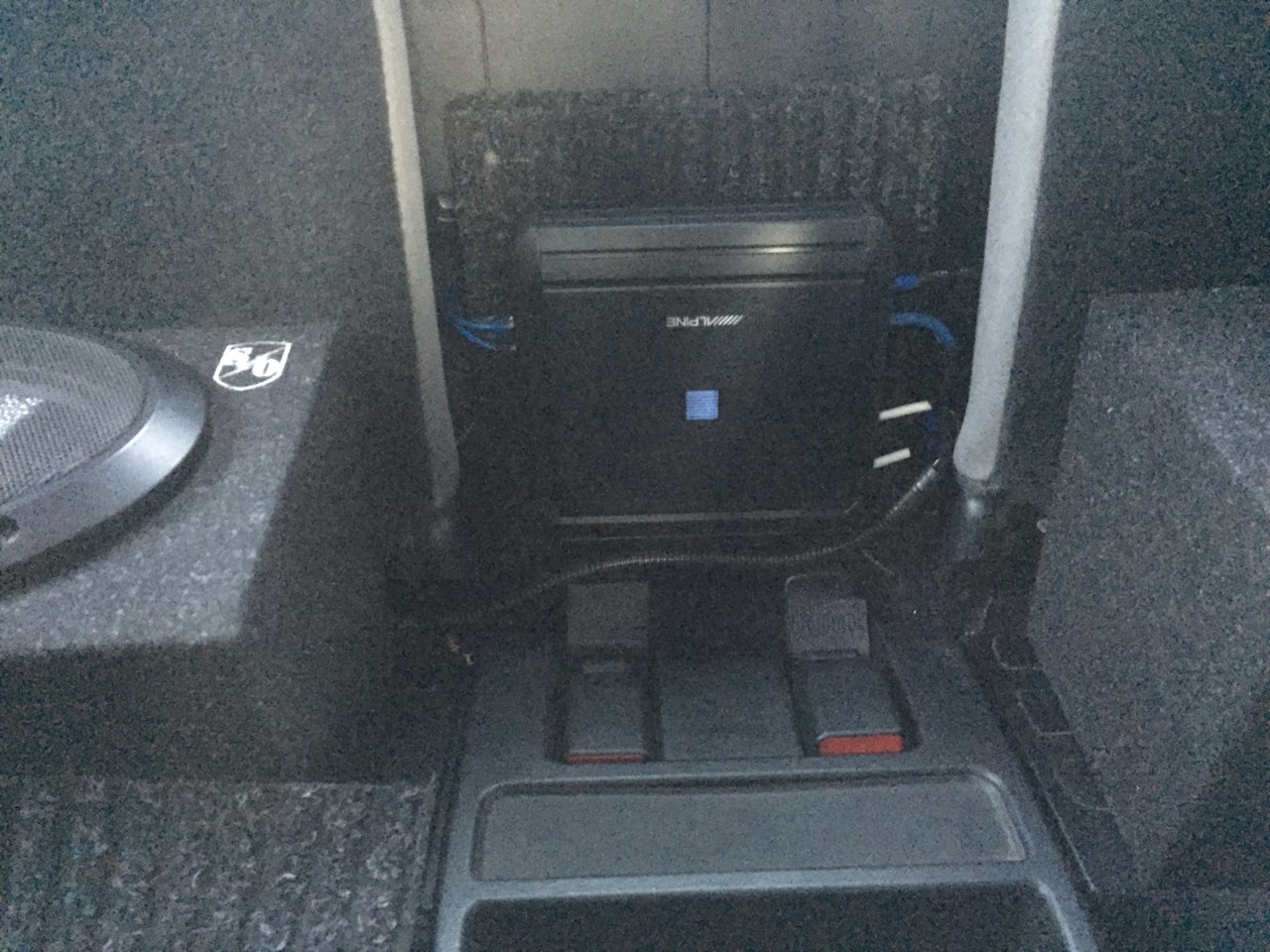

    yeah I tossed the factory unit that came with my SR...I ditched all the speakers too...Then I installed a 300 watt Alpine amplifier. Now she thumps

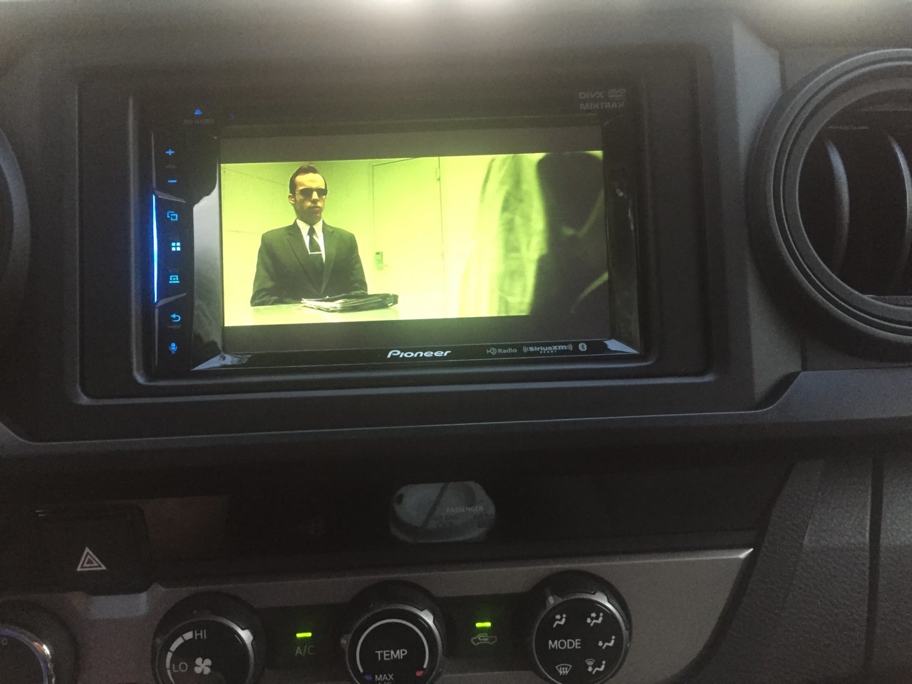

    AVH1440NEX

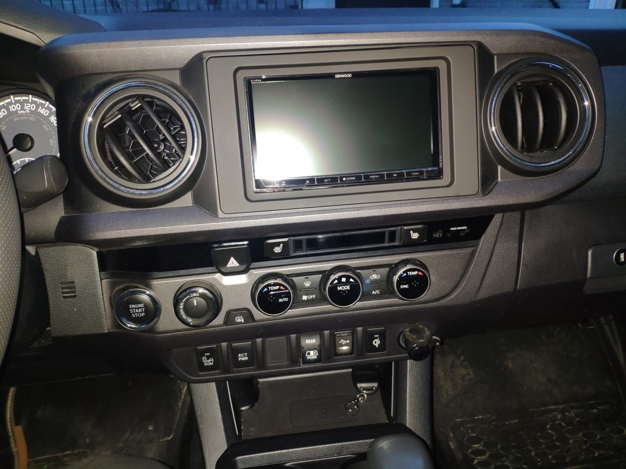

    TacoTruck what are you looking for the finished product? IMG_20200310_193137.jpg

    Thanks for posting the pic. I wanted to see how your aftermarket unit looks in the existing location.

    No problem it looks real clean as you can see. If you didn't know what was there before it really looks like a factory unit!
    I am glad I pulled out the factory unit and installed this one.

    It does look really clean. If replacing the unit though, would be nice to find one that is larger then the OEM that fits in the existing hole. Looks like there is still tons of room for a bigger HU.

    I agree it would have been nice to have bigger viewing area. I did look around and asked at the supplier if they had or could get something with a better viewing area. He said I could venture out and try my luck with something from China. I did look but didn't find anything I was comfortable with even trying. Maybe someone will come out with something larger someday but for now this is perfect for me anyways.

    AVH1440NEX
