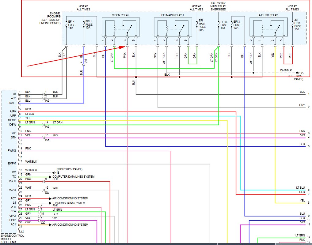

    I'm very interested in this as well. The best way to secure your truck is to have something that is unique to your truck, your own system: a kill switch only you know the location of, an electronic security system that only you know how to disable, or even a mechanical lock only you know how to crack. Sure, it will not prevent a determined thief, but they will need to spend time reverse engineering your system, time that they don't have (security through obscurity).
    Once again, I don't know anything about my truck wiring, but let me point you to this thread here and see what you come up with:
    https://www.tacomaworld.com/threads/2016-tacoma-wiring-diagram.534041/#post-17148795
    I can confirm that pulling out the AM2 (No. 1) 30A fuse renders my truck un-startable.

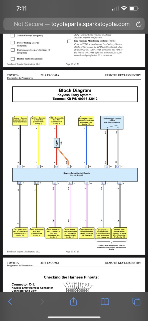

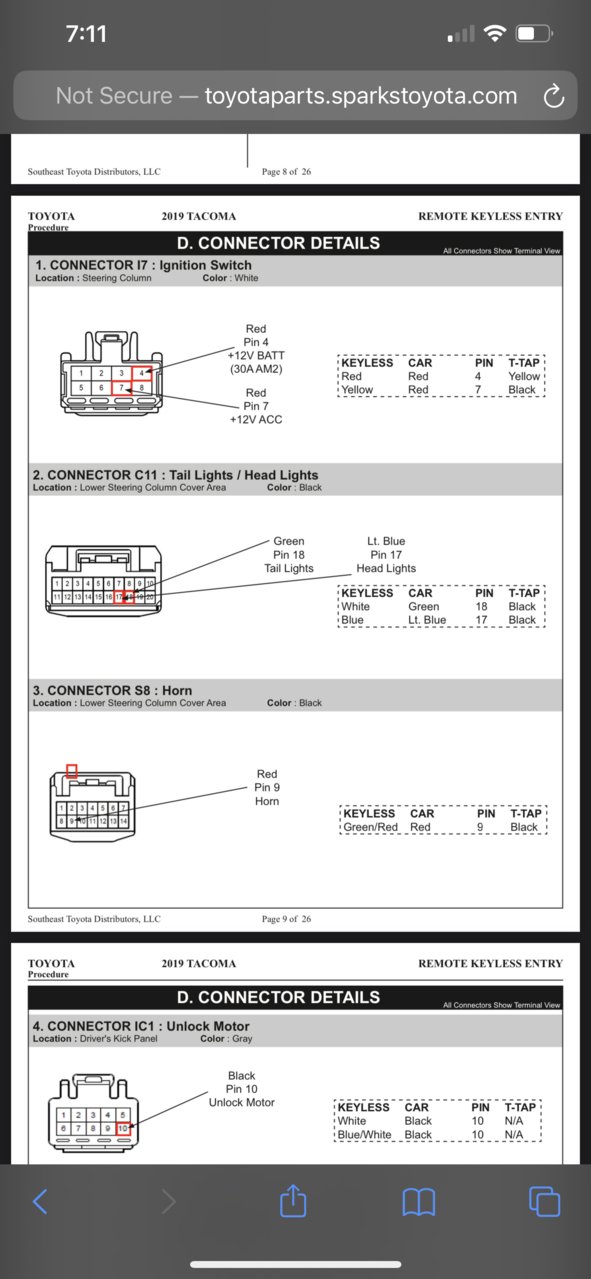

    I installed a keyless entry system to my SR with keyed ignition. The push button cars might not be the same but it’s worth looking at these diagrams.
    I had to tap into the ignition power source for my keyless entry. It’s possible to splice a switch into the ignition power/ground as a kill switch. All of this is in the steering column and is physically impossible to get to unless the car is on, wheel turned so you have access to the 2 screws holding in the lower column panel.
