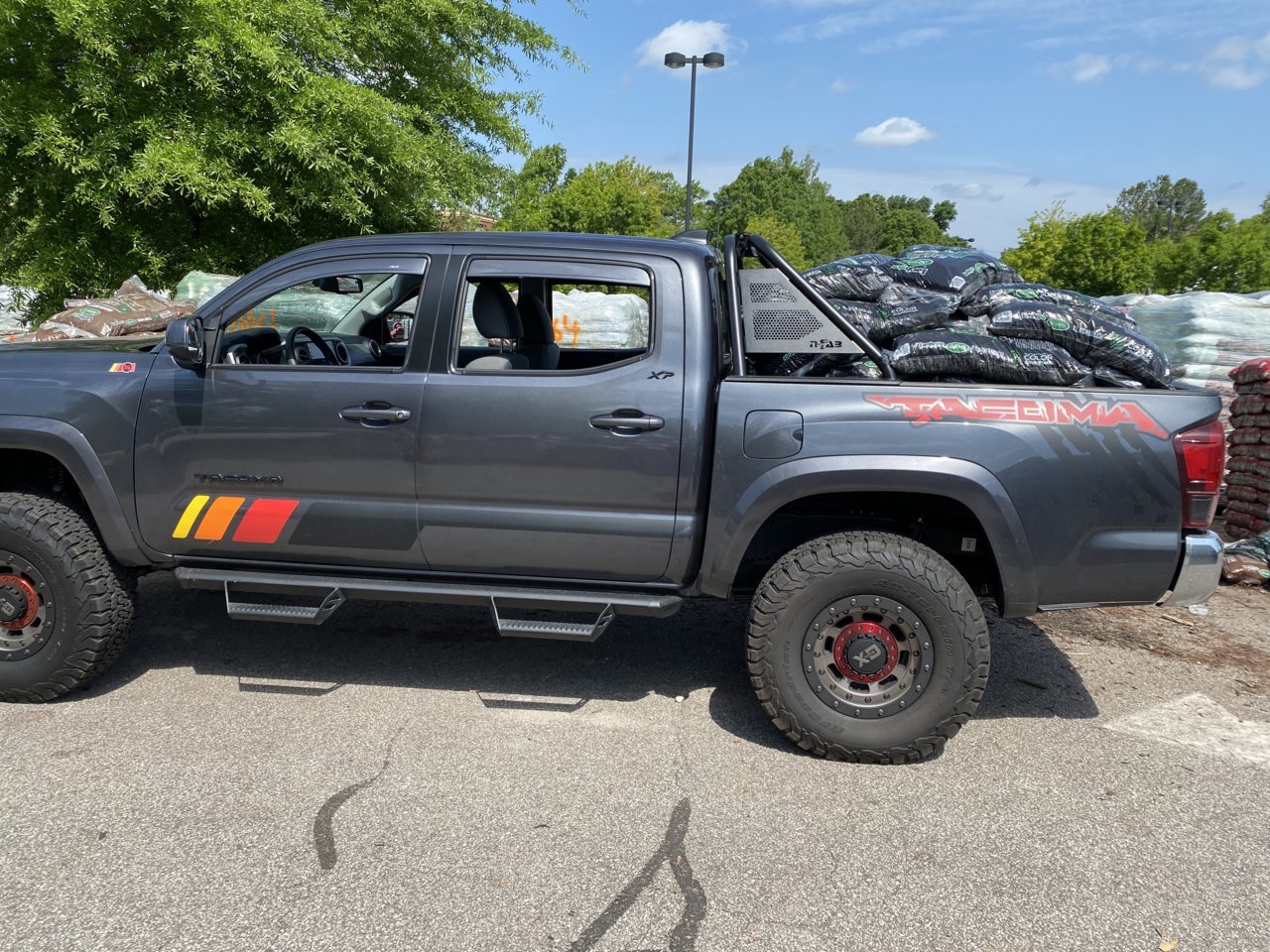

    I agree. I have a complete set up front and rear, but 2wd. Empty the ride is rough, but when I tow a light as a motorcycle trailer the ride is great. They are more than adequate. They handled this load of mulch no problem.

    wow that looks like a TON of weight in back with little to no squat.
