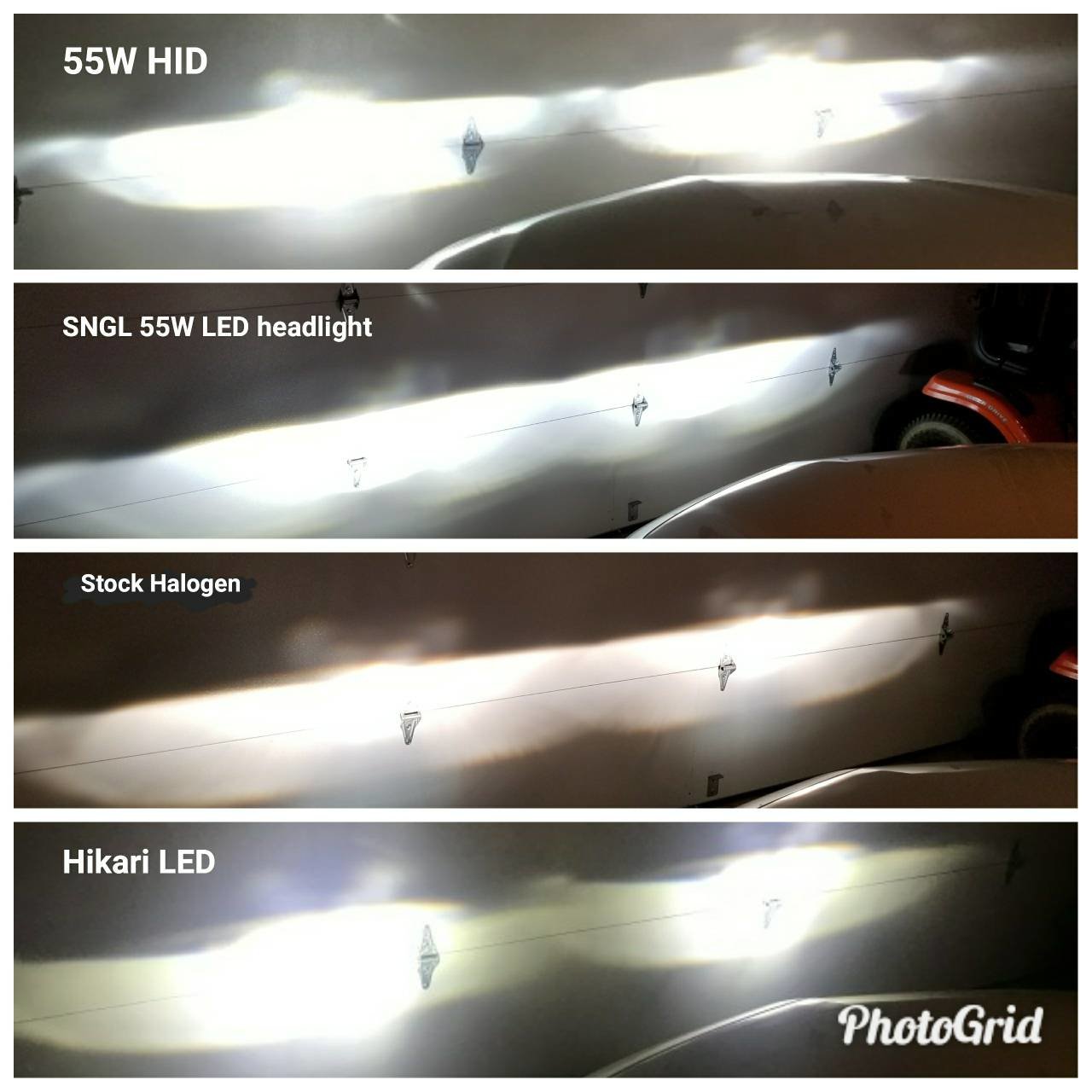

    Here is a pretty good example and comparison of the 55W SNGL LED Lights. In the photo collage, you'll see 55W HID as well as the Hikari Phillips bulbs.
    DISCLAIMER: These photos are not my own nor were they used in a Tacoma. These are from a guy in Maryland in his 2017 Chevy Malibu Premier which does use projector headlights for low beam.

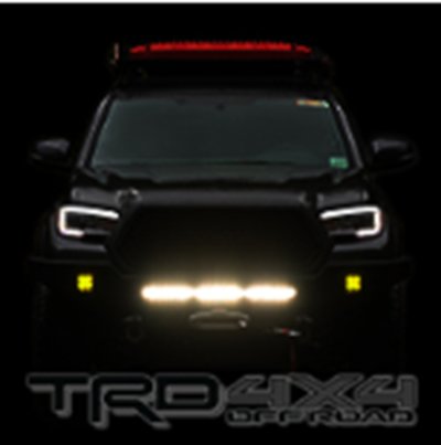

    Thanks! Here's a better resolution version:

    Ahhh there we go! That's a badass picture man. Your photography website is sick as well (sorry i stocked you for a second lol).

    I realize those are not your photos or comparison but it is difficult to judge much of anything in the photo other than color temperature. To effectively see how the pattern does you need to be ~25' from the wall, as the further away you are from the light source the more apparent the pattern quality is. Just as an example, if something was off by 5 degrees, you wouldn't notice much at 2' distance, and headlights are obviously not used at such short range. At 25' distance that 5 degrees becomes very noticeable, which is why when aiming headlights, they are done so at a 25' distance. It also helps to have the lights side-by-side in the same photo to eliminate variances in the cameras settings and focus for the photograph. It does look like the SNGLs have better hot spot definition than the Hikari's, but it could also be the camera.

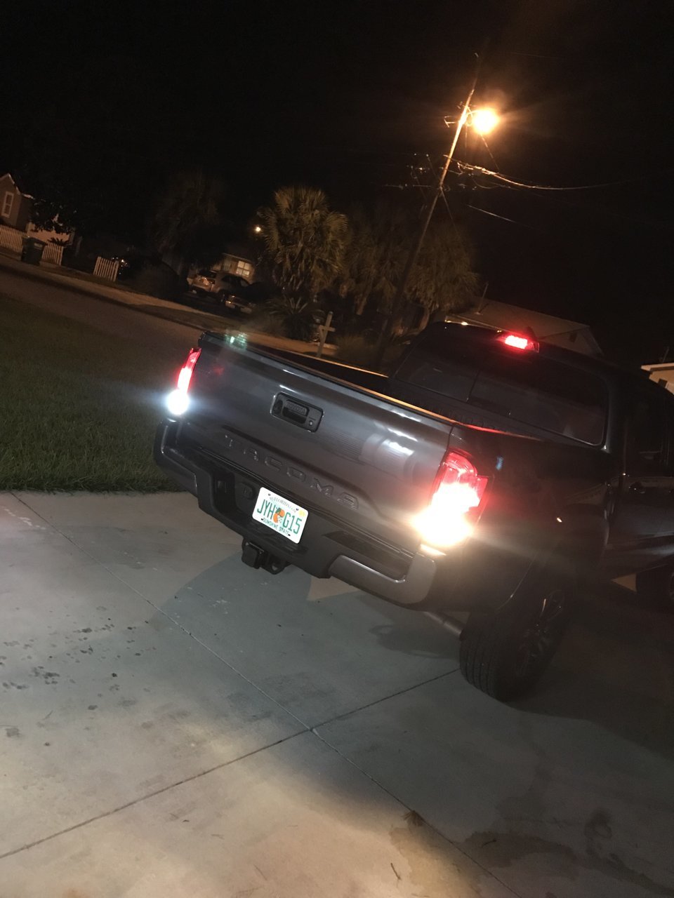

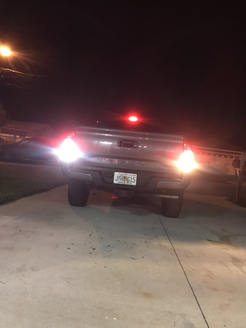

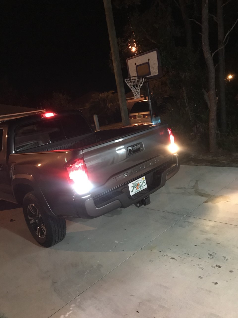

    Installed some led reverse lights tonight from xenondepot Xtreme 921. The design made sense to me on how it would reflect back to the reflector/housing. I like the color- matches the Phillips vision 194 white license plate lights I have installed. Not comparing the output to other leds but just comparing to the stock it looks to put out the same output and seems to utilize the reflector as well as stock does. I’ll have to doublecheck tomorrow but light distribution looked good with no hotspots
