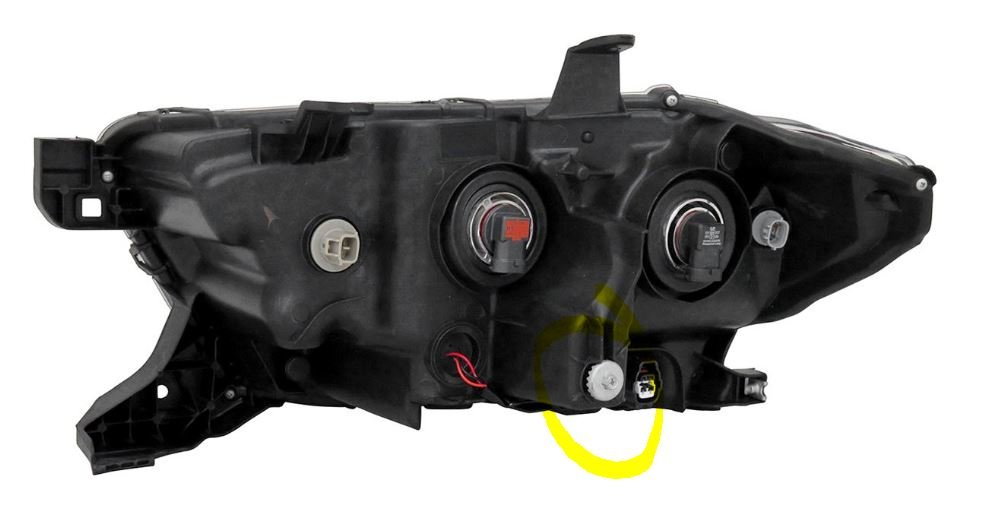

    Haven’t really looked yet..does 3rd gen lights adjust like 2nd gen? Or by each individual bulb?

    There is one adjustment knob that does both low and highs.
    Circled in yellow.

    Just vertical no horizontal correct?

    Right, only vertical.

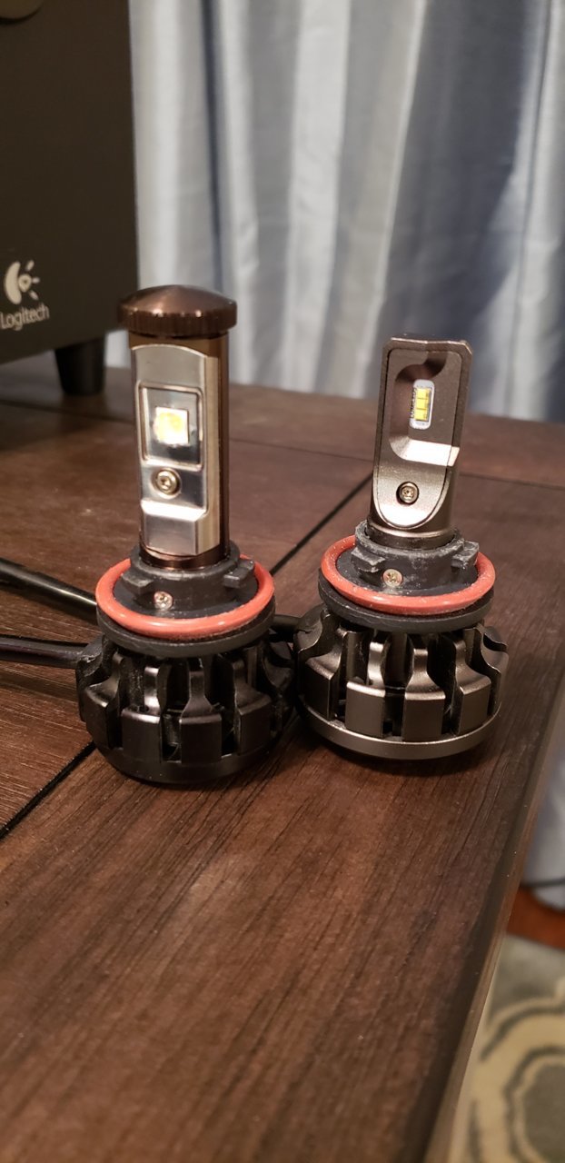

    A quick answer for most of you. I'd recommend getting a solid set of HID bulbs for the Low Beam Projectors and get something between 4300K and 6000K. Those number will depend on your preference for color output. I'd recommend either XenonDepot Xtreme HID's or Morimoto Elite HID's. @Sn4rlax i'd probably recommend that you get THESE in the Phillips 4300k based on what you're saying.
    For the High Beams, I'd recommend a solid set of LED's. You really can't go wrong with the XenonDepot XTREME LED PRO HEADLIGHT. However, I am currently testing a set of LED's for a company in the Highbeams that are probably the best I have ever seen. They aren't available yet so I don't have a link. I will post a review on those as soon as I wrap that up. The Hikari Cree and Hikari Phillips also perform very well in the HighBeam.
    For the Fog Lights, a good pair of SAE replacements such as Morimoto XB's or similar is your best option. If you still want a quick and easy drop-in option though I'd recommend again the XD XTREME LED PRO FOG LIGHT bulbs. The Hikari Cree work fairly well tbh, but not as well as the XD's. The Hikari Cree are cheaper though significantly.
    The Hikari Phillips SUCK in the fog lights so don't buy these for the fogs.
    To be sure you know the difference.
    Cree on the left and Phillip's on the right.
