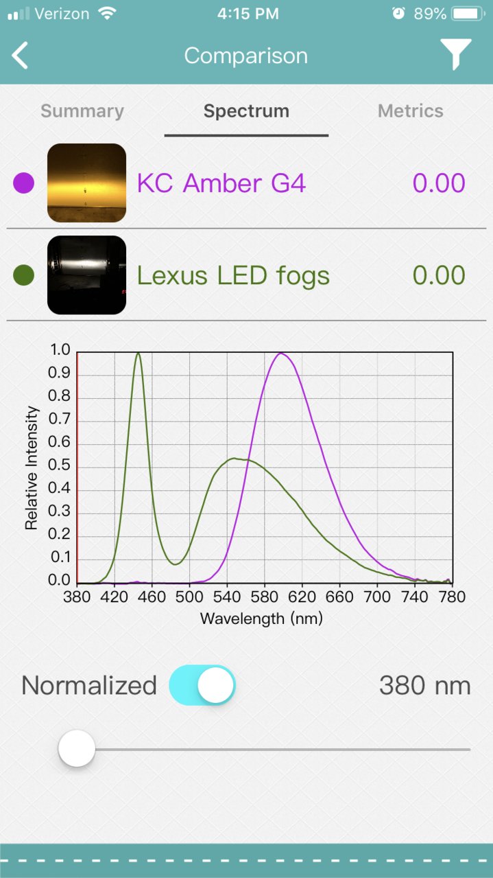

    OEM LEDs have the same refraction issues. This is from the cool color temperature from shortwave blue light in the output that causes the refraction. If you want to minimize refraction for better poor weather performance, you should minimize short wavelengtg light, especially below 500nm.
    Compare OEM Lexus LED fogs against KC amber LED fogs. KC has eliminated the short wavelength blue light using an amber LED light source whereas the Lexus LEDs have the typical significant high amplitude spike in the short wavelength spectrum which makes the lights whiter but also causes refraction and scattering of the beam off of parcipitation in the air. Meaning you see the rain/snow/fog rather than beyond it. The KC amber lights won’t significantly refract as they have cut that spectrum out of the output, shifting the color to amber. Since the long wavelength amber light does not bounce off the precipitation back at the driver, you can see the roadway beyond the rain/snow/fog.
