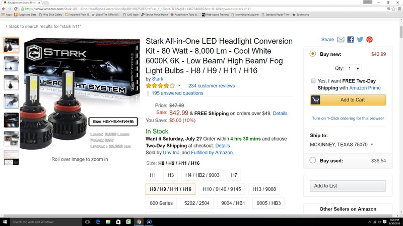

    Hey guys, been eyeing some led bulbs for my 3rd gen for a short while now so i finally decided i would buy two sets of opt7 bulbs for my lows and fogs. I was even able to find two sets on ebay for 151 shipped..... long story short, after much debating and research, the cheapskate in me got the best of me along with Amazons very good return process (that i have used before). so i ended up buying two sets of this "stark" h11 led kit. they are advertised as 80 watt 8000lm and 6000k, 30,000 hour lifespan and the bulbs are 3-sided so ideally they would work perfect in the projector housings. $40.99 a set! i thought it was too good to be true. so i pulled the trigger and ordered two sets, thanks to amazons speedy prime delivery they were here in no time.

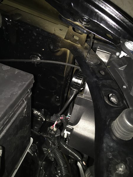

    pulling out the old bulbs is a snap and it seemed as if toyota even designed plenty of clearance to sneak your hands in there for quick bulb changes. the new bulbs are a single unit type design with no other separations/connections between the oem plug and the headlight bulb itself.
    unfortunately, you cannot just sneak the new bulbs into place as they are indeed larger than original. luckily all you have to do is unbolt the tops of the headlights and give them a light tug to give you enough room to install the bulbs. the bulbs are sensitive to polarity so in this case the connector can be plugged in two ways 180 degrees from each other to the oem harness. one position locks into place perfectly but wont power on the bulbs since the polarity is reversed. if you flip the connector over and plug in it will power the bulbs but wont lock completely and properly into place. so the proper solution is to switch the terminals in the oem harness, it is extremely easy to do. you just need to pull out the green terminal lock and then unlock each wire pin and switch the position within the connector, carefully of course. then plug up your lights and make sure they all work properly. i used zipties to secure the led drivers and extra harness so it doesnt flop around.

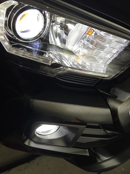

    light output is similar if not better than the halogen bulbs and the color matches perfectly with the DRL.
    the projector housings do a great job of mitigating glare and the beam is really nice and spread out.
    the fogs on the other hand are extremely bright and do have a good bit of glare but the brightness is really nice.

    image.jpg image.jpg Picture of the bulb installed and a color preview .
