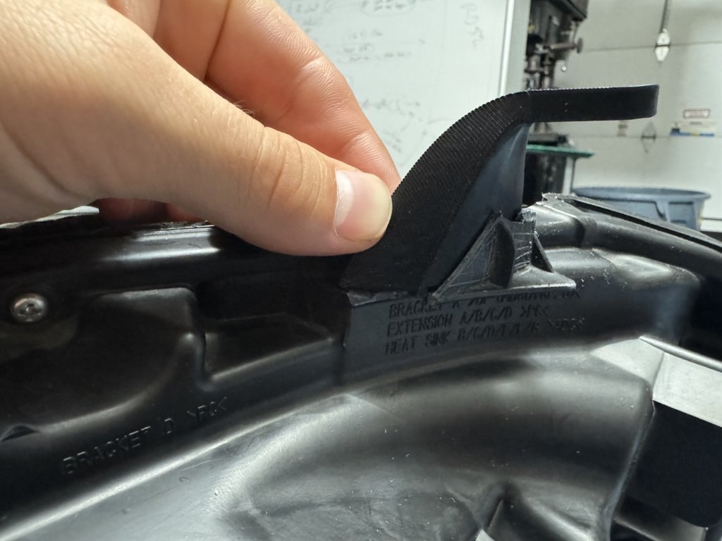

    Should we use a spacer between the bolt and body if its replacing a broken tab? Or is it already adjusted to go deeper on for attachment if the tab is broken off?

    I have done both and imo a spacer isn't needed.
    When I did it I just used a regular washer. It does put the normal amount of space in there which is nice but on ther other side I didn't use one and it felt fine without it.

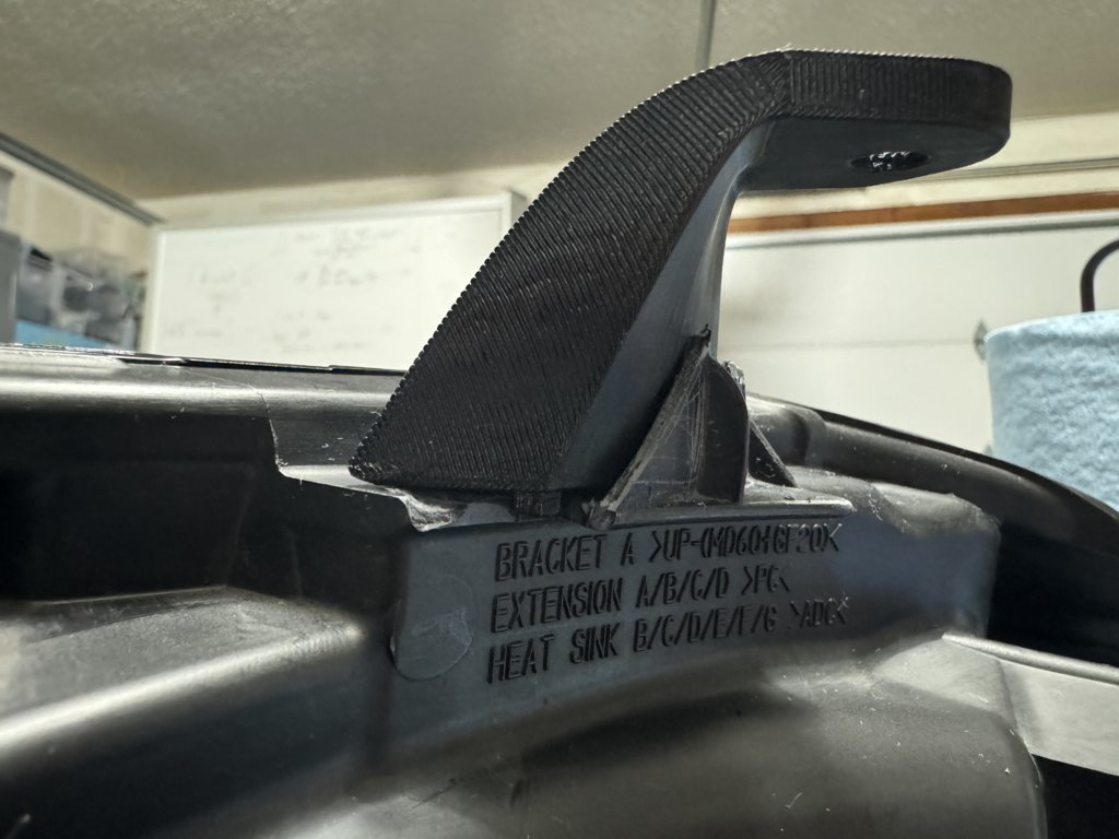

    #67

    How do you position the tab when installing? Pushed against the vertical or flat section?IMG_8408.jpg

    #69
