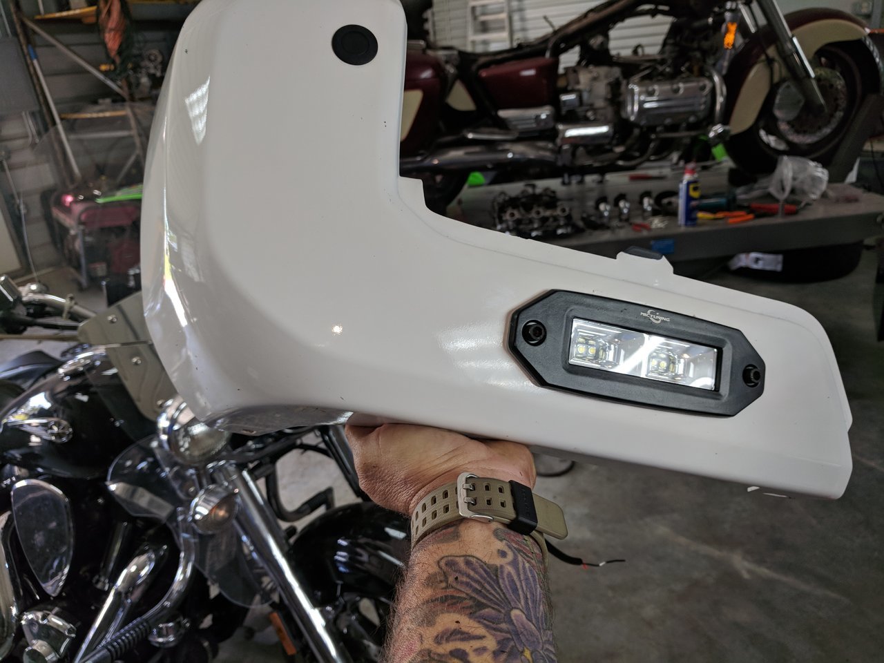

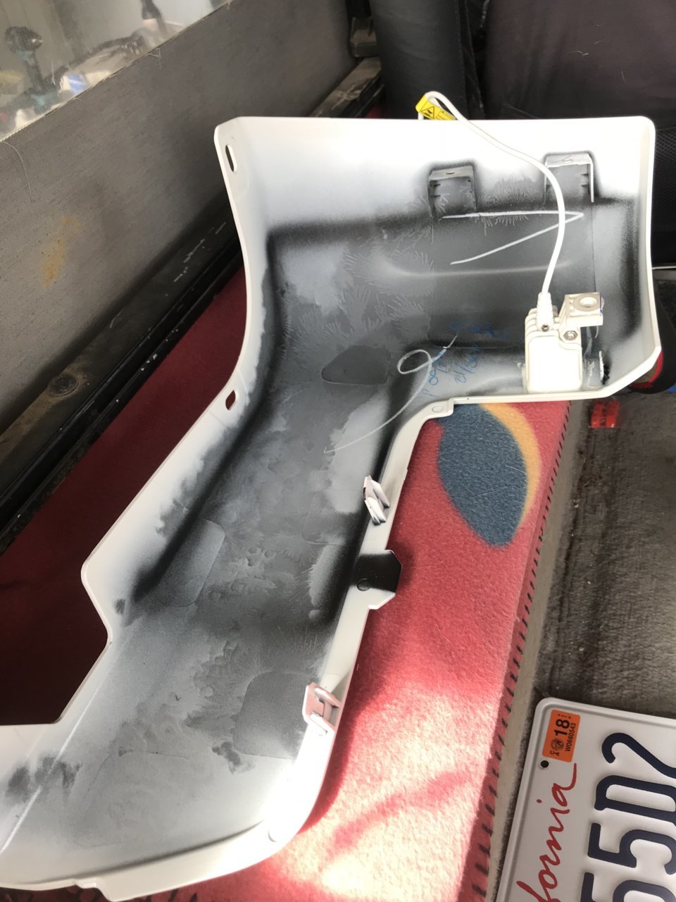

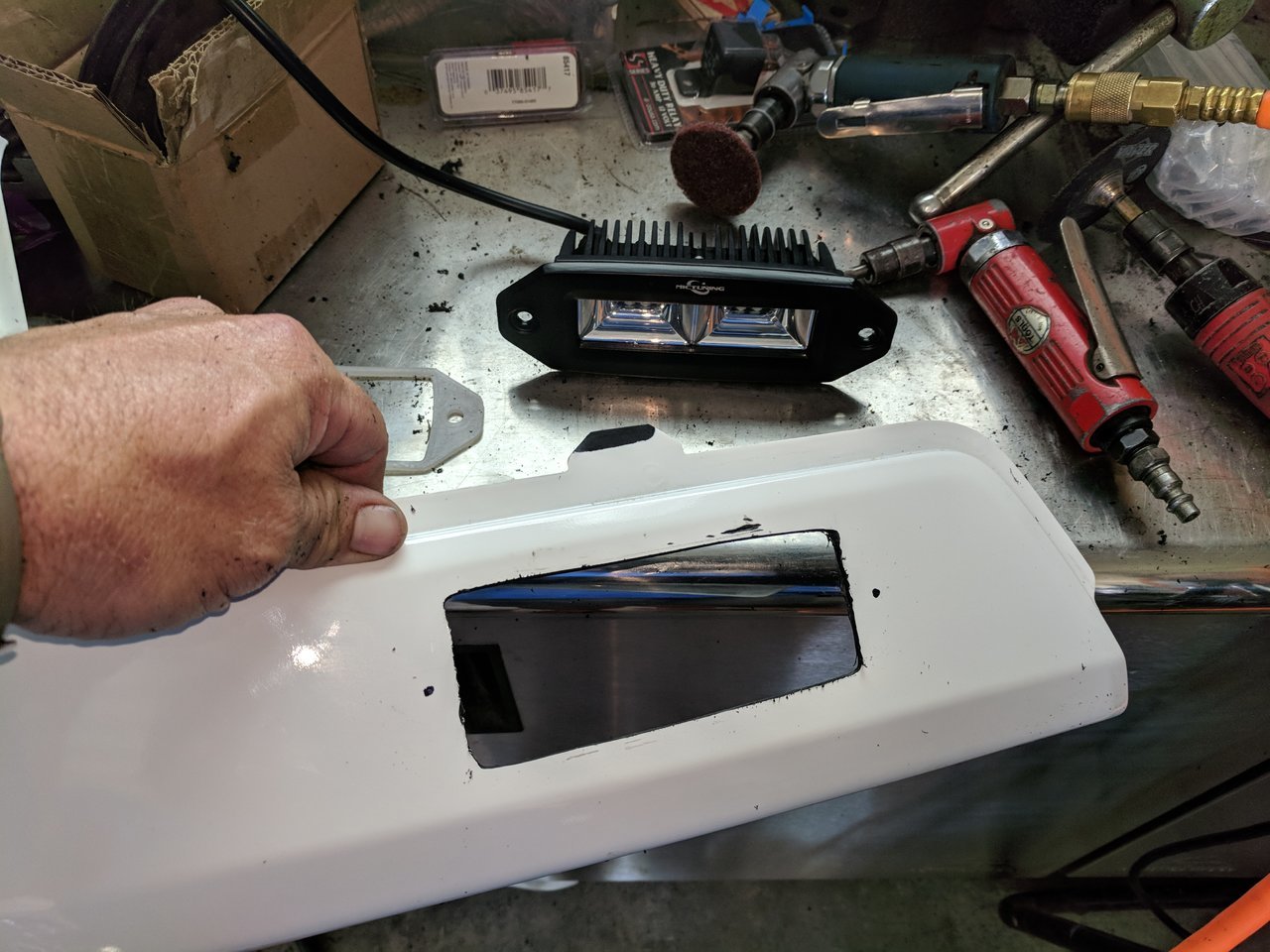

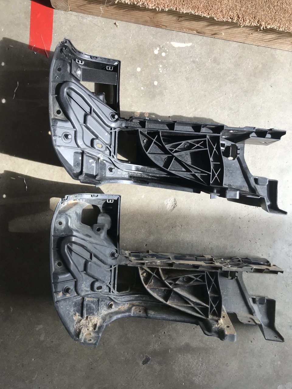

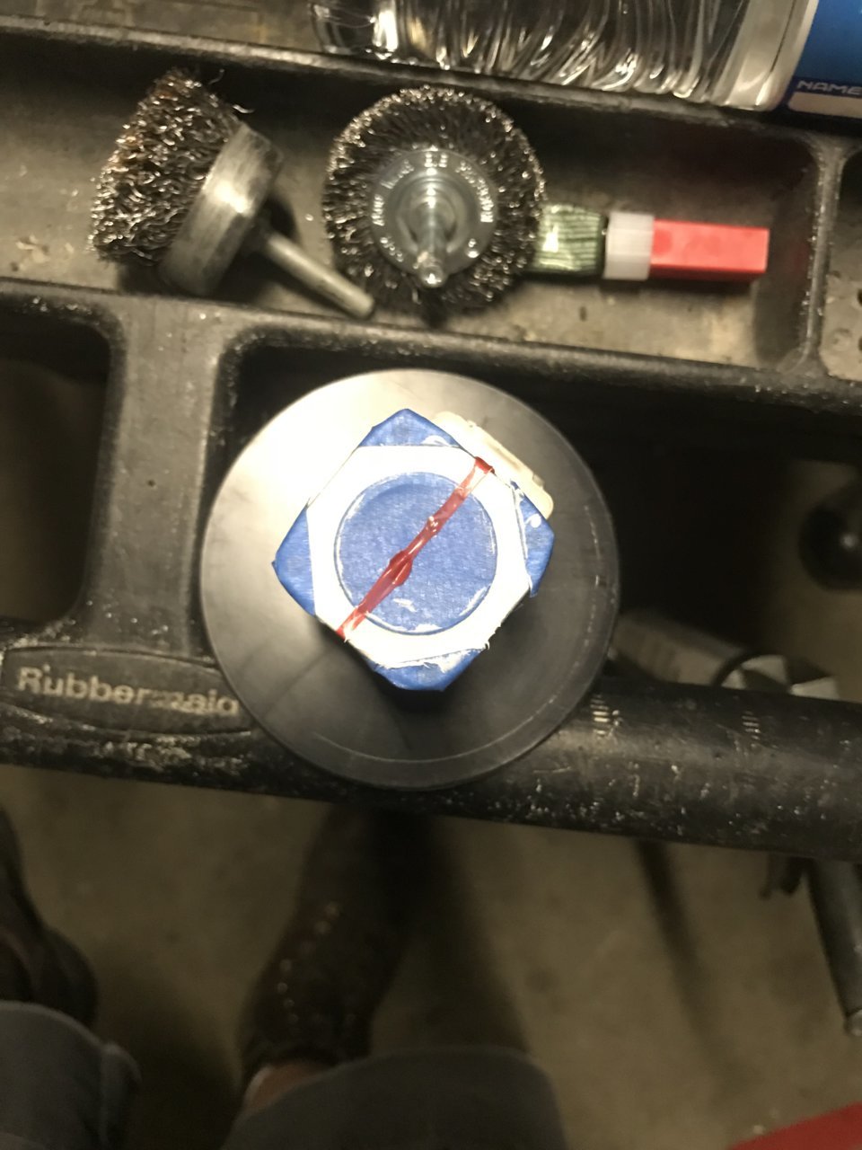

    Coming along slowly but surely. I lost the factory seal by deleting the cover in trade for the cleaner look, so I used some structural silicone to lock the chrome thing in place.(don’t know the technical term for whatever it may be. Reflector?) Then sealed the lense to the bumper cap, and used the rubber grommet supplied with the light to center the housing on top of the lense and secured it with some structural sealant as well. Waiting for that to set up attached my two 1/8th inch aluminum brackets to the bumper stays with stainless M6x1.0 pan heads tapped into a piece of 1/4 in. Aluminum. Most likely will be 100% by tomorrow, Might wait for night to post some shots in the dark.
    CC39140A-E675-436D-A992-5F3BDCB8A142.jpg AE427EE8-DC98-4A00-A2D2-6905B457FA66.jpg 8430A170-CD33-4AD8-9D6C-6608465D1FBE.jpg 8D8AC896-C6D4-4E62-B040-1097B5E4156F.jpg 537D292F-7D3B-40C4-A851-7177440D7DD8.jpg D0C4062E-706E-483E-8951-43670D5A6D3A.jpg
    DubfromGA and ToyoDrew like this.

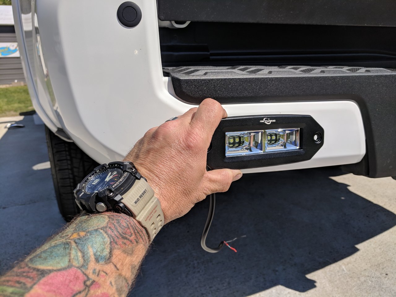

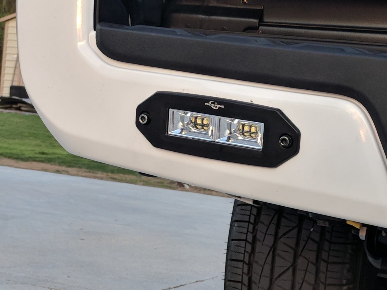

    Finished ready for install in the morning!
    572FF2F0-B1A5-455D-B310-246535A1B8E2.jpg 05031F33-BF55-4DD2-888D-777438BF4AEF.jpg
    Siblue, DubfromGA, Parker315 and 3 others like this.

    Done just need to be wired now.
    Hopefully they aren’t pointing into the sky or way to far apart... still looks better white then chrome

    Nice job!! Looks very neat and clean.
    Very incognito :spy:

    Looks OEM AF! Nice job!
