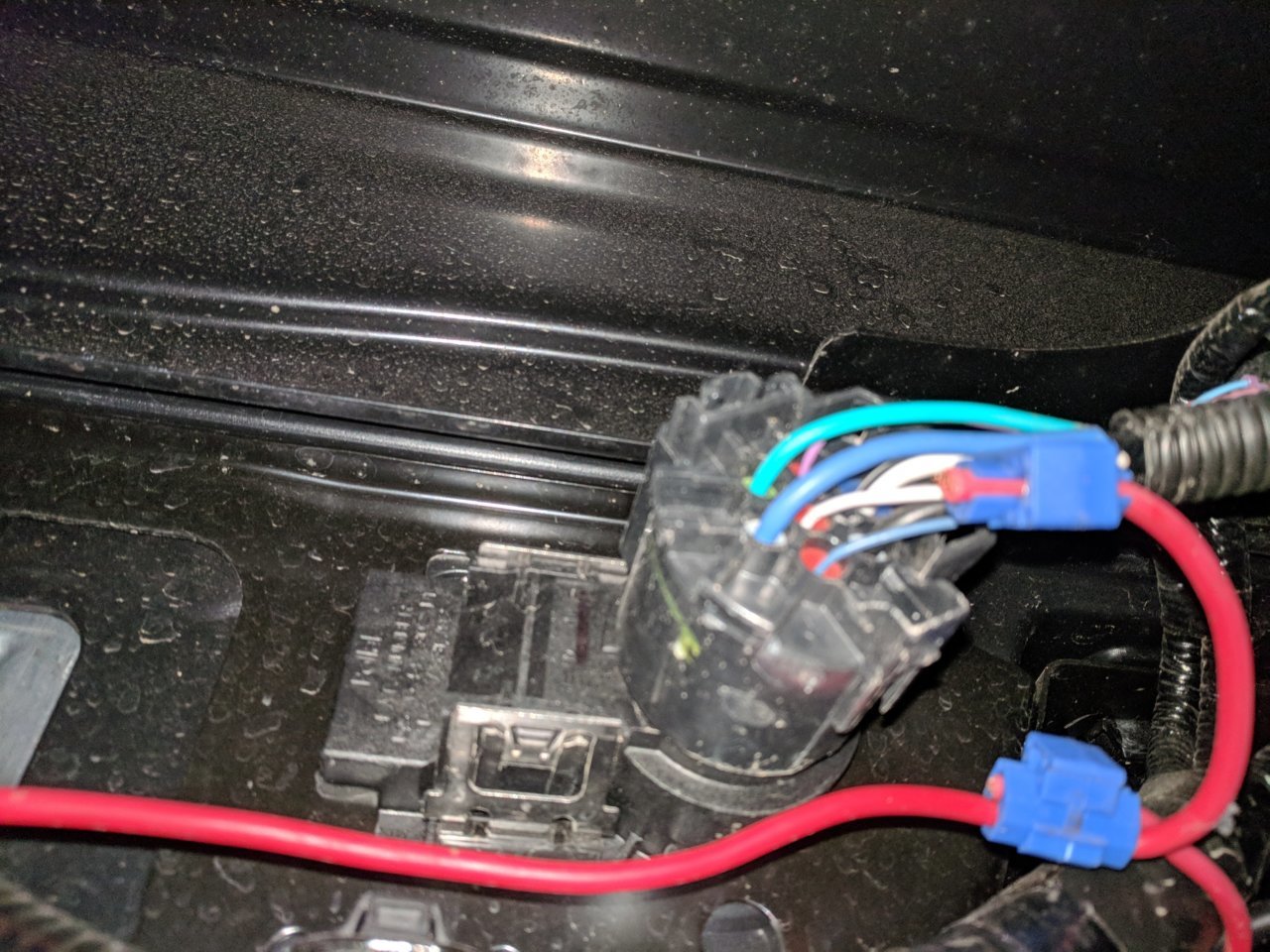

    I put an eyelet connector on my ground wires and grounded them directly to the bumper bolts, then ties both of my hot legs from the lights directly to the middle white wire on the back of the round trailer plug. It's temporary for now till I can get some better connectors and heat shrink them
    Stuart762 likes this.

    Kinda hard to see, but it's the small white wire in the very middle of the back of the round trailer plug on bumper

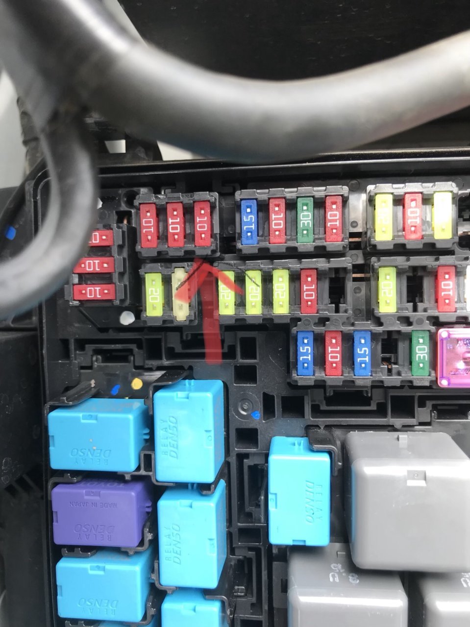

    So this fuse was burnt up, more then likely from me messing around back there, but for your information that’s the fuse that powers the reverse wire to your 7 pin.
