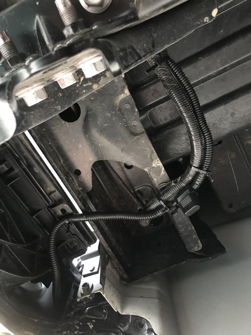

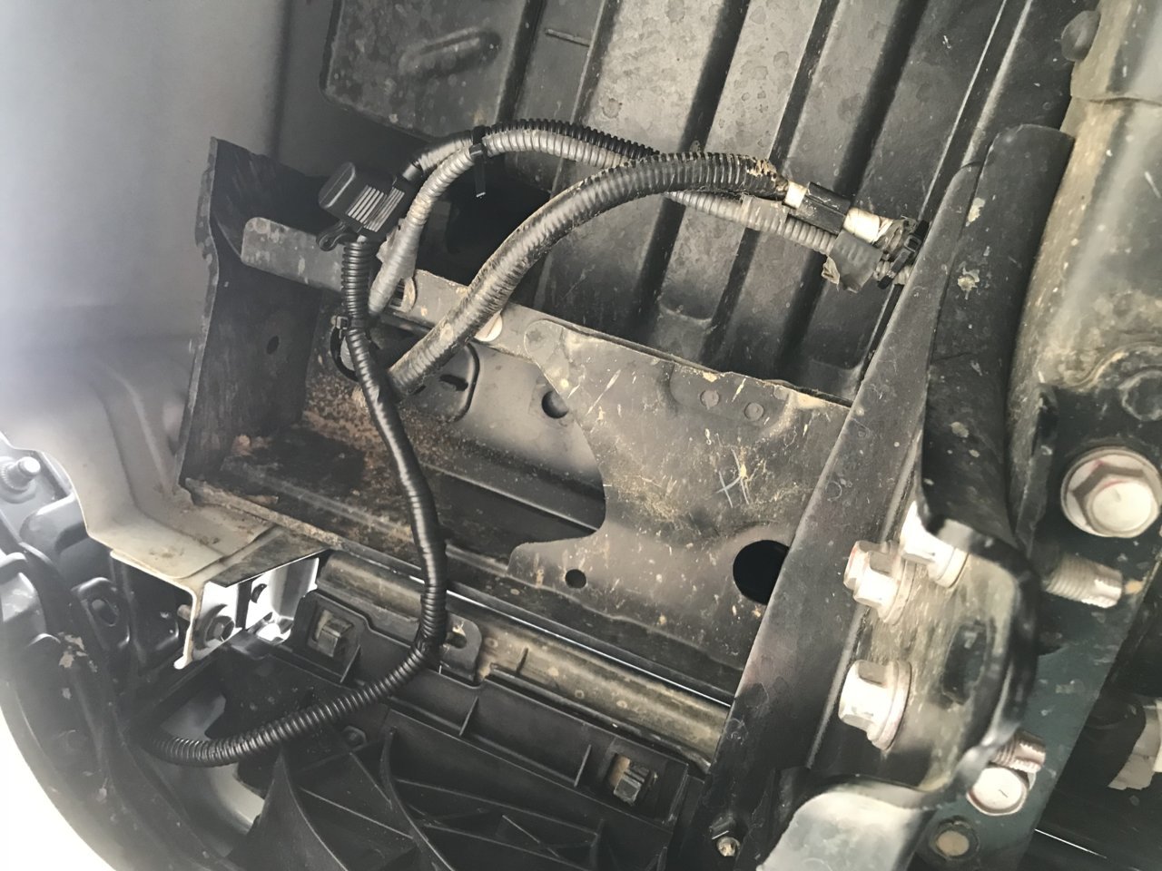

    Here’s how the wiring turned out, soldered it all and sealed it with liquid electric tape and heat shrink tubing where I could. Then threw on some 1/4” corrugated tubing and zip tied it all

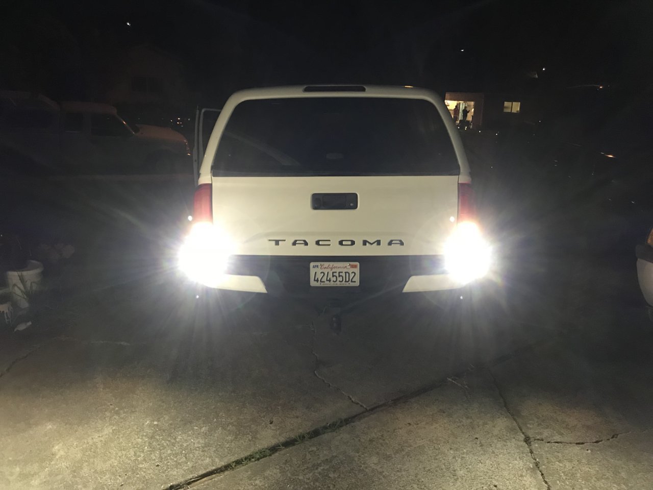

    I’m in CA, still light... stupid sun!

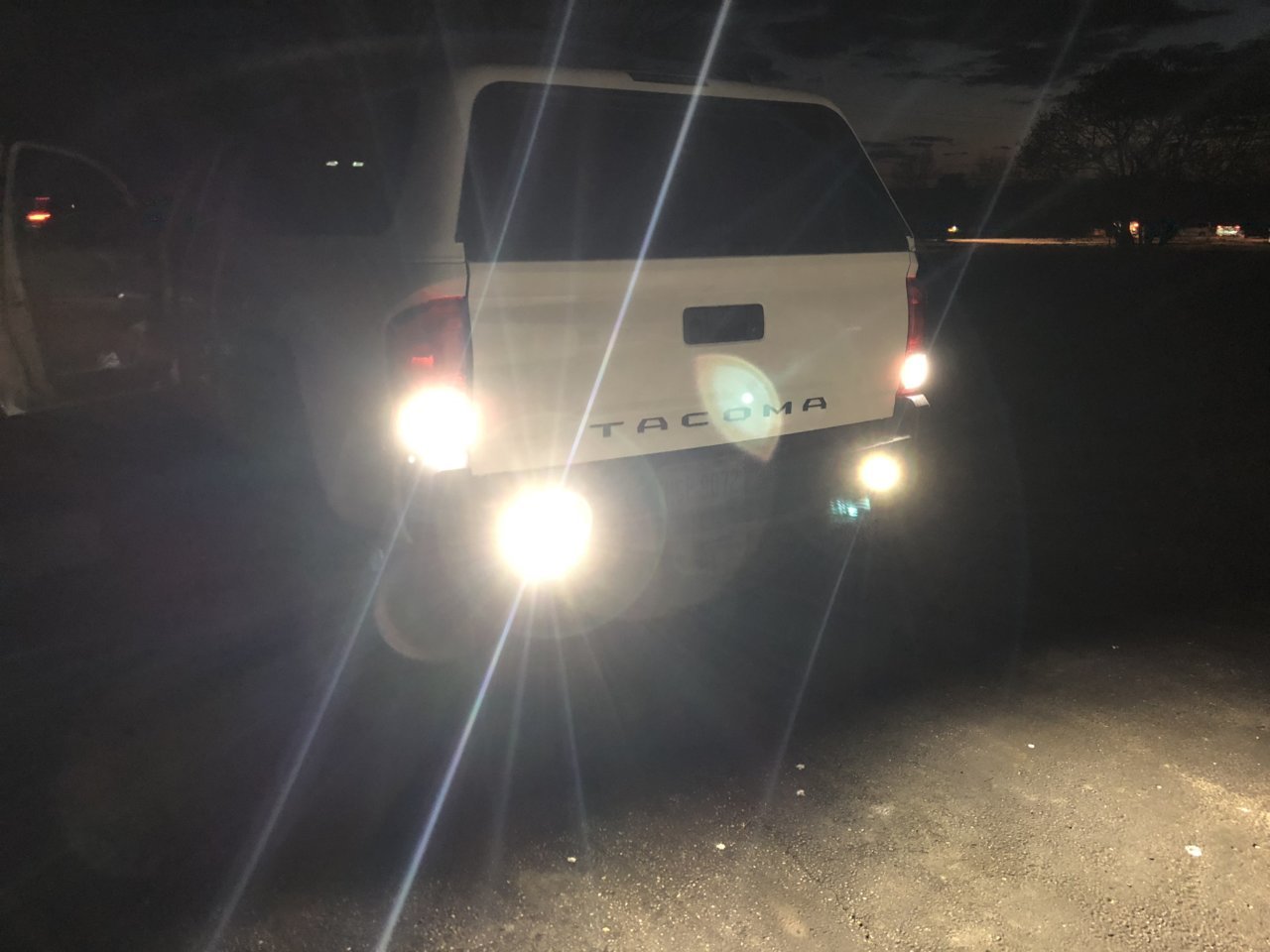

    Think they’re perfect!

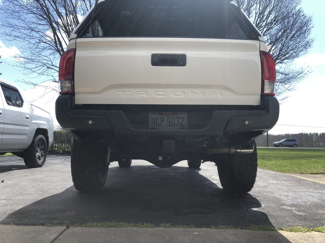

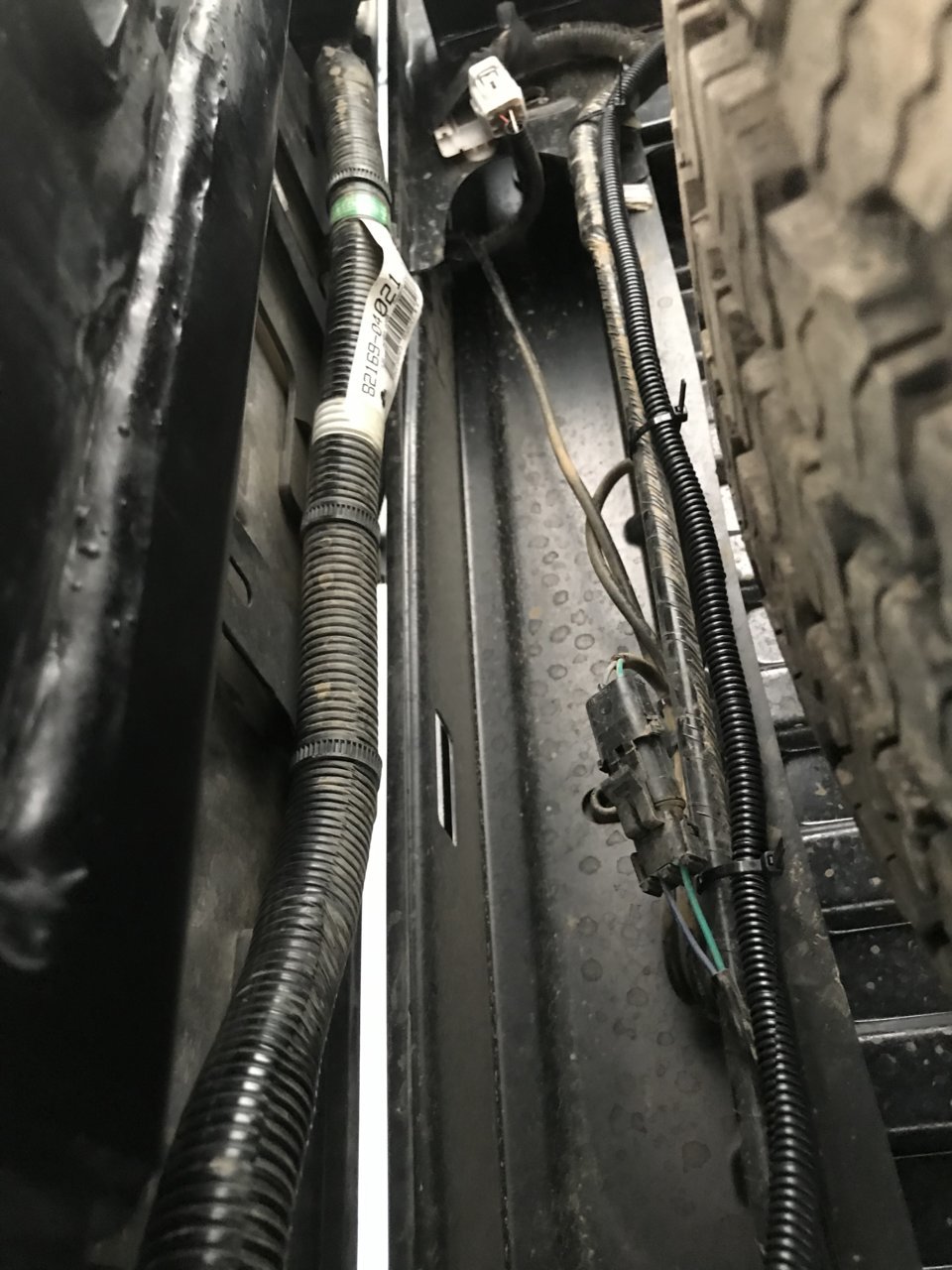

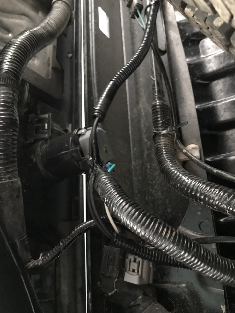

    In this photo where did you run the wire through?
    I have these clips (https://www.amazon.com/dp/B01A6LTK44) soldered to these MicTuning lights and all my wiring is run to the front of the truck to a push switch. I have the female end of the clip on the wiring to the truck and the male end on the lights.
    Did you have to use a drill or 1" hole saw to put a hole where the "3/8" is written or just run it through that left side hole?

    Just remembered you replied to me on this kinda. So where did you have to drill that hole at?

    I just drilled a 1/2" hole to the left of the panel that said 3/8 on it. ran through to back.

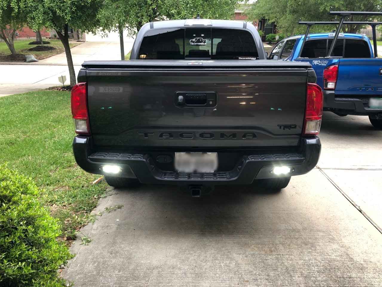

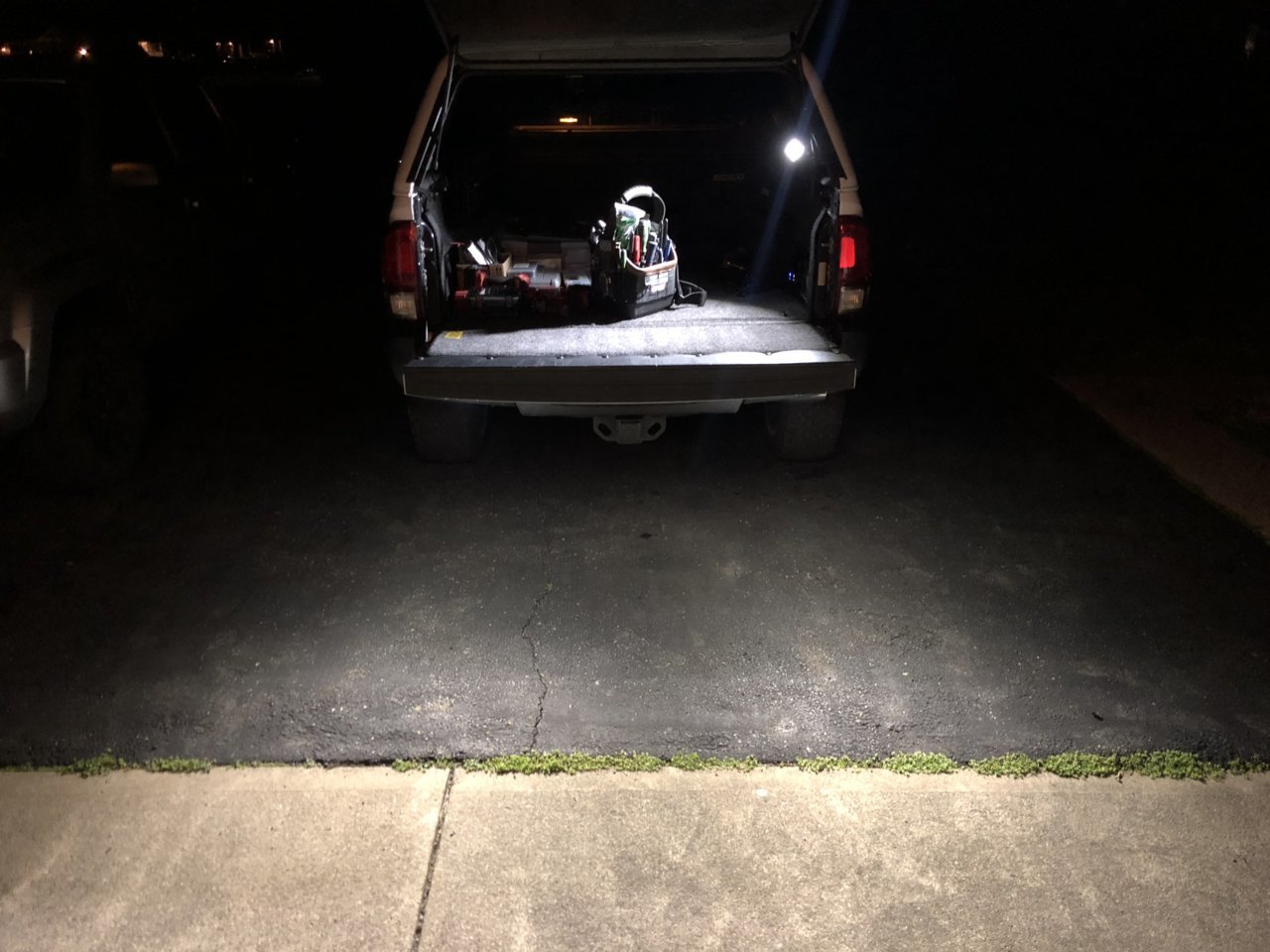

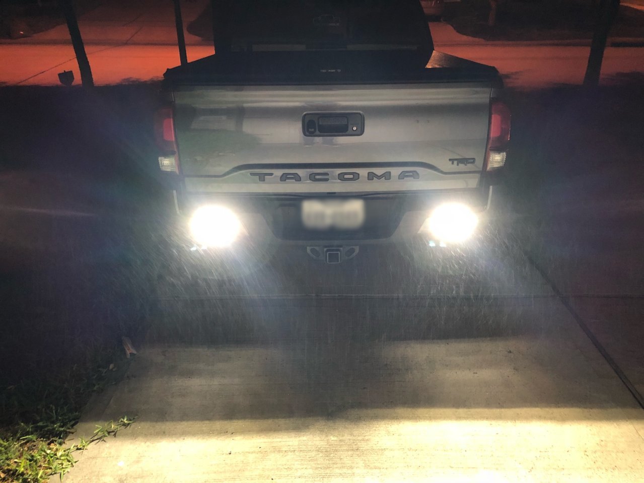

    Finally did it today!! These things are awesome. Somewhat time consuming to install, but not hard at all. Hardest part was probably getting the bumper caps off.
    Thanks to Chris aka @ToyoTacoTurner for coming over and lending a helping hand. I wired mine to a push switch in the cab so I can flip them on whenever.
    I’m sorry @RobP62 i got caught up and completely forgot to take lost of pics and video. Sorry man....
    6A4A8535-8C9B-48B5-B24A-C91FCAF77E94.jpg 1053B380-2783-489E-A36E-167EBB586BCD.jpg B1CEF5C6-62C9-4922-9626-C955DE40A122.jpg 9C1EC387-BFDD-425D-8E65-6758D8252DAC.jpg

    Sweet...those things are rediculous bright huh...good job!!

    Yes!! They are badass and for only $45 these rock!
    Thanks for sharing man!:thumbsup:

    Had a great time brother!
    Those look awesome at night man!
