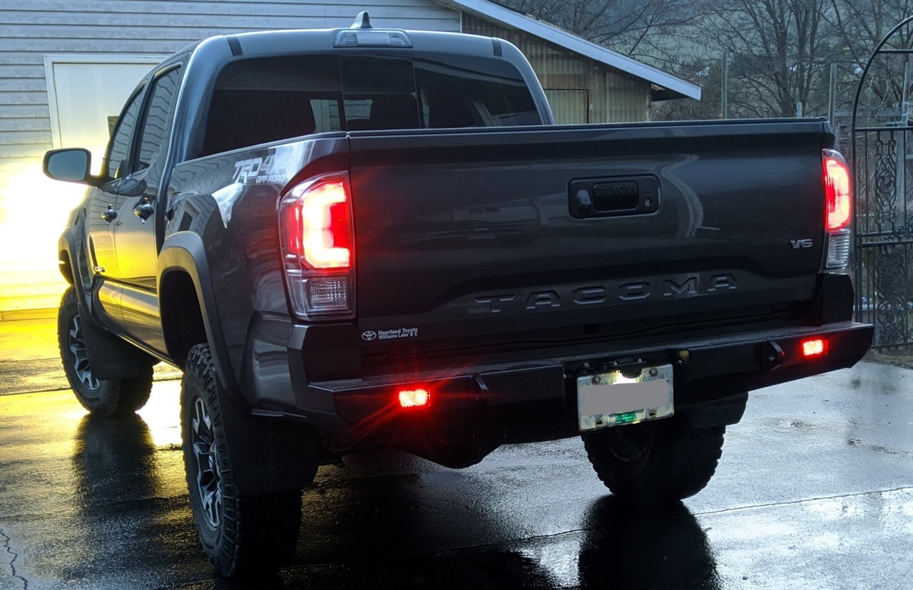

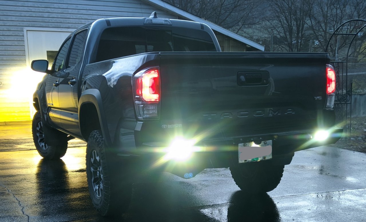

    DD SSc2 Pro with red backlight

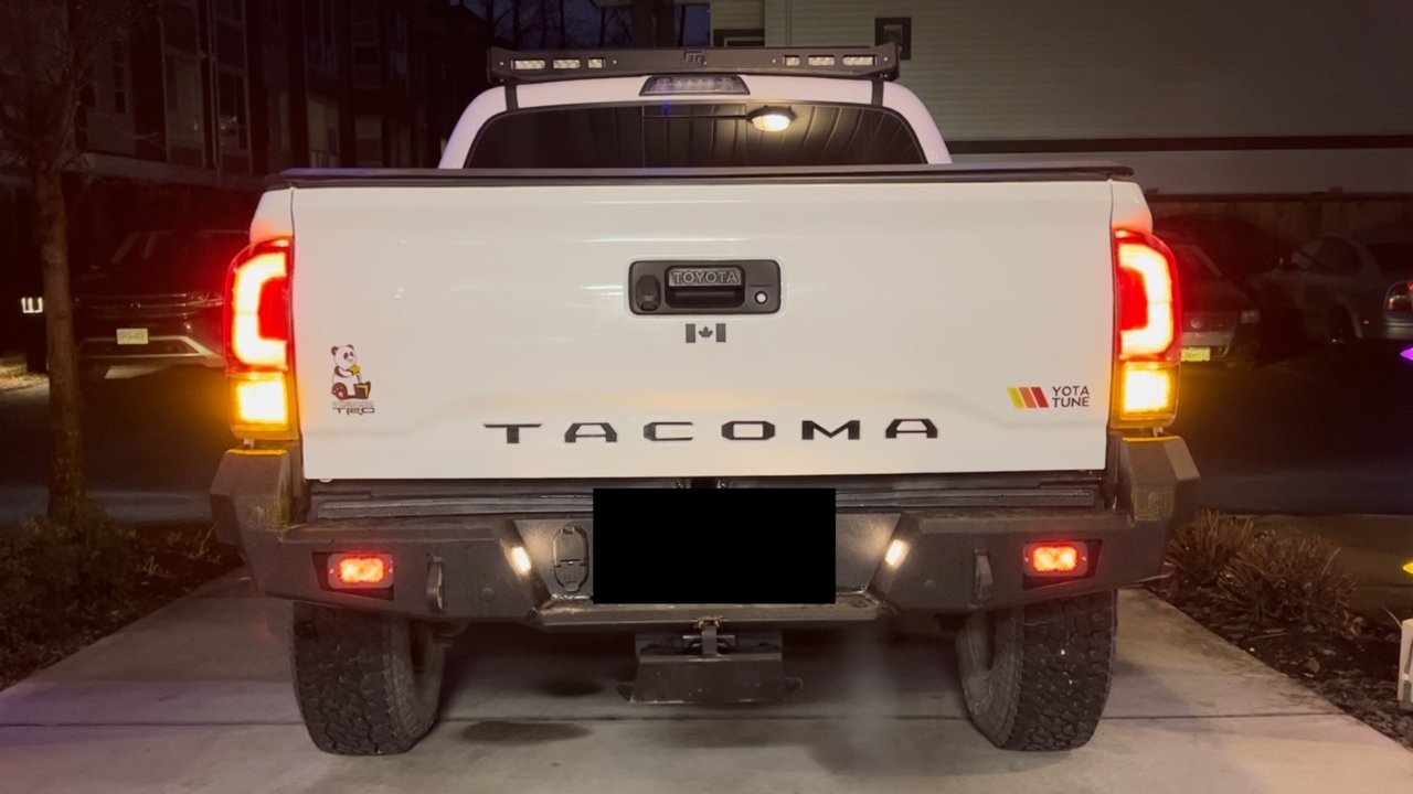

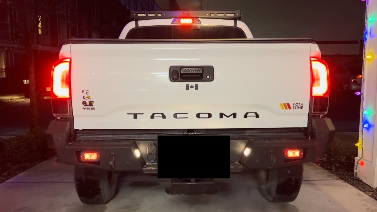

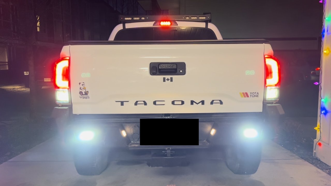

    Looks great! Looks similar to mine.
    Installed some SSC2 Sport Flood with red backlight on my ADI Off-road bumper. I have them wired into my 7-pin trailer harness. Red backlight illuminates when I brake and signal. White light is wired into my reverse

    Very clean sir!

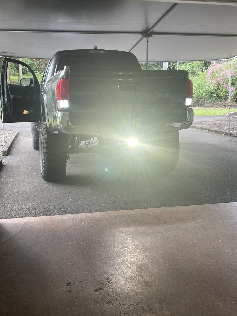

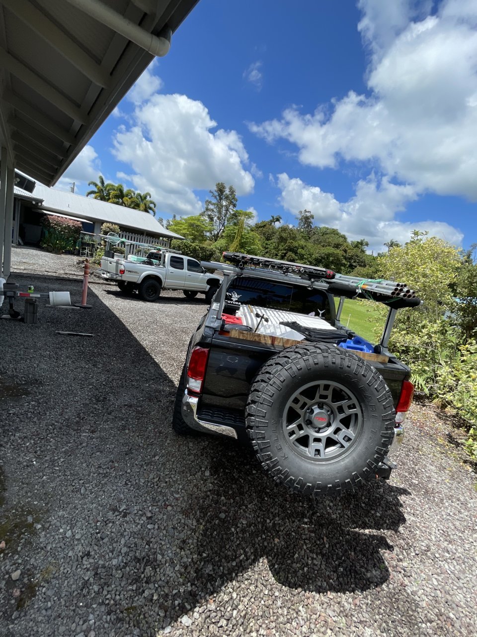

    I got it. Love it
    Have the easy harness too, so when I do tow or use my shackle D ring I just unlock the hitch pin and swap it out. Little pricey but I didn’t want to cut my bumper caps cause it would be completely blocked when I put my Rigd tire carrier on
    Edit: the right side would anyways

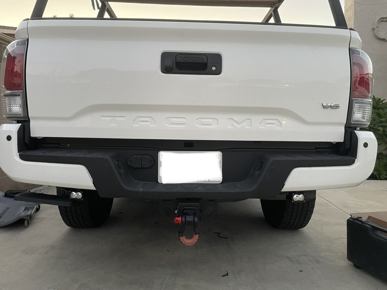

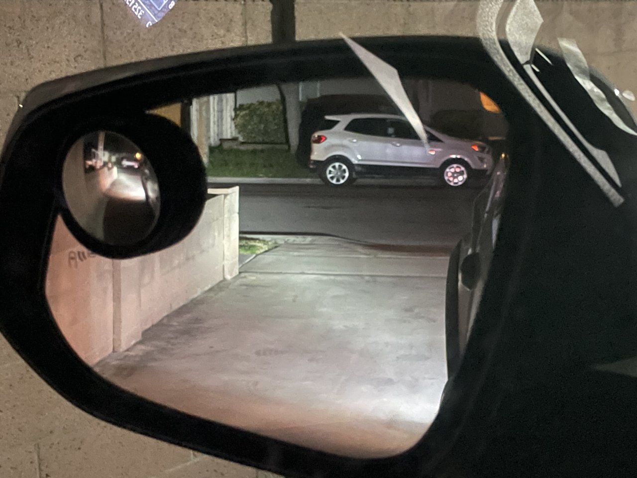

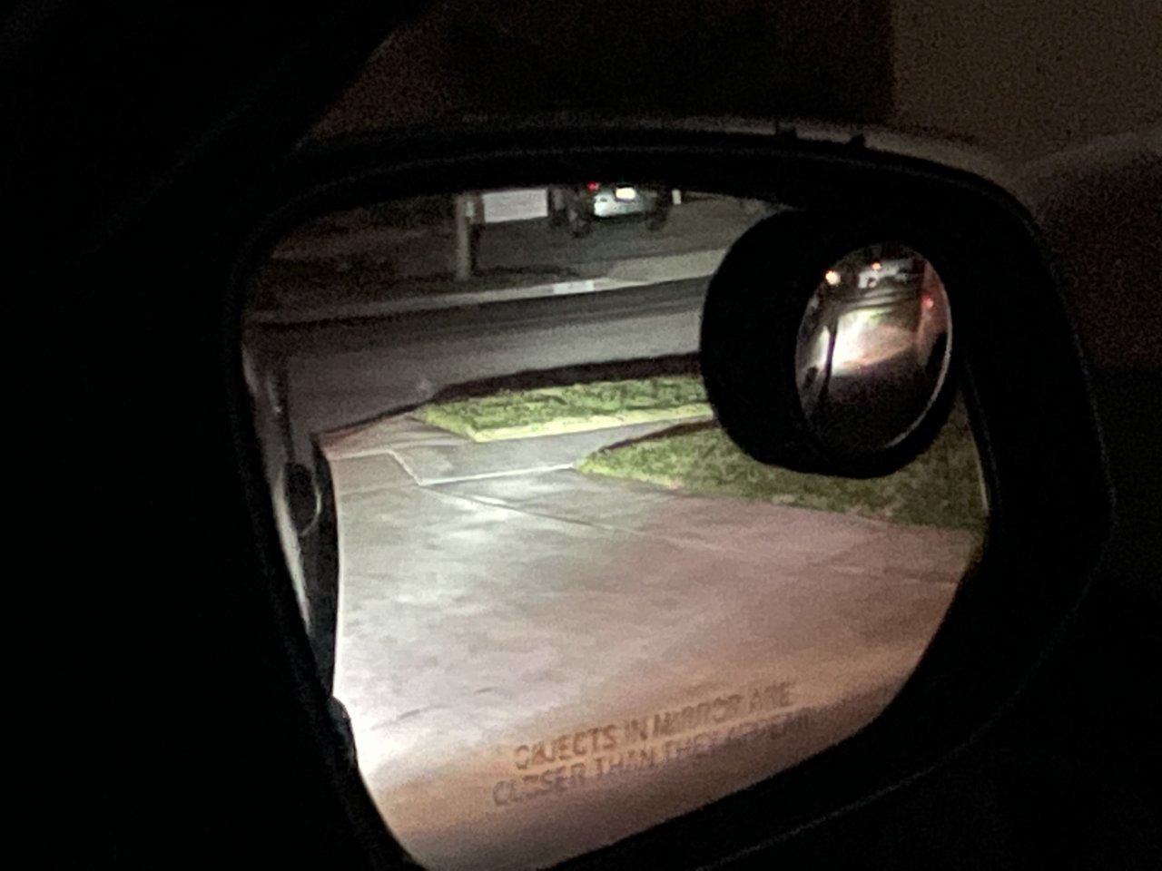

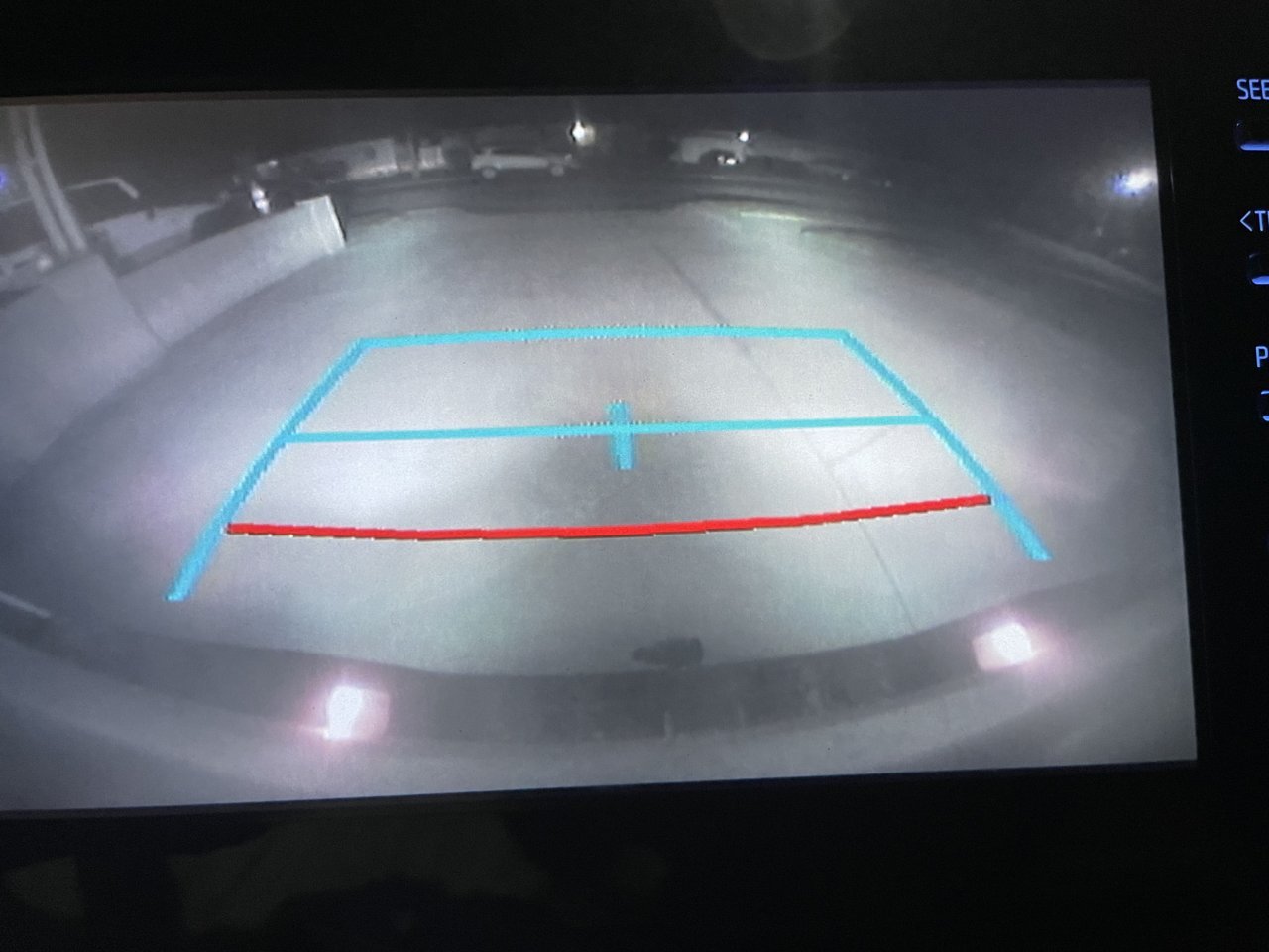

    Great write up & very clean installation from everyone. I choose the easy route by mounting it below the bumper. It’s fast & no cut. Diode dynamic hitch mount is nice but I have most parts around the house including the light. Most people connect to the 7pin connector. I did it differently by running a new line from the battery to the back, relay, switch, & diode (prevent power from going back into the dash & trigger tss). Some might say there’s no need to run new power line, but I have other plans in the future.
    I have a combo beam pattern, spot & flood. Good spread close range and far away.

    Nice. I'm still toying with the idea of embedding some SSC1s in the bumper caps or mounting like you did. And your 2nd picture would be way clearer with something like daveesa's https://fbchs.square.site/product/t...-dir-disable-in-reverse-/2?cs=true&cst=custom

    The flush mount is nice, it does take longer to install. If you have the time, I say go for it.
    I know about the license plate light mod but due to the price, I didn’t want to do it lol. The glare is minimal and it doesn’t bother me.
