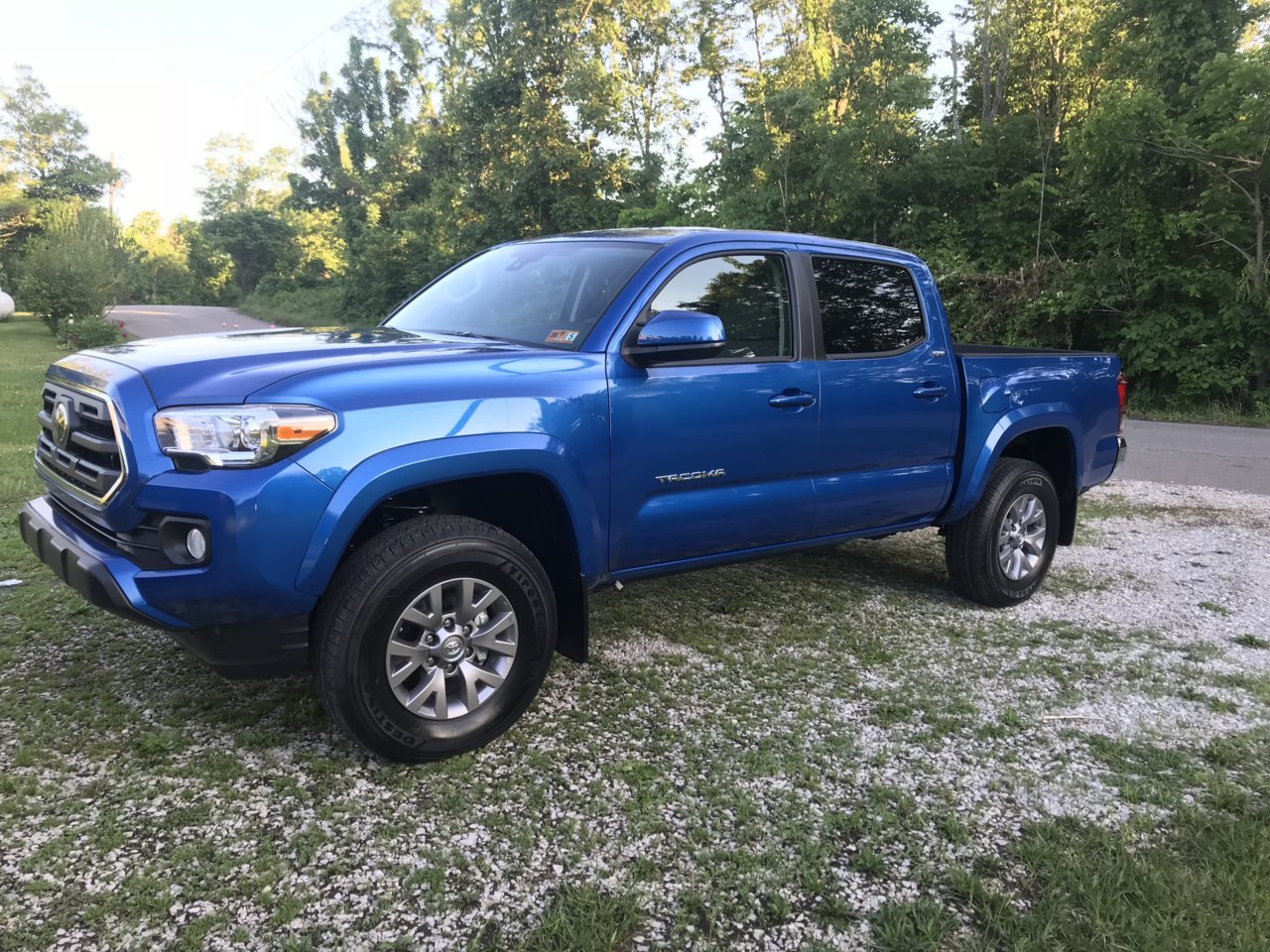

    hey guys just bought a 2018 sr5 and was wanting to know what size lift I would need for moto metal 18x10 on 285’s. And gow bad would 285’s hurt my mpg?? Post some pics if anyond has one like this.

    there is no 4 so.......and lift is not the only thing that determines fitment. Lots of factors involved. I suggest you follow the links in my signature and read....alot.
    oh welcome to the infamous TacomaWorld forums.

    They do not. They likely offer 4” blocks with a cheap cross member lift.
    A full basic suspension would be coils, shocks, and leafs and that will run you $2k-4k.
    For that tire you’ll need 3” lift, good wheel backspacing, minor trimming, and positive caster from your alignment usually requiring new UCA
    Check out the suspension section and the build section

    Good looking truck. Not trying to be an ass or anything, but if you are worried about MPG, don't lift the truck and add heavy tires. Especially if you are looking to go to a 10" wide wheel. If you want some lift and maintain some of your MPG, go with a 255/85R16 or 255/80R17 tires and no lift needed; they are 33" tires and will give you a nice stance. You may have to remove the mud flaps for those tires, but that should be all. Just my $.02

    No lift but going to c load 265 70 17 ko2s dropped my mileage by at least 2mpg to give you an idea.
