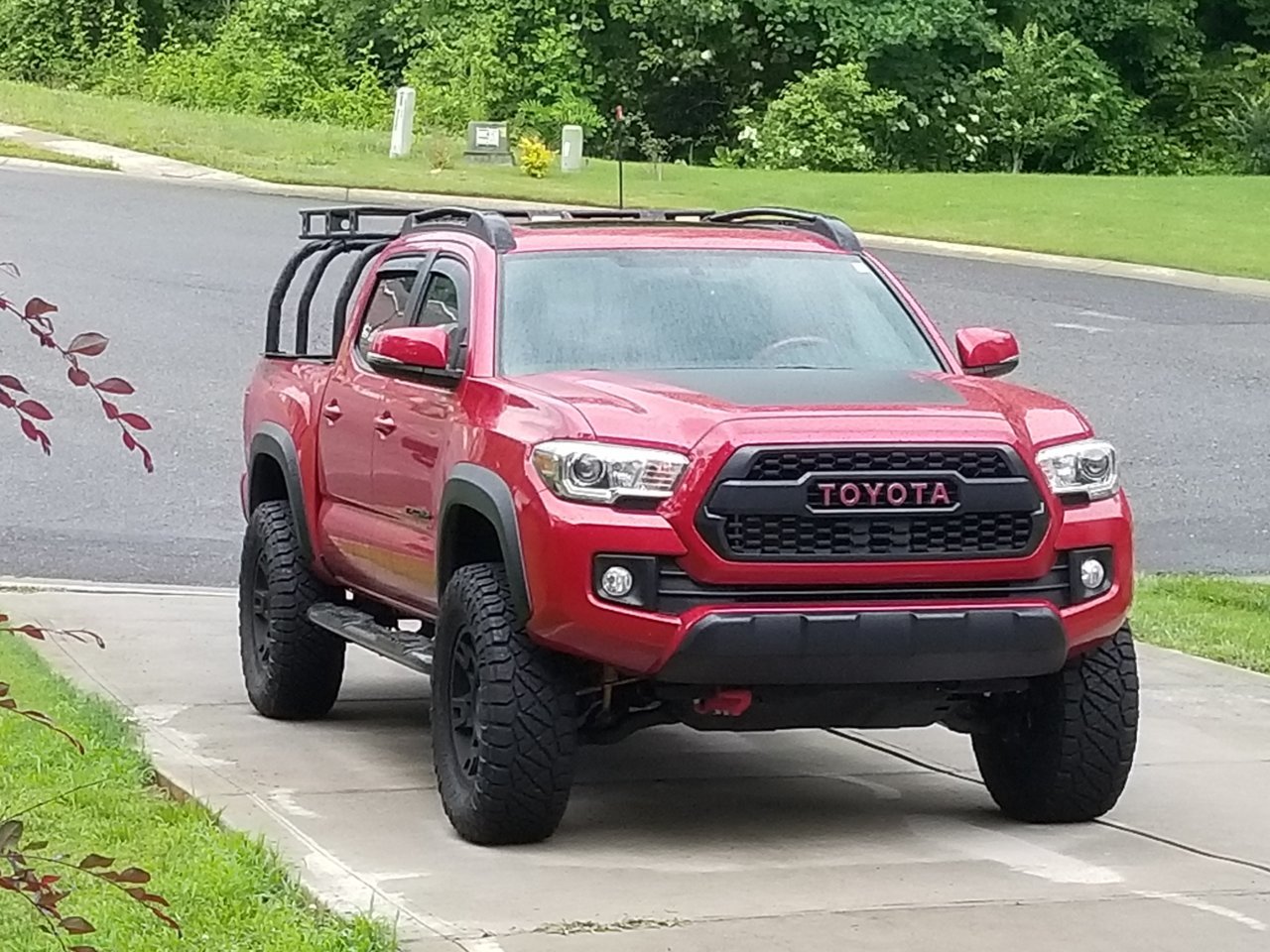

    I have a full OME lift kit. Details here may help you decide.

    I was the same way...it was either lifting it or getting a Tundra (which I was starting to get an itch for). I lifted it so I'm keeping it for a long time.
