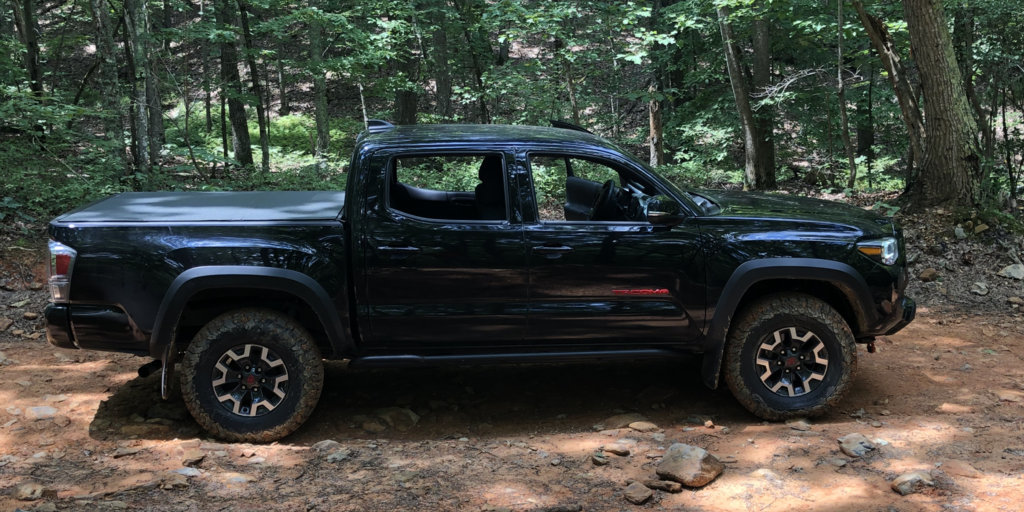

    Really for your very mild off road use you could simply go up a tad to 32s (265/75R16) or if you have 17" wheels (265/70R17). Throw on some 5100 for a better ride and forget the lift. before I lifted my 2022 TRD Off Road all I did was put on 265/75R16 (rock sliders and steel engine skid plate) no lift - completely stock suspension and started wheeling easy and moderate trails way more than what you plan to do and it was fine and no rubbing
    265/75R16 on stock wheels and stock suspension no lift

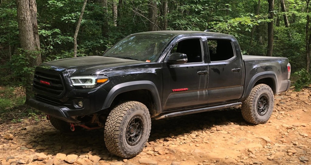

    Off set is key though 0 to +10 with 0 I think being the sweet spot IMHO. definitely for your use 5100 with AAL. But why the 33s ? Some folks run 33s with out a Cab Mount Chop (CMC) and get no rubbing for others that does not work. I think it depends on a couple of factors - definitely your wheel off set, how hard you wheel off road and maybe I guess just how often and hard you go lock to lock. I run 33s +10 offset (285/75R16) with a 2" lift. I wheel pretty hard sometimes so I didn't want to deal with rubbing at all ever so did a a CMC and viper cut which to some was over kill - I guess I have to agree but it works for me.
    285/75R16 +10 off set 2" lift 5100 and RXT leaf pack - CBC and viper cut - over kill? probably
